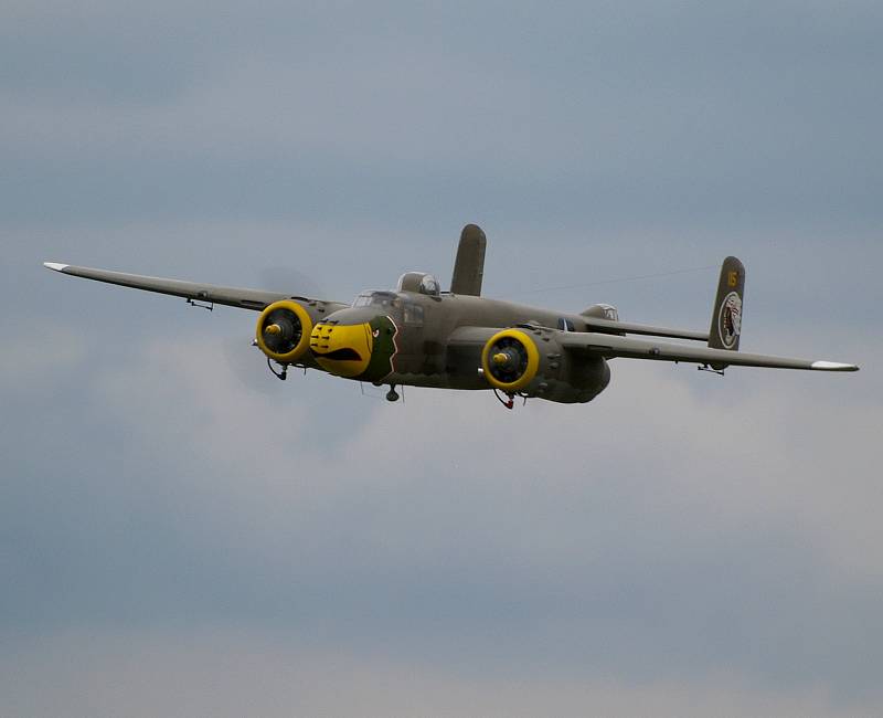

Yeah, I'm lucky to have two friends: Lloyd and Starla Swanson, who are professional-level photographers with a special passion for RC planes.
They have shot Top Gun and other big meets, but always come to my little Multi-Fly every September here in Iowa. They have a special talent for catching planes in action and making them look even better than they do in real life.
Starla's shot of my B-25 dropping bombs got me the "Snapshot" spread in last May's Fly RC, and it wasn't any particular talent on my part that made the picture exceptional.
I sincerely believe a lot of the multi-pilots actually attend just so they can get the free CD of their (and others') planes' pictures.
mt
More of their work:

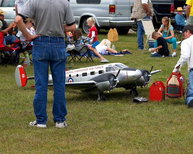

Another pretty plane from last year's gathering: (inverted G-26's)
