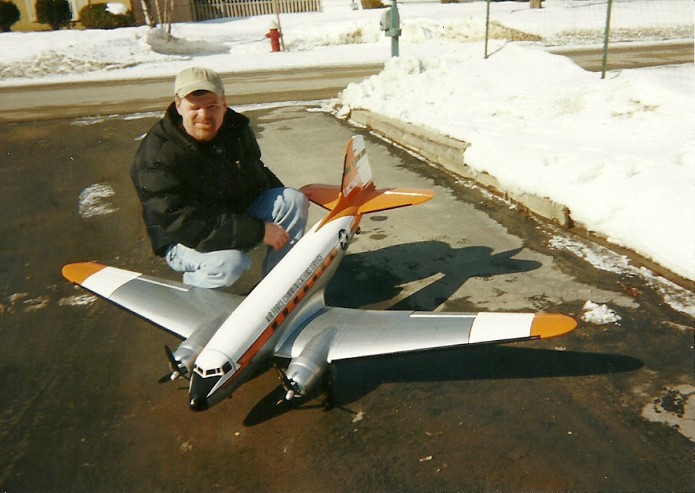

I ran mine with two Tower hobbies .40s too fast for scale. Very pretty in the air tho....
