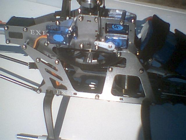

looks like fun ya for about the first ten min. put down the toys and get one of these

Old 03-24-2009 | 04:11 PM
skitt's Avatar
Joined: May 2008
Posts: 197
From: Denver, CO
Default RE: Hovercraft from Kohls:
I know it's a helicopter, but do not know what kind? Got some more info?
