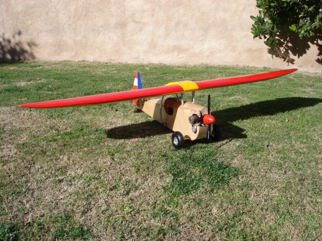

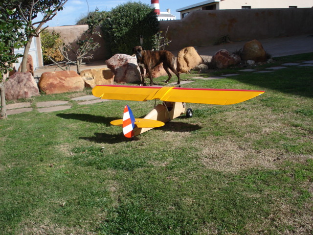

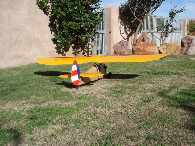

I've built something similar - see pics. The whole wing hinged together (variable incidence from +3 to about -3 deg), it still had ailerons and an all flying tailplane.
Was capable of crazy manouvres with both the main wing and "all flying" tailplane pivoting, but very difficult to fly and eventually crashed it. Was interesting to built, fly and crash, but not something I'll do again. I had fast responses with above setup but it made it difficult to fly - think of this one: feed in positive wing incidendence while giving down stick (to dive), but the plane goes up like a helicopter instead of down, hadthe main wing stayed neutral - and vice versa..... Leaving the main wing in neutral incidence and the plane flies normally.

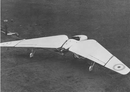

Thereis a guy who built a JART slope soarer with independant pivoting wings http://sa-jarts.blogspot.com/search/label/Vicand best to contact him. These JART slopersare fast as hell, mine with normal ailerons clocked 170 km/hr. I doubt if you would be able to do superfast rolls with separate pivoting wings as it takes a lot of energy and servo power to move a big wing - you would have to use a fulcrum system which adds weight and uses energy. There are planes where the last end of the wing and wingtips rotate as you describe (circa 1930's) See attached black and white pic of a Westland-Hill Pterodactyl Mk. IA. I have only this pic, no info on it.Probably had adrenalineproducing wingtip stalls......Interesting concept though.......
