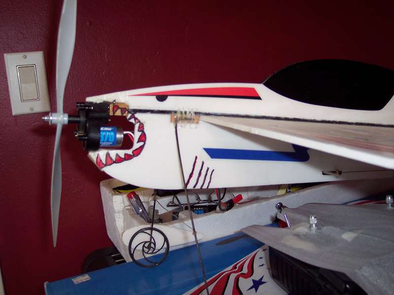

Fly backwards or decelerate during a dive. EVP unit makes 3D planes 4D planes. Includes necessary parts for assembling a 9-3/4" diameter electric variable and reverse pitch propeller. Adapts to airplanes capable of flying with our AXI 2208/34 motor. The unit is designed for use with Model Motors EVP0834 Hollow Shaft AXI 2208/34 Outrunner motor and either a Jeti 12 amp controller or the Jeti 15 amp Helicopter controller with governor mode. Detailed instructions for assembly and set up included.
dont forget about the extra channel you need to operate the *******

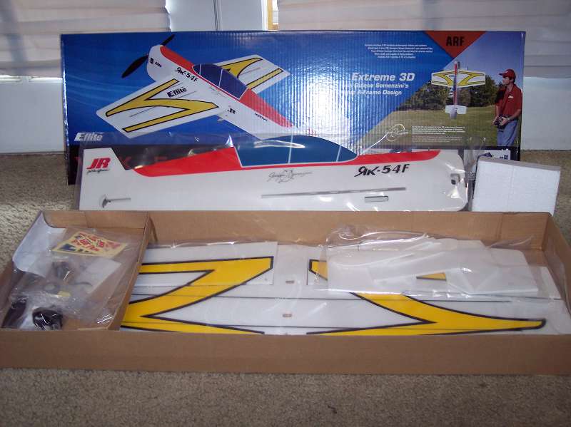

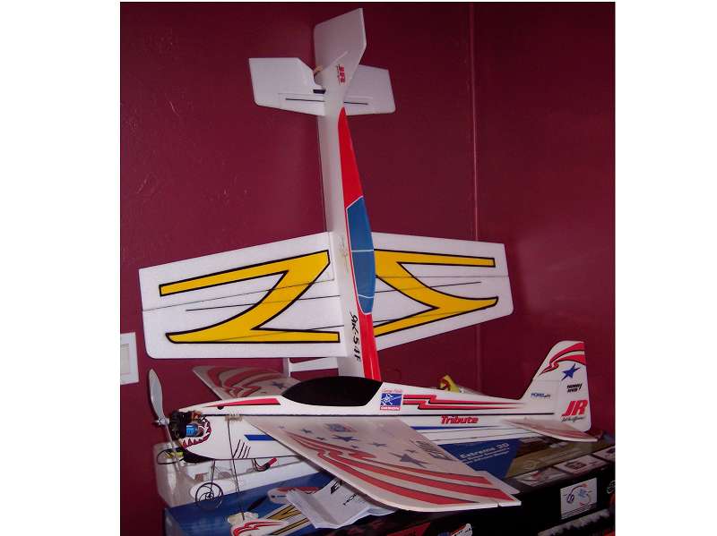

never been clocked but i cracked my wing after pulling out of a fast nose dive
very happy with the brushless power may never go back to nitro (to lean to rich, exhaust falling off, carb clogged, glow bad ,compression gone,need more fuel.. i hate nitro what a waste of money.but thats just my experance with it .....what kind of plane are you using?

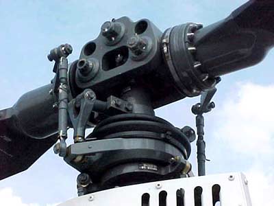

i bet you could invent VPP for gas planes the military uses it on the apache helicopter
its called a swash plate assembly
[link=http://science.howstuffworks.com/helicopter5.htm]swash plate link[/link]

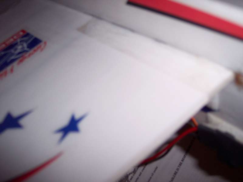

crap[X(] "i am building her as light as possible capitan"
using hs-55 servos( 3 )and a outrunner the 370 1080kv outrunner (hollow shaft) is for indoor lightweight w/10x4.7 prop, 900mah 3-cell
and the 400 outrunner 920kv is the heavier setup with the 11x4.7 prop,
1200mah 3-cell
can i use the lightweight (1st setup listed above)for VPP or do i need to get the yak 55?

if i was you i would order the lightest airplane possable.
id keep the queque yak for smoth 3d and get a yak 55 from hobby lobby.
i know billy h e l l (jimey t gram) from hobby lobby personialy and he says 8-9oz is the best but can handle up to 10oz and still not over stress the blades.
