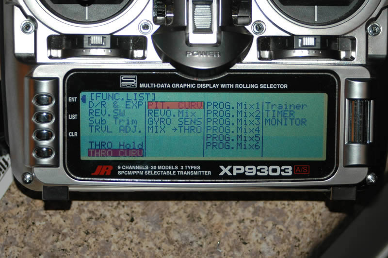

I started off by selecting a Model in my JR 9303 and choosing the Heli mode. This enabled the mixing charts you see above. In the JR Radio, they are Pitch Curve and Throttle Curve. All other mixes are turned off. I setup my mixes as the above chart references for Gov Mode. Everything seemed to be working correctly, but at the extremes of throttle on both normal and Idle, the system was getting hot and I had nearly no thrust. I began scratching my head as all of my mixes were set up exactly as the above charts depicted. I took my Wattmeter and took readings. I was pulling 23 amps at full throttle range. Something was definately wrong.

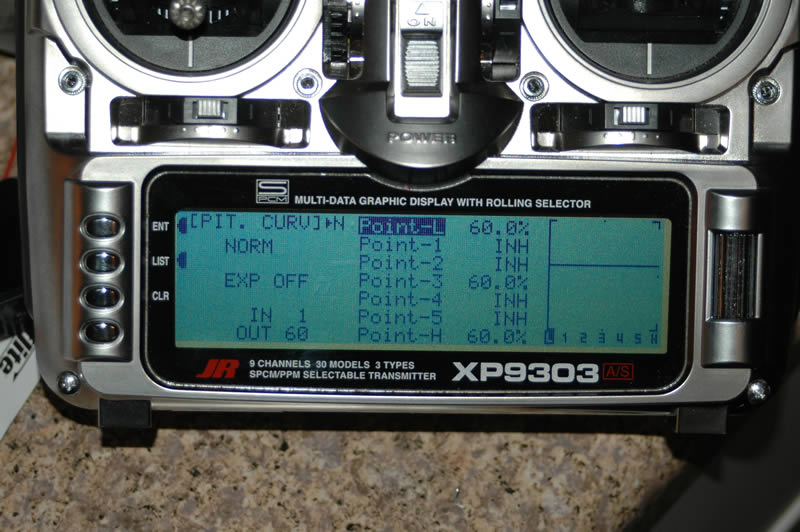

Throttle Pitch Norm as you can see spans the full range from 0% to 100%. This is a linear throttle that is the same as a Fixed Pitch setup. The Pitch Curve Norm is set at 60% and is a flat line. This gives about 30% total prop pitch and is constant no matter where the throttle is.

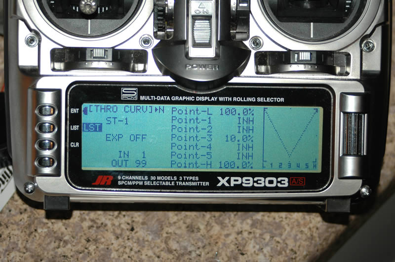

Throttle Curve Flight Mode 1 gives a different view however. It looks like a large V. As the stick is at the bottom, it is turning the motor at 100% throttle. As the stick moves toward center, the throttle is cut to 10% and as it moves towards the top end, it goes back to 100% again. The motor never stops turning although it is changing RPM from center stick to either full up or full down.

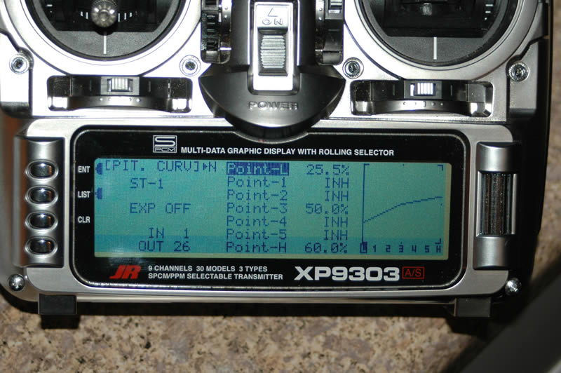

Pitch Curve FM 1 shows that the pitch has been toned down a bit from the chart above. The max pitch on positive throttle is the same as our Norm setting which is 60%. On negative throttle I have about 25.5% to keep the blades from over pitching. Both ends produce about 12 amps and 113 watts.
