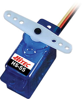

HI all.....I have been fooling around with my walkera 22d for a few weeks now and I have to say.....the helicopter mechanics are great but like eveyone else has said.... THE ELECTRONICS SUCK.... NOTHING BUT GLITCHES......AT FULL POWER THE SERVOS SORT OF TWITCH AND ITS ALMOST IMPOSSIBLE TO CONTROL. Any ideas why it is doing this? Also I have a Hitec Flash 4 computer radio that is new in the box.....is the any servo, reciever, gyro units that I could use on the walkera to make it better. I would like to use the new radio as opposed to buying a new one. PLEASE HELP DAN

Jittering in the servos is common with Walkera and usually a sign they are about to fail. Replacing them with the popular Hitec HS-55 and an HS-50(for it's high speed) on the tail usually solves this problem.

you'll have to mod the plastic a bit around the screwholes on the servo to make it tighten down propperly however.

can the hitecs be used instead of the stock servos while using stock electronics? I thought I read somewhere
stock BEC has 6 volts?
