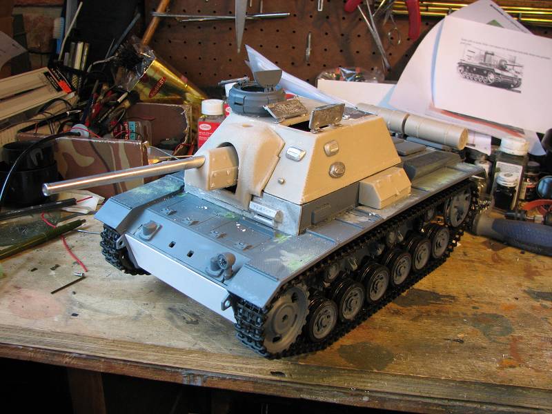

Got the conversion kit in from Peter at Modellino and was very happy with the kit. As usual, a bit of filing and cleaning up on the resin

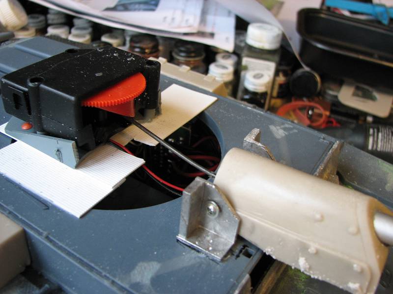

to get things seated right. A major job was removing everything molded or glued to the exterrior that the Russians didn't use.The biggest problem though, was getting the gun to position so that elevation was not affected by the dog house. I took out everything in the turret except the elevating mechanism and got that lined up and working nice. There were a couple hatch door hinges missing in the kit, but the top doors are going to be open and the missing hinges won't be that evident. The rear doors, I will make a couple . I took some photos as I was building and these are of the model about 75% done and checked out to see that everything was still working after I did some elimination and kept only the wires to the elevating mech. I have 3 Russian tankers to put together and place in the vehicle. As far as historic accuracy, there were a number of these converted from captured Pz III's. Some had the flat top like the SU-85 or 100, some had a TC copula from the Pz III and some had top doors configured different....late wartime and they used and field retrofitted as they could, so you are pretty much on your own how you want to modify it. I chose to use the Pz III copula, as I had a couple laying around and the side piece for its use comes with the kit.

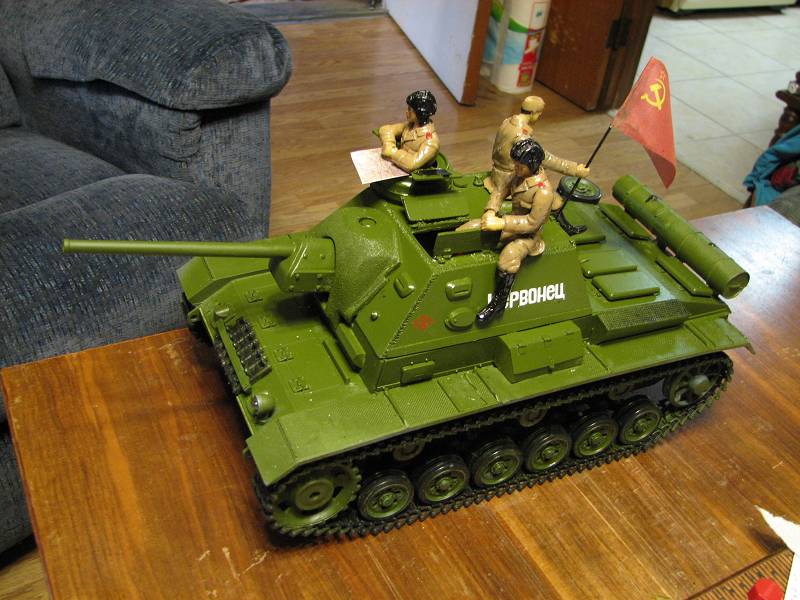

SU-76i completed except for 3 man crew and decals, which I have yet to find. The kit was pretty nice. I have to get rid of the HL machine gun sound as this vehicle doesn't have one. Anyone have a source for Russian decals. PM me. thanks. Wanted tp add more pics, but I keep getting "file too large" message.[:'(]

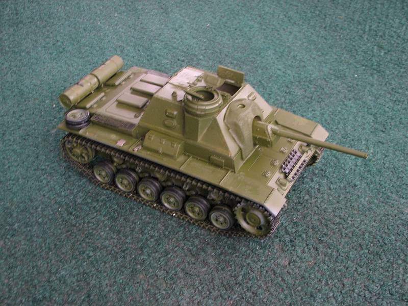

I checked a 1;35 scale T-34 kit I have and it had just what I needed. The kit is nice puts a twist on the German Pz III use in the war.
A couple more doses of dull coat on the figures and some field damage and it'll look good.

loaded the wrong pic....this is the completed model.
