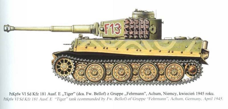

Like F13, a true bitsa

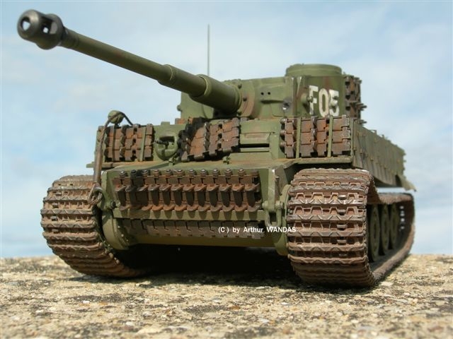

Darren Thompson's model of Major Schulze's F05 in 'Modelling the Tiger 1', Osprey Publishing 2007 reproduces the vehcile with zimmerit, although he claims to have used photographs of F01 for inspiration

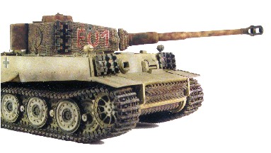

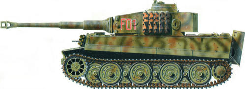

Here are some photos of different models I have found and some templates...
As you can see there are a lot of ways of interpreting Kompanie Fehrmann!
