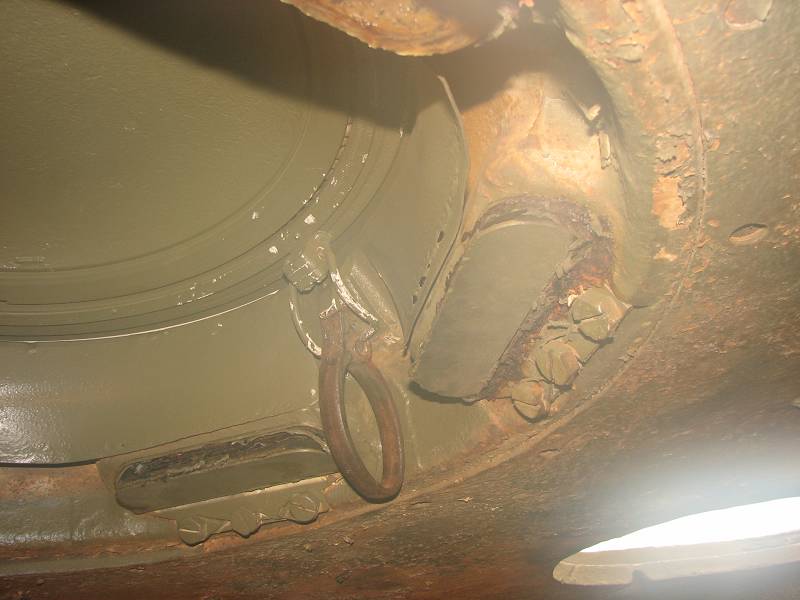

For you guys that want to put a little extra authenticity on your Pershing, here's the latch for the TC'c hatch. Just had to take one out one of our Pershings that had the hatch tack welded and install it on one with an unsecured hatch. Also a photo of the breech ring...man, don't ever let a tank get this bad.[:'(] I'm having a helluva job getting these cleaned up. [:@]

The TC hatch has a built up block on the outside, right side of the hinge that prevents the hatch from opening any further. It's molded on to HL and Tamiya hatches and is the same hatch on the E8 Sherman. It locks open and there is a small spring loaded pull ring at the bottom inside of the hatch to release the latch to close it. Monday, I'll make a point to get a photo. I have to clean up the inside of one of our Pershings Monday and reasemble what I took apart Friday.
