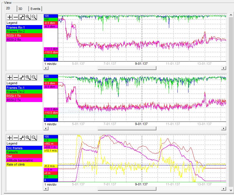

Hello again!
Here you can see a log file where I had several breaks in the bluetooth link. I made a number of motor restarts during this flight. Otherwise, no problems as also confirmed by the log file.
ps.
Please note, must point out that the different accessories from Weatronic; receiver 10 micro gyro1, Link Vario and GPS-pro worked all the time, it was just the bluetooth/telemetry connection that had problems.
/Ville
