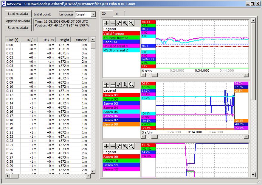

I have two 10-20R rx´s with the latest firmware installed. The first one (with GPS) stores the nav-files with both correct date and some files dated 31.dec.2097.
I have just tested the other rx (Gyro only), and this one has stored 3 files in a row with 2097 date. Any Idea what causes this?
The GPS rx also store some very odd data in the time(s) column when watching nav files in Nav-view2.1.
Typically the first 30 seconds are displayed each second, and from then on there are stored a value on the format xxxxxx:xx (see attached image). It seems that this numbering starts as soon as the GPS is active.
I am using a Windows 7 PC to access these files..

The data is only relevant when you have the GPS seeing the satellites and recording data. At any other time it usually defaults to 1970 as you can see at the top of your picture. Other than that you can ignore the dates, as there is no clock in the receiver, which would need a battery and everything sustaining it as well. It would just make things heavier etc.

If you open the file in Nav-View, you have the option to ignore the data that does not have GPS data, or you can go into the file and delete the non-GPS-data, you will see the picture that I have attached. Then you get a continuous count from 0.00. In the box above the data you get the timestamp when it begins and the exact coordinates that you could copy into Google Maps and see where you were when the GPS started to response. That is the knowledge that I have from the GPS-system.

Sorry for the delay, Attached are 2 screen shots that show everything is ok. I loaded the file, ignoring the data without GPS and erased the first line in the data(Just go on the first line in the data and hit delete)
The only thing that I found is that either servo 1 or 13 is running up against a stop or so and creating a bigger current at the maximum (maybe flaps). You might want to check into that. Else let me know if time and location are correct.
Regards,
Gerhard

Thank you very much for your help and patience.
It all worked out fine after your last tips..
Really appreciate it..
Attaching a nice thermal flight log image
