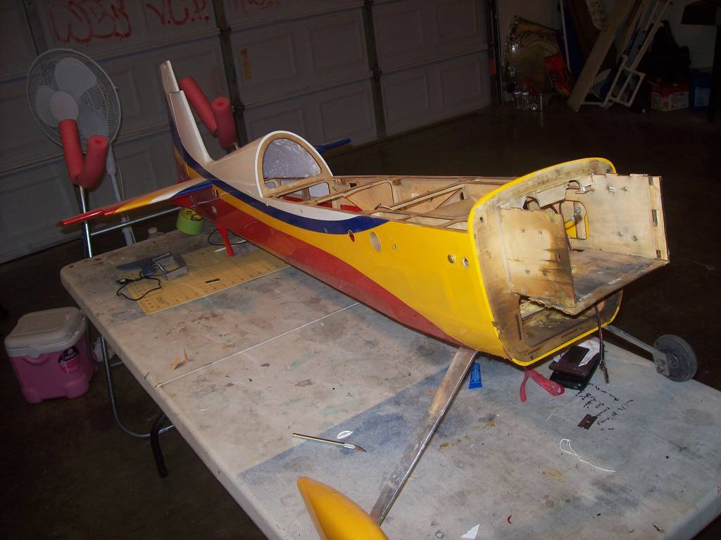

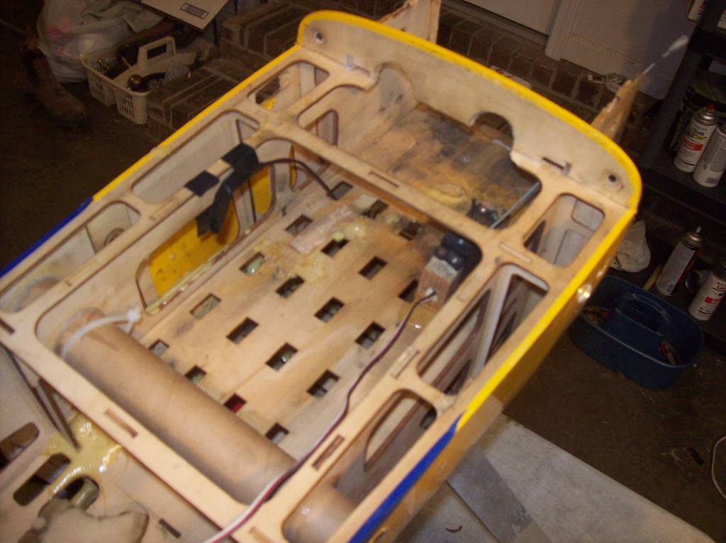

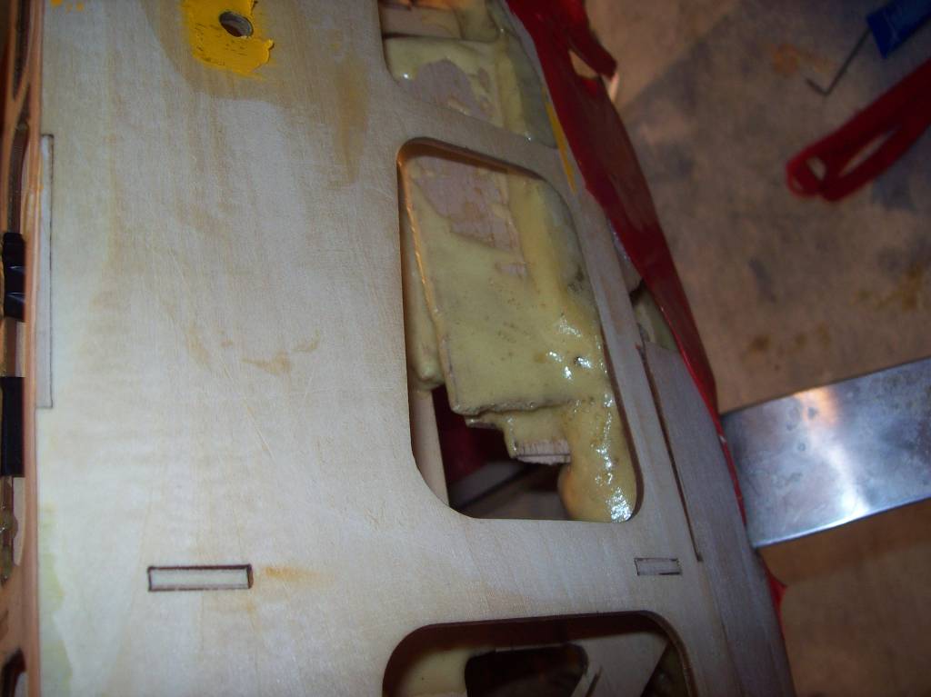

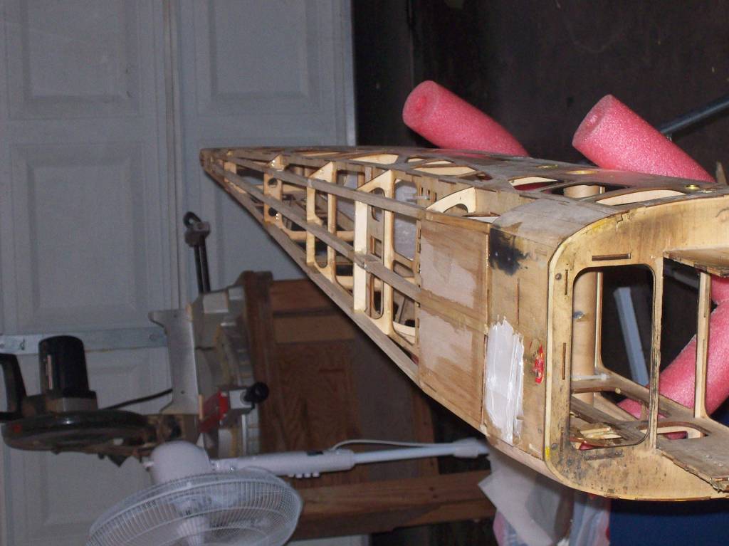

Pics take alook of how previous owner did a repair with expand a foam oh boy that was a pain in my butt to get all out

tell me about it he sure did a number on that repair didnt he

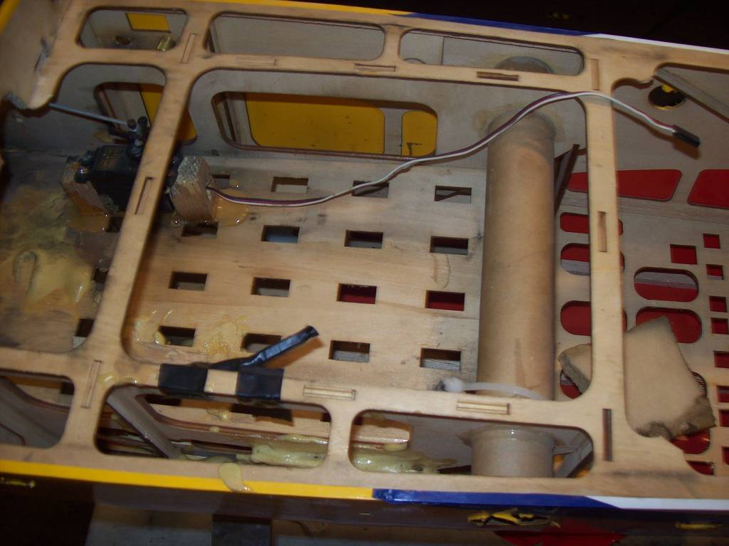

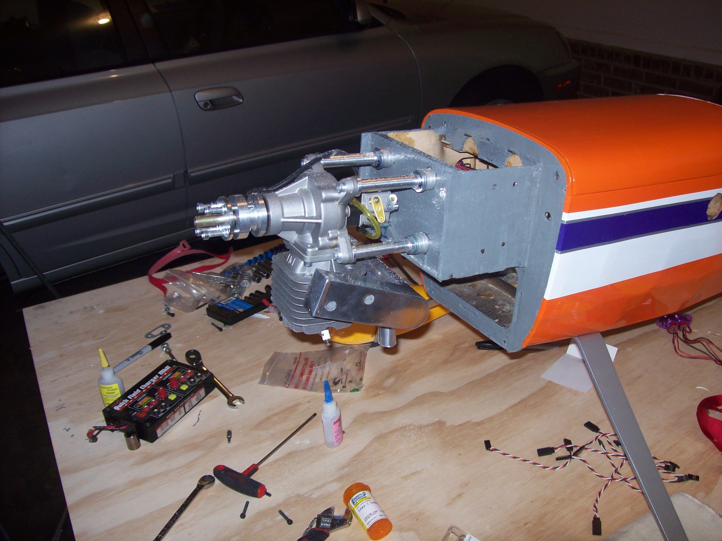

Well tonight I took the balsa stingers out and replaced them with some harder wood for better strenght I cant wait to get this thing in the air will be a while but will be a great plane it will be my first true 50cc aircraft. Hey tom I got to get a canopy and a Cowling from you also the cowling is really Chopped up on this thing and also do you have a Drill Template that will help in finding the Trust line when i put the front of the motor box back in.....
here are some more pics

I have canopies and cowlings.
You find the thrust line by aligning the engine so it is centered in the cowl, since the cowl is pre-mounted and can not be moved.

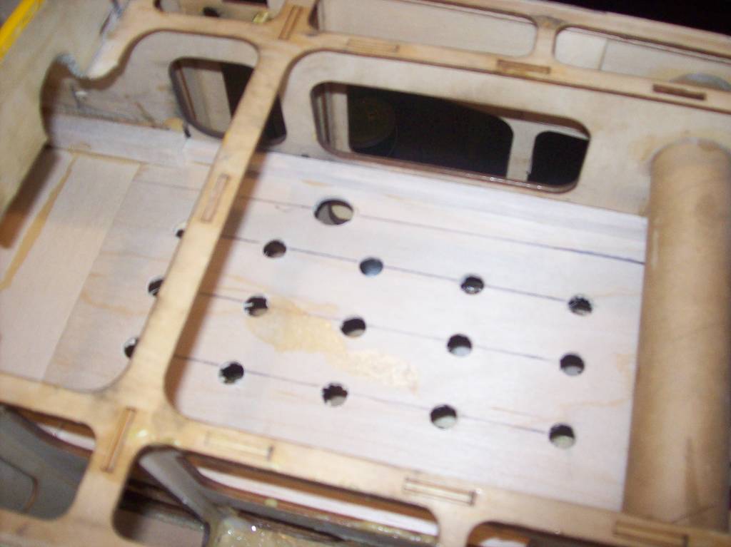

Well I did some more work on the Plane tonight I got the Tank Platform rebuilt and started on the motor box...

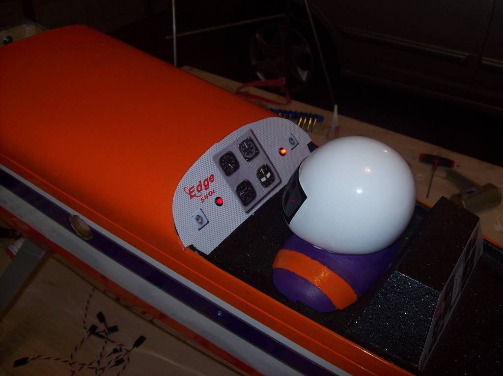

well here is some more pics I got my pilot and gages in from Tom today and got the pilot Painted and then got the Dash Gagues installed with the Led Lights and Also I got a New Style Pitts Muffler from Tom well here are the pics

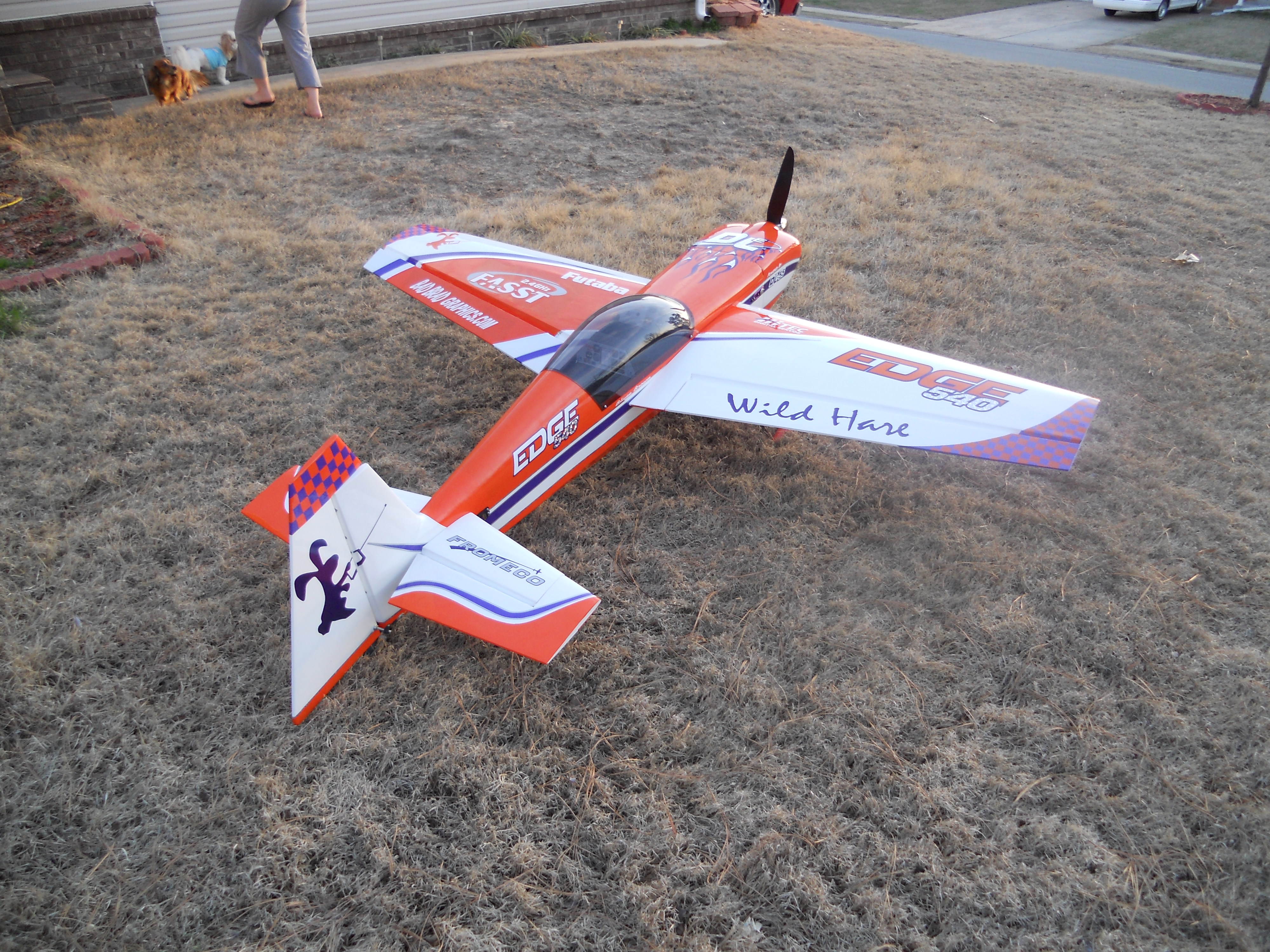

From: Paragould, AR
Default RE: Edge 540 v2 rebuild

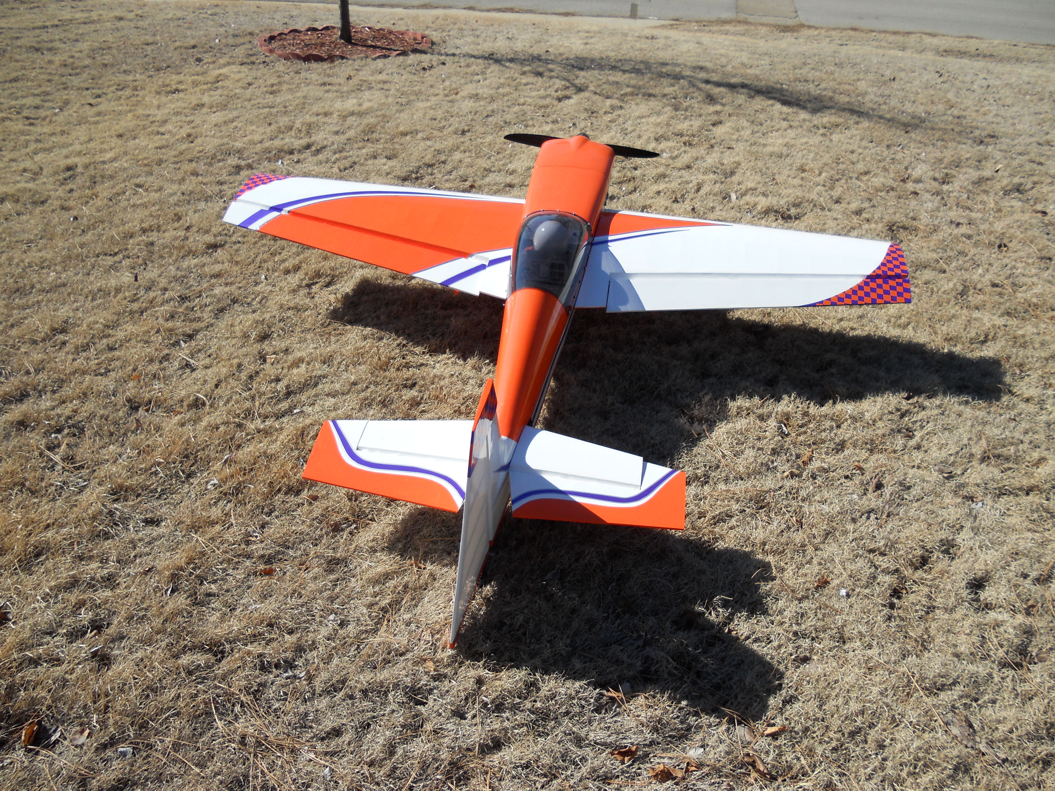

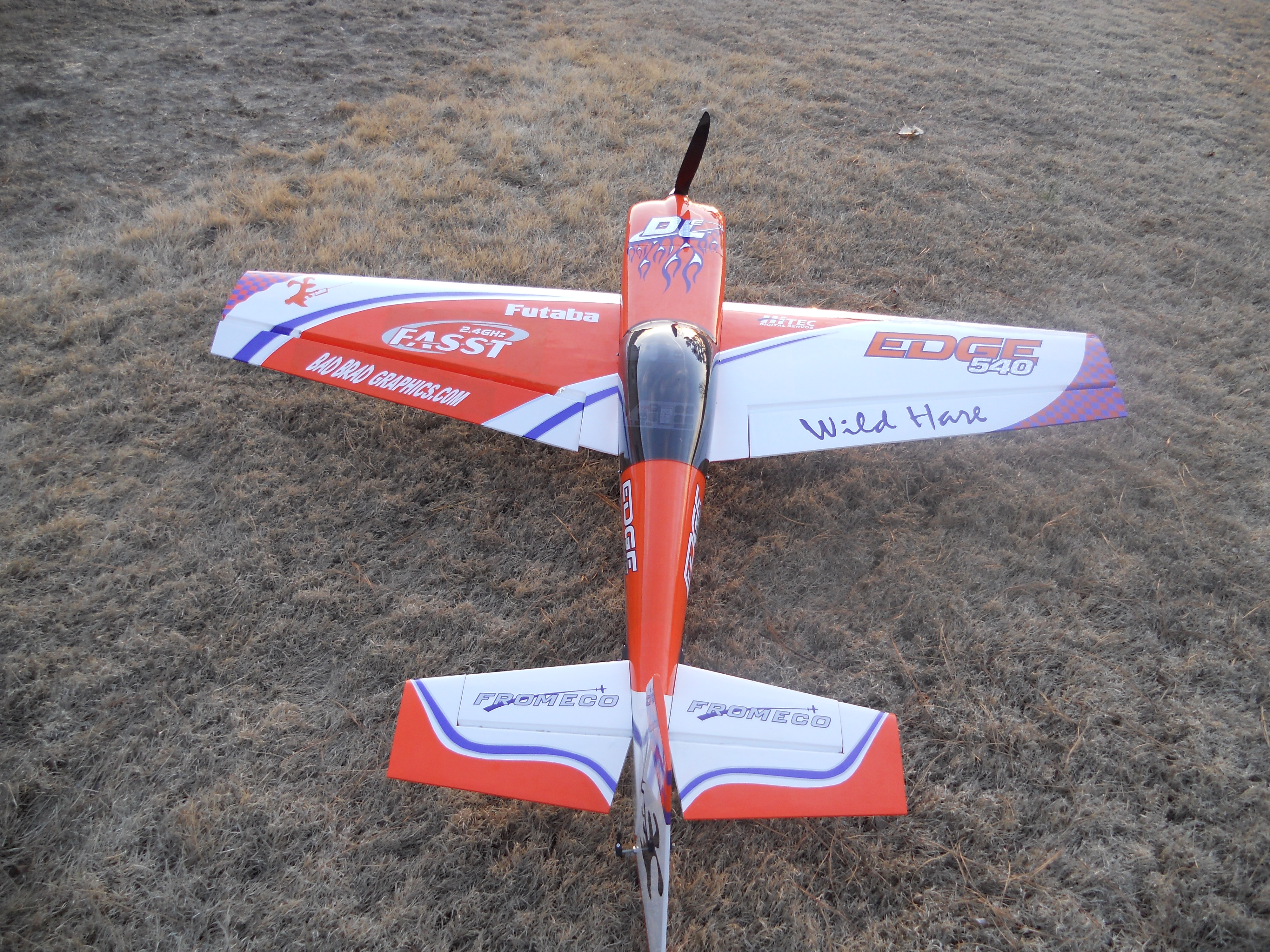

here is the finshed product

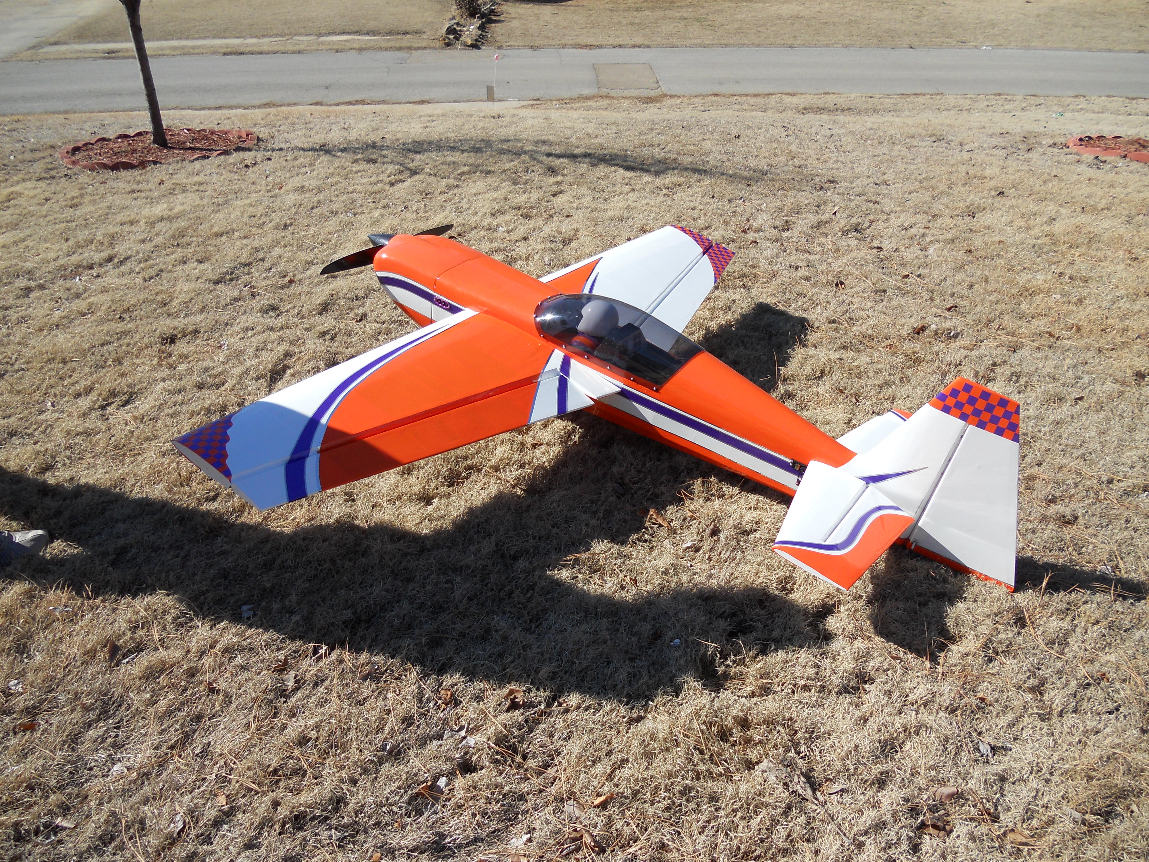

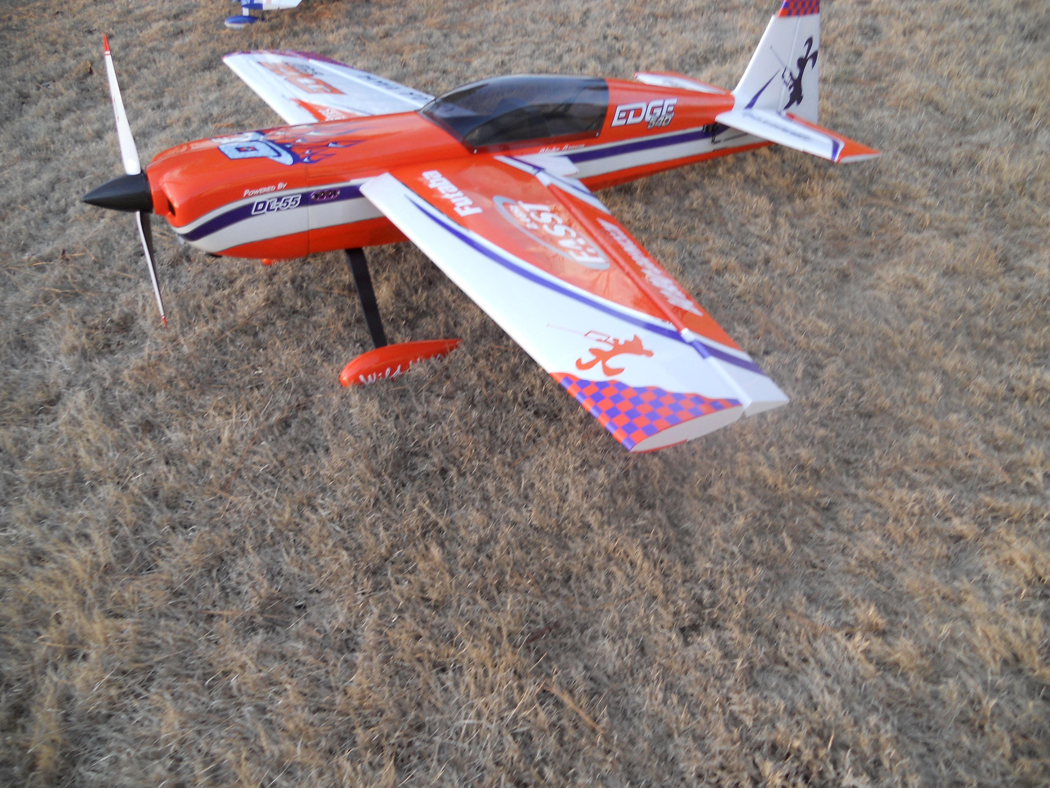

Well I have the Edge 540 Tdone with Graphics and all
