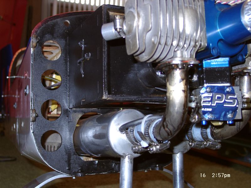

As far as I know, tim_indy is the only one who has done it, maybe he will help.
You should not need baffling or insulation around the mufflers if you open up the bottom of the fuse so cooling air can exit, that's the way I have mne with no problms so far.
I finally got a photo of the bottom of my plane, it is below.
Tom Fawcet

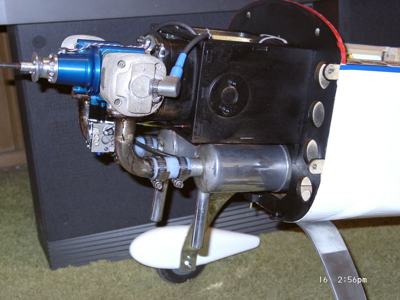

Old 02-08-2004 | 12:09 PM
rmh's Avatar
rmh
Posts: 12,630
From: , UT
Default RE: Balance Point for Extra 330LX
Here is a simple setup -it keeps cool.
Also increased these cans from 60 mm dia to 70 mm dia types
- worked fine -
These are not tuned cans - they are high flow mufflers - very quiet.

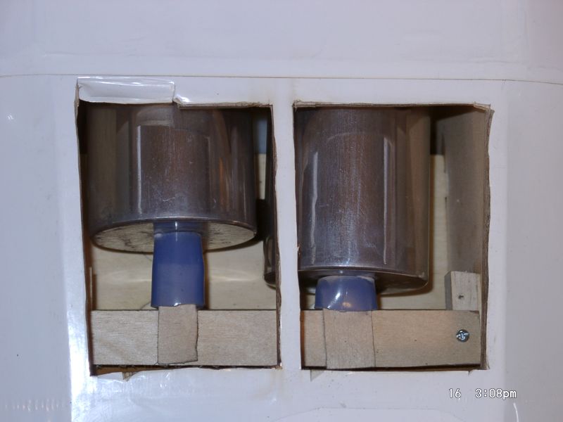

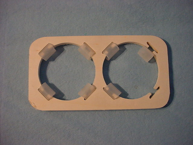

Old 02-15-2004 | 10:32 PM
rctom's Avatar
Joined: May 2002
Posts: 6,189
From: Flower Mound (near Dallas), TX
ORIGINAL: Geistware
Where can I purchase canister mufflers?
My picture shows my plane with Pefa canisters which fit well. You can get them from Wild Hare or from Cactus Aviation or Aircraft International.
I've included some photos of one installation with these mufflers. I included a photo of themount that we sell with our header kit.
Tom Fawcett
ID:	101466   Click image for larger version
ID:	101467   Click image for larger version
ID:	101468   Click image for larger version

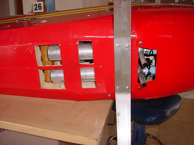

Old 02-16-2004 | 03:35 PM
Posts: 611
From: Indianapolis, IN
Here are some pics of my install. While Tom is using the Pefa "L", there is room here for the larger "LL" so that's what I'm using. A major advantage in using the BME 110X engine is that the engine with these HUGE cans still weighs 3 ounces LESS than a DA with stock mufflers! ZERO weight penalty in using cannisters.
I originally was concerned about having to put in a tunnel but Tom was definitely correct is suggesting that with adequate airflow, through the fuse and out the large exit, heat is NOT a problem at all. I've got a 2 ounce washer bolted to the side of the motor box, that's all I needed to balance it at the CG I wanted.
Tom's cannister holders ARE neat, though, aren't they. I did find it best to have a way to limit the pipe's backward travel. To give an idea of scale, the rearmost pipe comes within 1/2" of the wing tube.
I'm definitely happy, combo spins an Airwild NX 28x10 prop with ease (my favorite prop so far for thrust and quiet), I've got power AND quiet!
ID:	101736   Click image for larger version
ID:	101737   Click image for larger version
ID:	101738   Click image for larger version

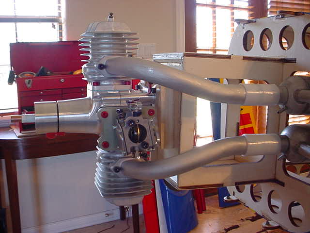

Old 02-16-2004 | 03:37 PM
Posts: 611
Couple more pics of my setup.
ID:	101740   Click image for larger version
Old 02-16-2004 | 08:50 PM
My Feedback: (23)
Posts: 895
From: frisco, TX
Thanks for the pics Indy. Those cans are very long. Were you able to get the correct header length necessary for them?
Tom:
The MTW headers have 3 drop lengths, what is the drop on what you are using? What is the diameter of those headers?
Old 02-16-2004 | 09:24 PM
Posts: 611
Craig, I'm just taking advantage of work that Kris Welters did sorting out his 110X. One of his "lessons" is at: http://www.rcuniverse.com/forum/m_14...tm.htm#1488452 . I'm using the same large 75cc cannisters he uses with his 110X in his 40% Extra.
More info is here: http://www.rcuniverse.com/forum/m_14...tm.htm#1479865 . In one post here, Dick Hanson said in this thread: "A big can on a very short header just makes for a nice muffler - non restrictive - a couple of hundred over an in cowl setup is reasonable - ".
I'm not the guru, but I do know how to listen.
