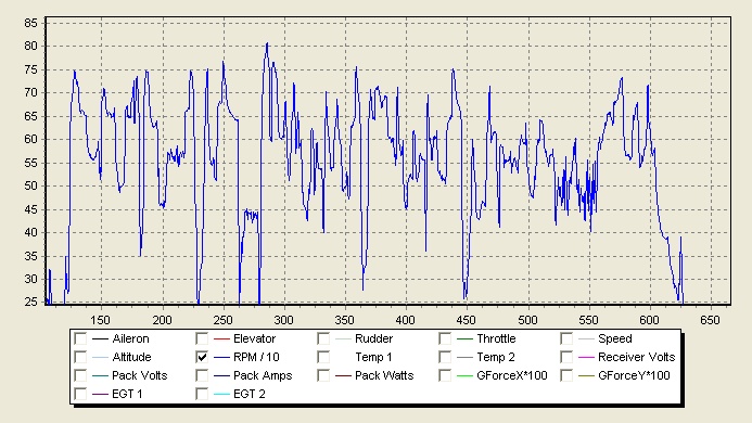

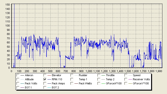

hey tom and fellow da50 wh owners..
i have a 300s w\dA50 .with a data recorder ..
i am running a 24x8 menz..on the ground it only had 6200..in the air see for your self..
i donot full throttle on downlines or strait level only up..lines..this is just one flight .a little over 70degress.and not humid..on average..over 1000 more rpm in flight..

Interesting!
DA recommend to keep the peak RPM range bewteen 6200-7200. I do not know if they are talking about static or in flight now?[8D] [sm=bananahead.gif]
What muffler are you using?

Very enlightening. I wonder what my MVVS puts out?
