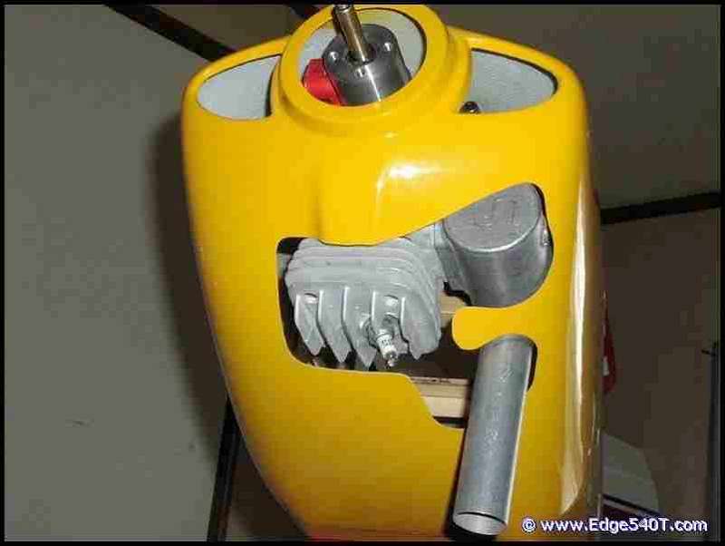

Take a look at the engine install pics at www.edge540t.com to see the cowl butchery nessasary to fit the stock DA muffler.

Reason I went to the slimline? Mostly the appearance. I hated the giant smokestack sticking out of the bottom of my cowl. Its a blemish on the otherwise excellant looks of my plane. I also needed some nose weight and the slimline helped in that regard. Its also a bit quieter than the "noise deflector" DA stock muffler.
