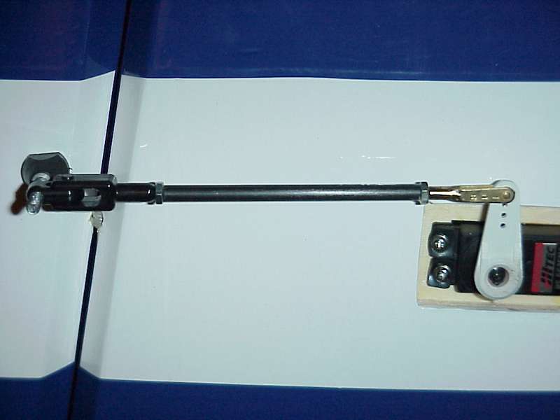

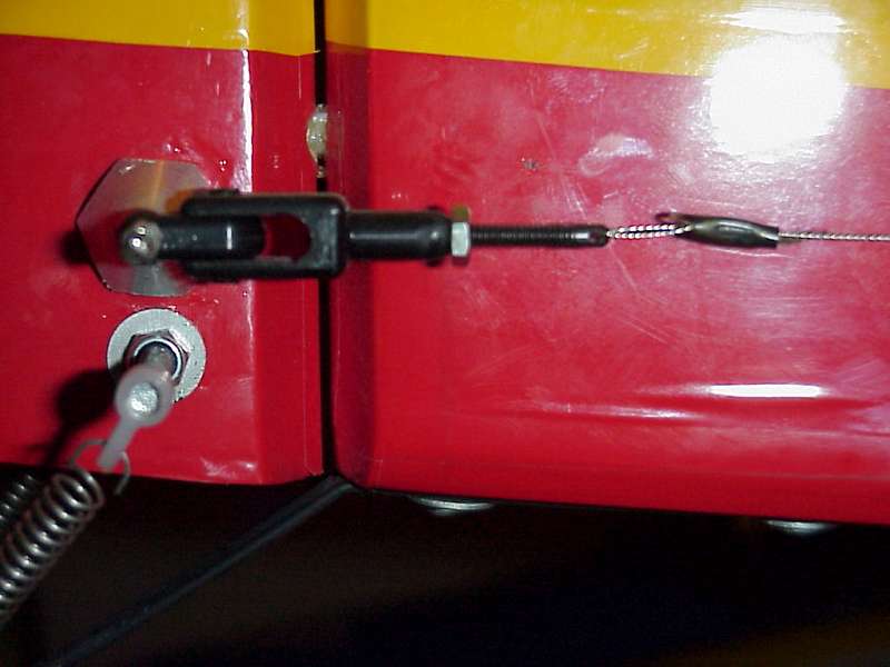

HI I need help with the hardware kit from wildhare this is my firt gas.airplane
I always buy complete arf..not like this ..with too many screw everywhere...
I just need some pictures of the pull pull . aileron push rods..elevators..
to be sure what screw to use..
I using 5945 ,8611 and wildhare hardware kit....to hard for me.....
Thank you....very much...Vic

Hi !
For the pull pull picts....go see this http://www.rcuniverse.com/forum/Supp...2920715/tm.htm
And you will have to buy some ball-link 4-40

All of the blind nuts on the plane are 4mm, there is a small bag of 4mm screws and washers and nuts. Use them to attach cowl, landing gear, horizontal stab. There are also two allen head 4mm screws, use them to retain the wing.
The 4-40 screws and blind nuts are used in the canopy.

Here are some pics of my setup for what it is worth.. Nothing too fancy just a stock setup but I assure you everything is strong and slop free.. I did all of the push rods the same..
