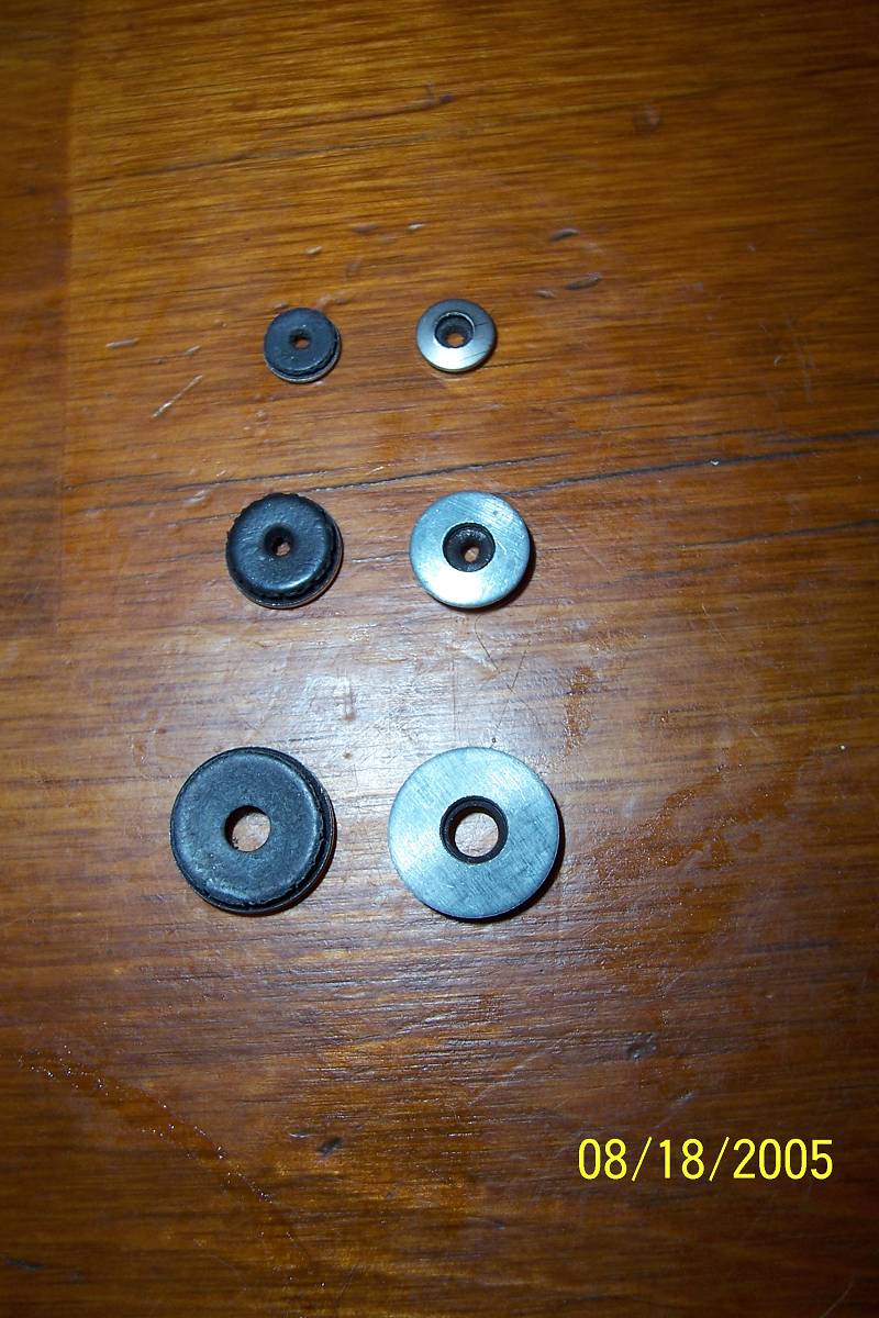

Or use bonded washers, we send some with the HW kit.

Bonded washers

Im telling you guys..get the bonded washers from Microfastners! Ive been using them on my cowl, canopy, wheel pants and wings and in 80+ flights they NEVER have come off..
Old 08-18-2005 | 09:31 PM
My Feedback: (7)
Posts: 717
From: Spring Hill, Florida
Default RE: Wing and canopy bolt insecurity
The bonded washers I use for the cowl, and pants.
For the wing bolt the teflon tape, and fender washer
spreads the load better than the smaller bonded washer.
Not that theres a lot of load on this bolt but, repeated tightenings
do compress the wood some.

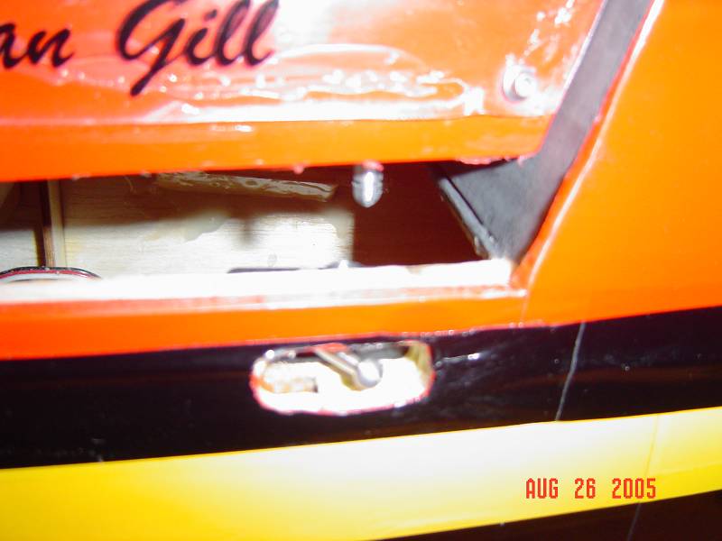

Old 08-26-2005 | 09:29 PM
My Feedback: (-1)
Joined: Jan 2004
Posts: 278
From: bethpage, NY
SCREW THAT,,NO MORE SCREWS
magic box!!!!!!!!!!!!!
ID:	315539   Click image for larger version

I use the same method as some others. Tony Russo from Dalton Aviation setup one of my planes using the nyrod and screw method. Works well, and doesnt vibrate loose. Plus no need to use locktite.
Kudos on those nifty canopy latches with no screws! That looks so cool.
Out of curiousity, I wonder if you had strong enough magnets if that would work?

Old 09-01-2005 | 09:25 PM
cstevec's Avatar
Joined: May 2003
Posts: 1,753
From: Grantsville, WV, VA
That magic box idea would be great but it kinda looks like cr@p. If it was a neater installation maybe.......
