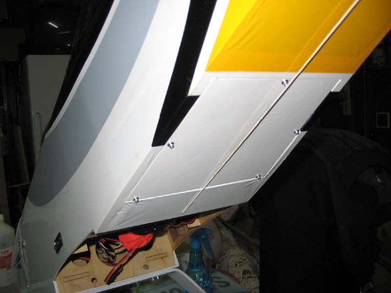

Well finally finished the Ultimate with Evo58, 18.2 lbs according to the digital scale. Batteries had to be located in a new hatch underneath the pilot. 2 Fromeco 2400 packs, If you use Nicads or Nimh then that is probably to far back. Added new landing gear at 1 1/2" taller and "real 6061" to carry the bigger prop.
Pull pull so I guess that could have gone in the tail but more hassle me thinks!!
How do you think it will do on that weight Tom?

btw I made new strut fixtures using a sandwich of Aircraft ply and woven carbon fiber which fits just like the old ones and I dont think that will break.
I refrained from adding epoxy in goops and tristocked the firewall.
6 x 5945s and one 5955tg.
2 reciever packs Lion, 2 switches, 2 Smartfly regulators ( adjustable )
1 Lion 2400 regulated to 5.4v for ignition.
Tru Turn Ulty spinner.
Throttle and choke in the tray either side of the rudder servo.
Beefed up the wing bolt area and as the blind nuts fell out 1 changed them to 1/4 20
Gorilla Glue on the hinges and tail section to fill the gaps.
Hatch added to the area just behind the firewall as the space was too tempting and allows easy access to the fuel tank etc.
Wheel pants had to have a bit of dremel work on them as they are imo 2 small. Max you can fit is 3 1/2 "
There was lots of play in the horizontal, vertical stab to fuse area hence the gorilla glue to fill the voids.

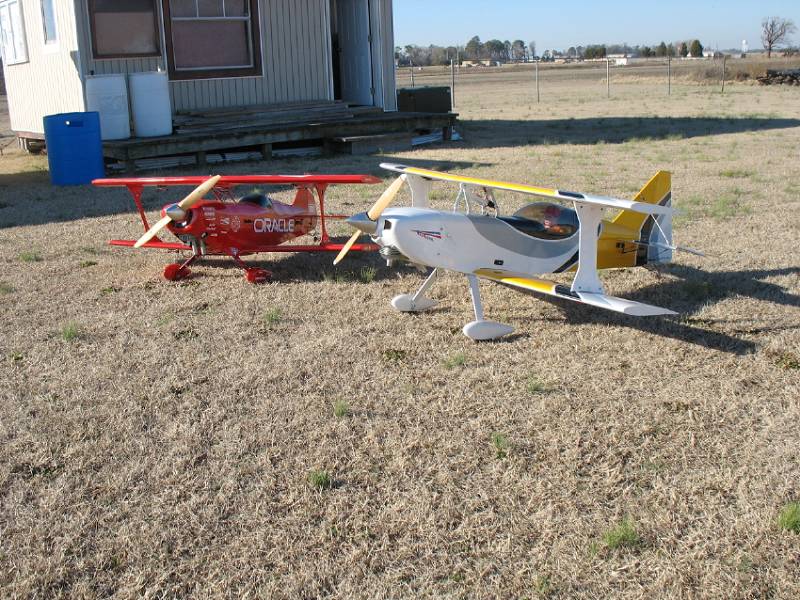

Old 12-08-2005 | 08:16 PM
Panzlflyer's Avatar
My Feedback: (15)
Posts: 1,960
From: Goldsboro, NC
Default RE: Ultimate + Evo 58

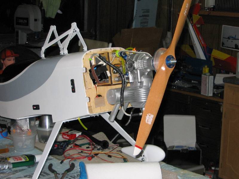

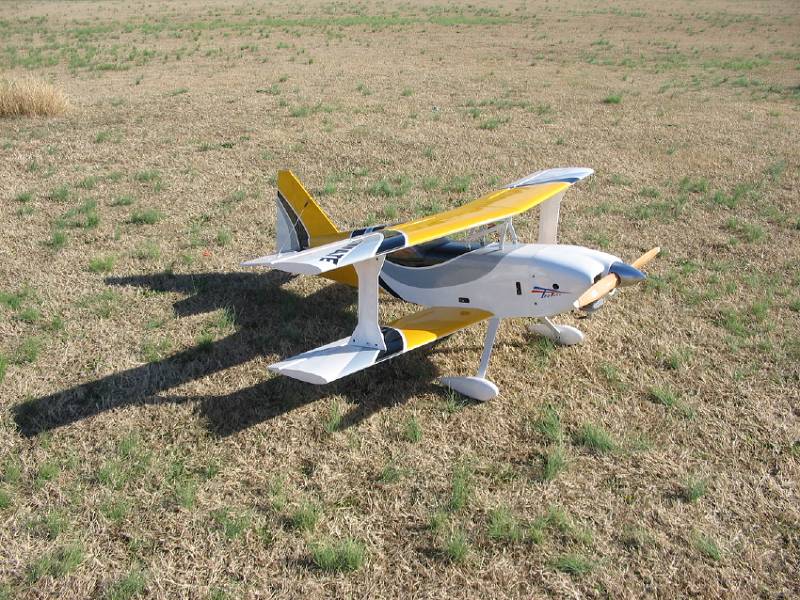

Some pictures
ID:	367108   Click image for larger version
ID:	367109   Click image for larger version

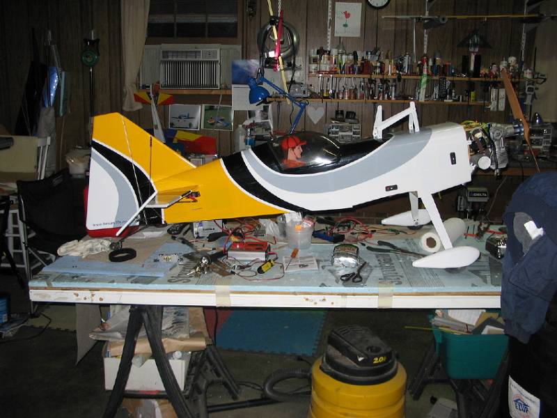

Old 12-08-2005 | 08:22 PM
Panzlflyer's Avatar
My Feedback: (15)
Posts: 1,960
From: Goldsboro, NC

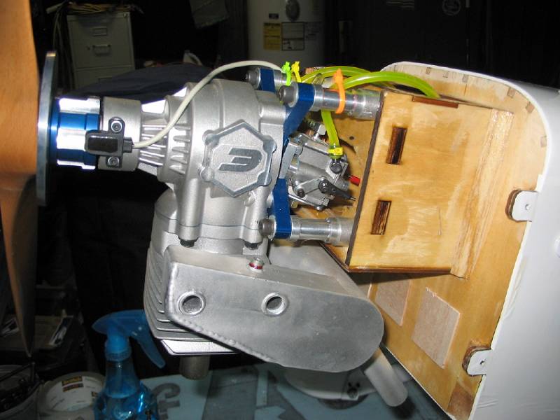

couple more

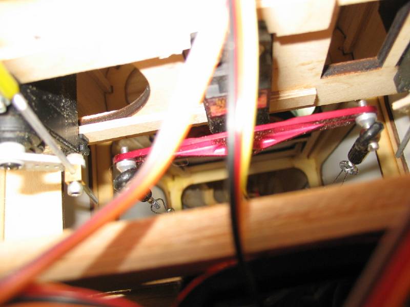

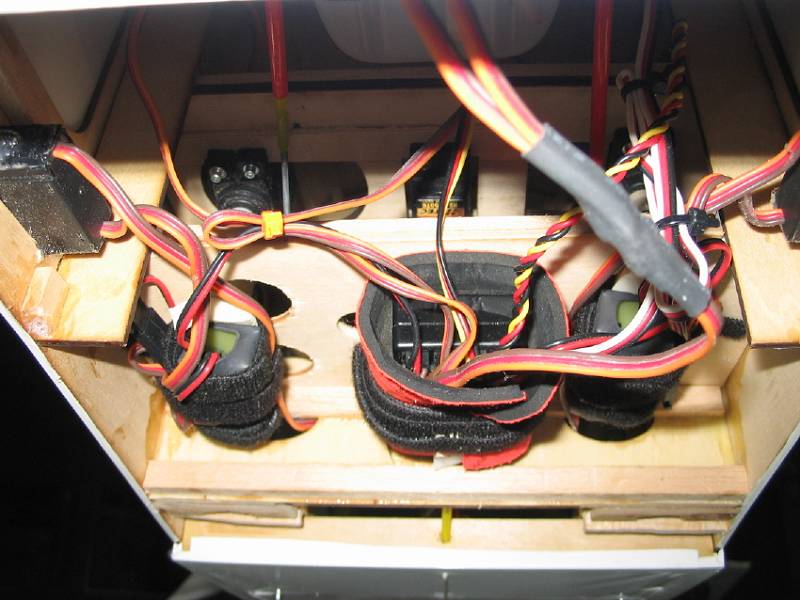

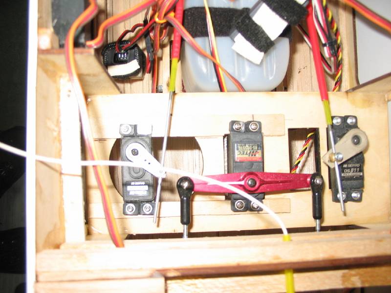

Two requests:
1) Can you take some pictures of your rudder servo and battery set up?
2) How does the spiral wrap hold up to the heat of the engine? I've been wanting to get some but not sure if it will melt or not.
Phamil1 and I fired up my Evo 58 tonight. It's going to be SWWEEEEEEEETTTTTTTTTTTTTTTTT!!!!!!!!!!

Ill try and get the camera in there.
The spiral wrap doesnt touch anything and seems okay as its mainly to stop chafe from the cowl.
I would add extra screws to the cowl and add some glass to the existing screw holes as the cowl is way thin in places. Mine started to enlarge the holes after 3rd flight.
Also watch out how you position the prop and flip the moter as it runs backwards easily. follow thru on the swing!!

Old 12-09-2005 | 05:26 PM
Panzlflyer's Avatar
My Feedback: (15)
Posts: 1,960
From: Goldsboro, NC
Dont know if this helps but batteries are under the hatch.
ID:	367465   Click image for larger version
ID:	367466   Click image for larger version
ID:	367467   Click image for larger version

After I looked at the pictures I realised that I had lost the backing nuts from the Rudder arm!!!

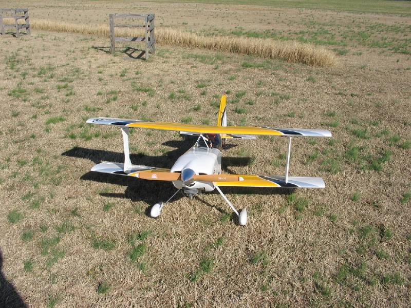

Old 12-24-2005 | 09:44 PM
bluemagic98's Avatar
Joined: Jul 2004
Posts: 869
From: Wisconsin Rapids, WI
I have to laugh we have 3 or 4 of these DA's in our club and they all ran fine right out of the box. After break in I leaned mine out just a touch. If you lean it out to much it will stall when you punch it especially when cold I idle mine down to where she wont roll out on the field when at idle if you idle any engine down to low and do an inverted flat spin or any other manuver that torques the prop around your asking for trouble. I found My DA to be worth every cent i spent on it. I am however very curious to find out what the turn around time is on an Evo sent back to horizon so far DA has averaged about week.
Old 12-24-2005 | 10:14 PM
Panzlflyer's Avatar
My Feedback: (15)
Posts: 1,960
From: Goldsboro, NC
I cured the running backwards by moving the prop position one more bolt hole counter clockwise from 1 oclock
ID:	375285   Click image for larger version
