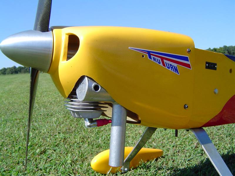

I know you got to chop the cowl up for the stock DA muffler, but I switched back to it after a year of the Slimline Pitts. 300 rpm gain on a Mejzlik 22x10 prop and weighing 6 oz. LESS was too much to pass up.

Thats not even that bad..Ive seen a lot worse

At least my muffler exhaust tube is full length!

My Slimline weighs 8.9 ounces. So if yours weighs 6 oz less that puts it at 2.9 ounces? Wow if so that is light.

On my scale, Da muffler 5 oz. Slimline Pitts no smoke 11 oz.

Ahh must be that extra bracket for the Slimline and the mounting bolts. That would add up to another two ounces.
That DA muffler is still very light. Is it loud?

IMO, it's a bit louder on the ground, but once you get in the air, it's not bad at all. It's still louder than the Slimline Pitts, but not near as loud as a B&B muffler on a G62. I'm able to do TR's 20' out and 20' up and not find it annoying......
