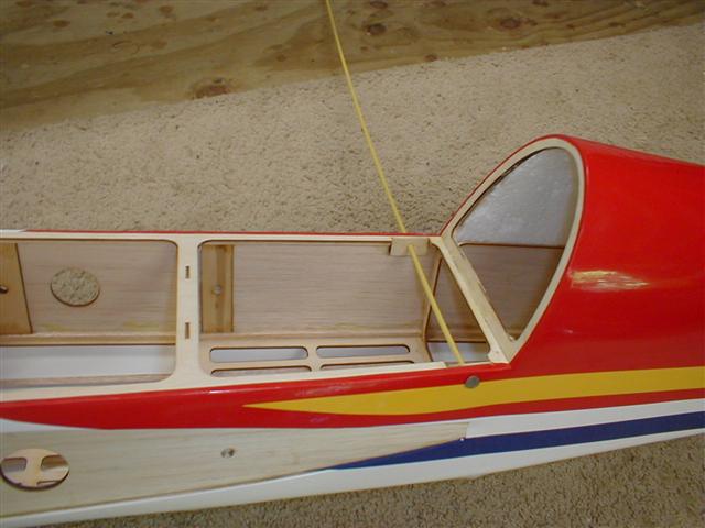

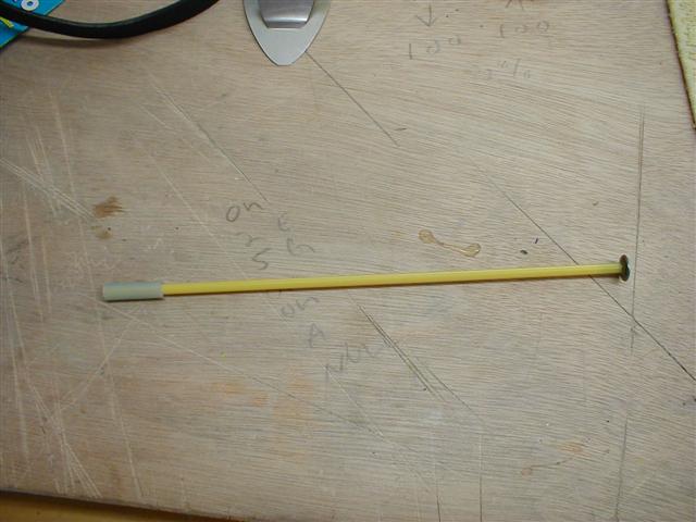

Last year I experienced a hatch coming off at 200 ft due to the bolts vibrating loose. Since then I have used the following hatch retention on my Wild Hare Baby Edge, 28% Edge, and YAK. It's light, easy to make, vibration proof, and you can open and close the hatch in seconds. I've been using it for a year now with no problems.

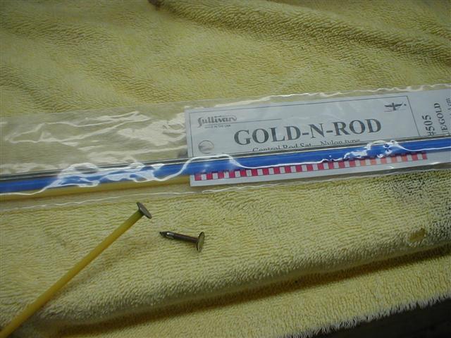

I use the Sullivan Gold-n-Rod, a shingle nail, fuel tubing, and epoxy glue.
1. First, grind down the shaft of a shingle nail so it will fit into the inner Gold-n-Rod. Then I use 2 ton epoxy to glue the nail into the rod. You can shine the nail head up or paint it.

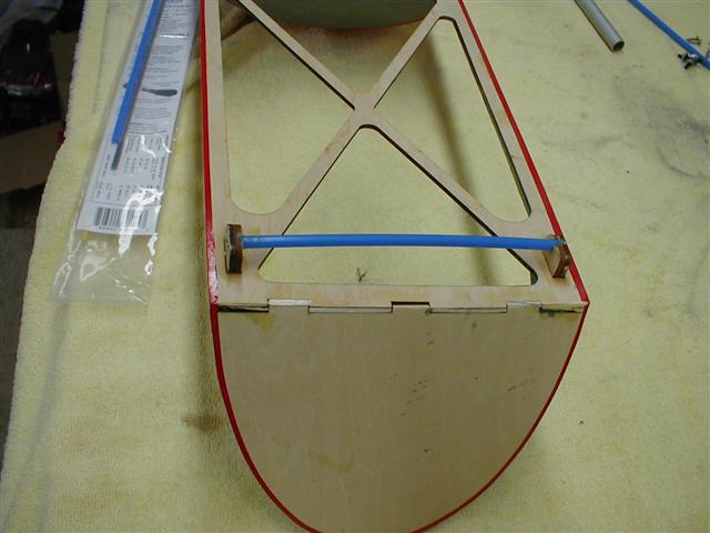

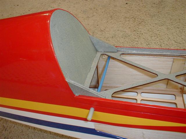

2. After the glue cures, run the rod through the fuselage holes that the hold down bolts would go through. Pull the rod all the way through until the nail head is against the fuselage. Leave about ½ to 1 inch hanging out of the other side and cut the rod. Be sure to taper the end you just cut.
3. Cut a piece of fuel tubing ½ to 1 inch long. The tubing will slide over the end of the rod that sticks out on the side opposite the nail. I use ordinary glow fuel tubing.
4. Now drill the holes in the hatch tabs big enough for the outer Gold-n-Rod. Slide the outer tube through the hatch holes, cut to fit, and glue it. See pictures:

Not a bad idea except for the nub sticking out. In the manual I suggest substituting 1/4"-20 nylon screws with threads cut into the wood tabs, I use that an almost everything now and have never lost one screw, let alone the hatch.

Besides security, another plus is not having to fool with screws. You just slide a piece of fuel tubing off and on.
