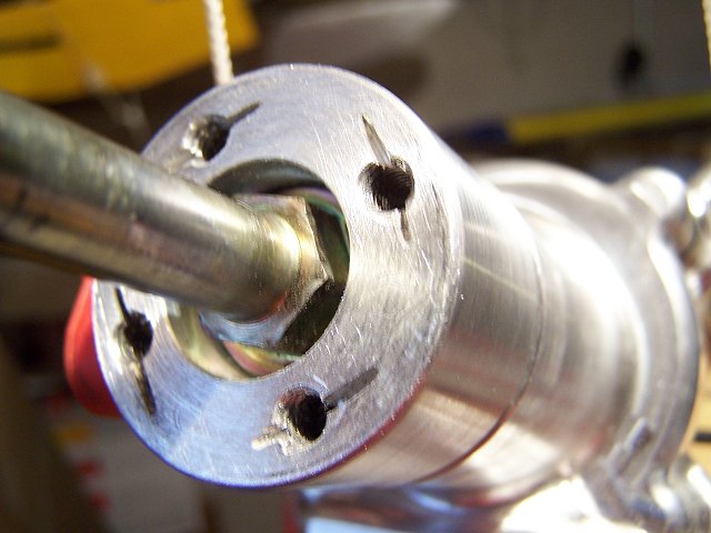

Dont forget to recheck the bolts at the begining of every season. The wood can dry on the off season and actually shrink making the bolts loose. I had to digg the busted ends out of my hub at the beginning of the season.

Old 07-12-2006 | 09:53 AM
Posts: 18,602
From: Valley Springs, CA
Default RE: Loc-Tite on Prop bolts
