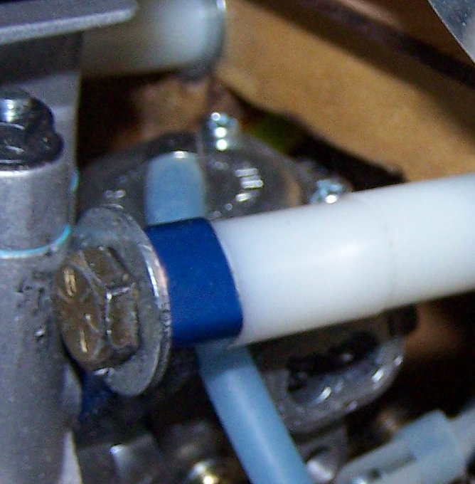

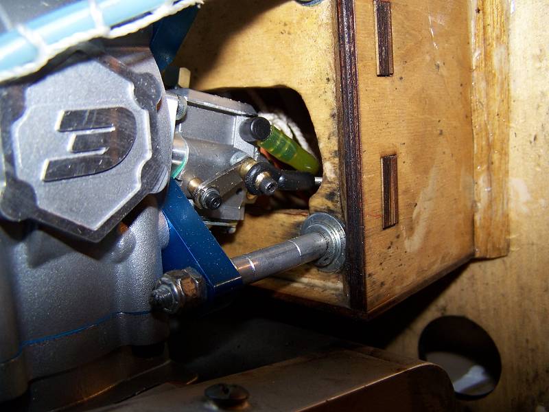

Depending on the bolts im ussing to hold down the motor i use a alminum spacer found at the hardware store the come in many sizes and the work great for the 10-24 allthread and if i use 1/4-20 bolts i go with nylon spacers also found at ace hardware.
