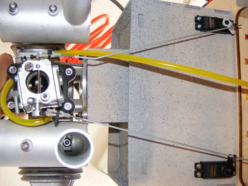

hi all...this my first giant build and looking for some feedback so far, is taken me a long time to finish this due to work travel but now am on the last stretch and have couple questions
1. I am using choke servo, but wanted to see if I have setup the linkages for both throttle and choke correctly, I am not sure they appear to be in good angle/bracing
2. The hinge rod on the wing extends out, does that get cut off? or is it not in all the way?
3. i have read elsewhere about 3'' rudder arm pull-pull, will that give sufficient throw? am using single JR8711
appreciate any feedback

ORIGINAL: kiosk
I would move the throttle servo closer to the center, the choke servo also. I don't know why the factory put those holes way out at the edge, it makes for an awkward angle. You want the throttle to be smooth and positive.
You can cut it off, but having a little sticking out makes it easier to get hold of if you ever need to pull it out for some reason.
3" is enough if the arm in the rudder is only 3-3.5" long. The ratio of servo arm<>rudder arm is what determines rudder movement.
If the servo arm is 3" and the rudder arm is 4" then rudder motion will be 3/4 of servo movement. If they are the same length it is then a 1-1 ratio.
