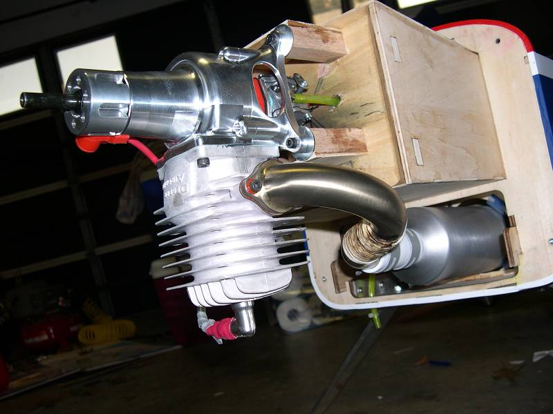

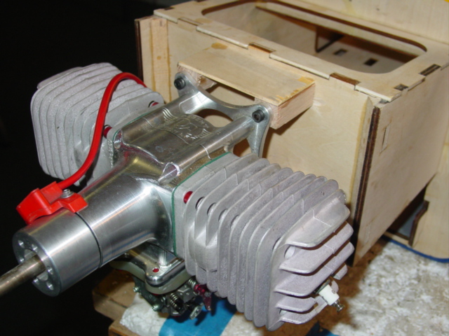

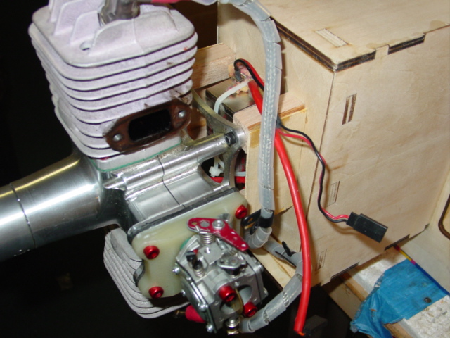

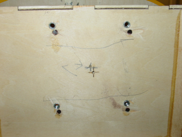

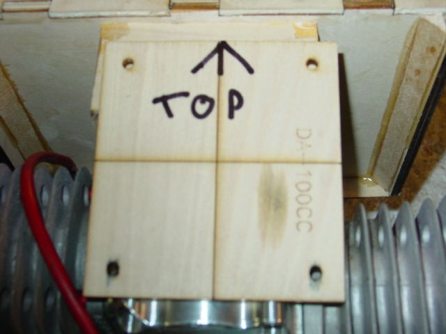

The first step is to get the engine mounted. Our new planes come with the firewall marked and an engine template, so all you need to do is line up the marks with on the firewall and the template and drill the mounting holes. We also sell a mounting kit that has the engine mounting spacers (standoffs, sort of, but more rigid and less expensive than machined standoffs) plus blind nuts and long socket head screws.
In this case this was the first plane of a new shipment so I needed to verify the location of the mark. As I expected it was off a little, so I mounted the engine once, found out how far it was off, then filled the holes and re-mounted it in the proper location.
Now that I have done this, you would know the correct location is UP 1/4" and to the left (viewing the plane) about 1/8". So make a new mark there and use that mark as your reference.
Also note the DA-100 template is marked along its side, not along the top. See photo.

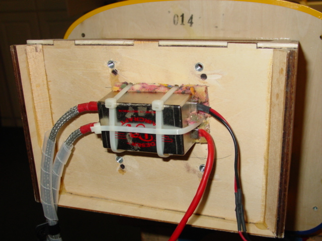

I mounted the DA-100 ignition in the void behind the engine. The spacers are 1 3/4" deep which is plenty of room for the ignition.
I mount most things on foam and with zip-ties. Don't pull the zip-ties down real tight, that just increases shocks transferred to the ignition from vibration, instead leave them a little loose and surround the box on all sides so it can't slip out.
The firewall photo shows the initial mounting and then the revised location.

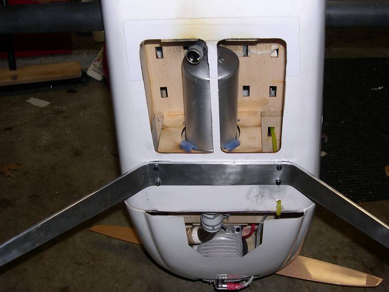

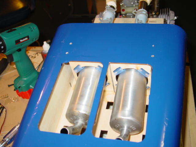

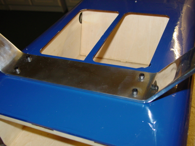

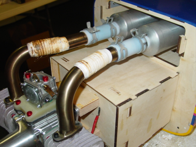

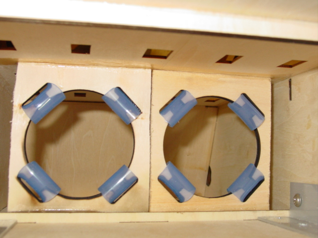

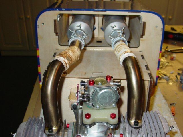

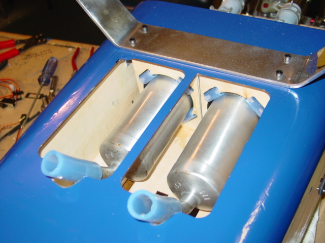

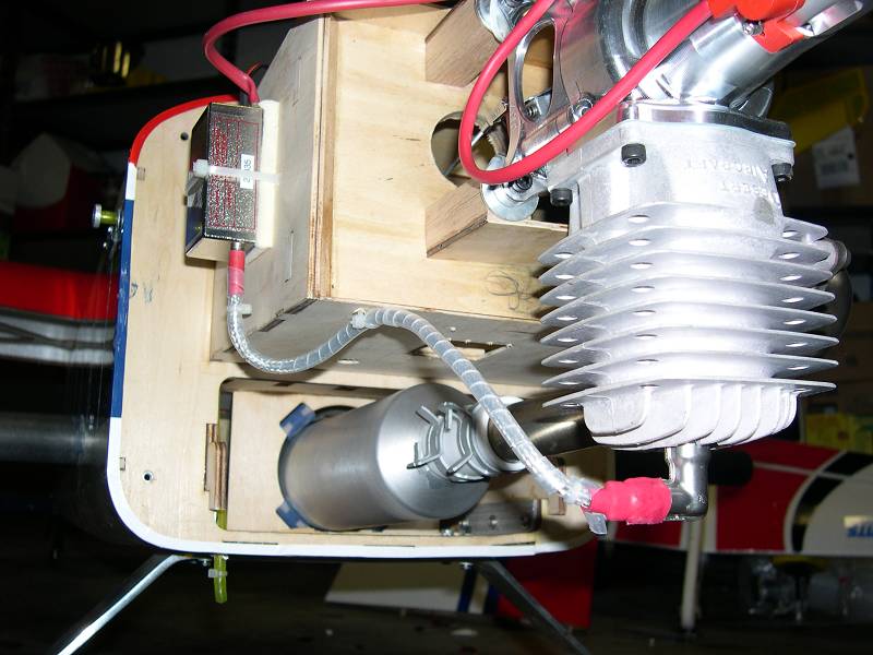

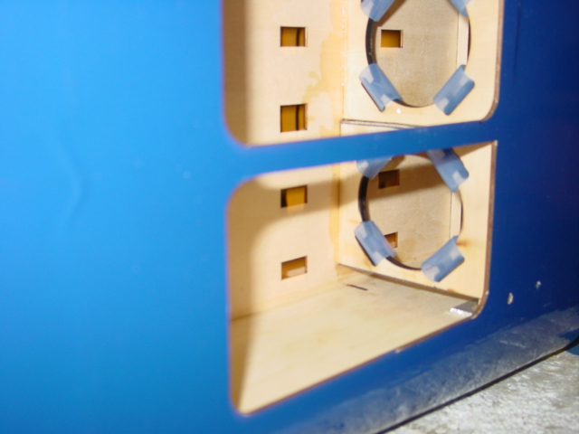

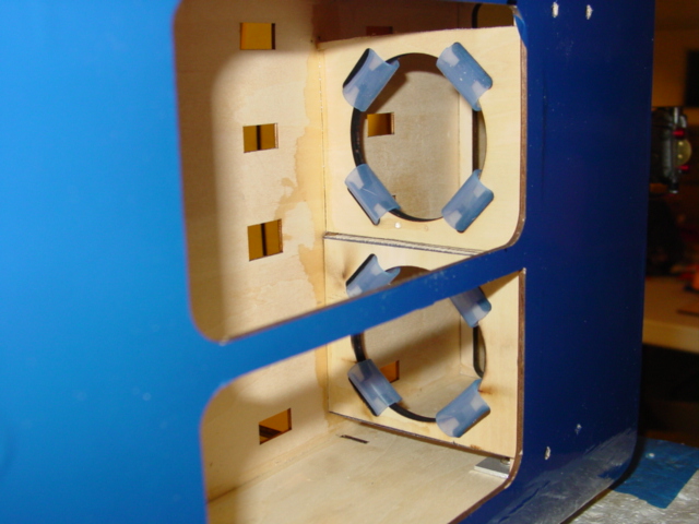

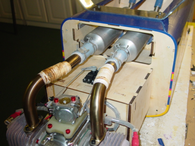

Next comes the canister installation. We sell ply canister mounts that have plenty of material around the perimiter. The job here is to trim the mount to the right size. It should mount to the rear of the landing gear plate and also glue to the underside of the canister tunnel top. Here are beforee and after photos, and the completed setup.
This uses KS 86-4 canisters and 90mm drop headers with a flex section.
The mount is supplied with a section of silicone tubing. You need to cut pieces about 3/4" long and slip them in so the fingers of the mount go inside the tubing, the muffler is then suspended in the silicone with room for air to circulate around it.
Exhaust holes are provided to let the hit air and exhaust out, just trim away the covering. With these open you should not need to cut any hoiles in the cowl at all.
These are rear exit cans and are a touch longer than the provided holes, I will trim the rear edge and also install some silicone extensions on the tips to direct exhaust out of the plane. They also need stops against the rear of the cans to keep them from moving backwards, this is often left out and the first flight ends up with the cans disconnected from the header.

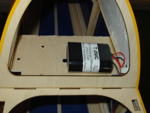

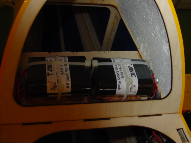

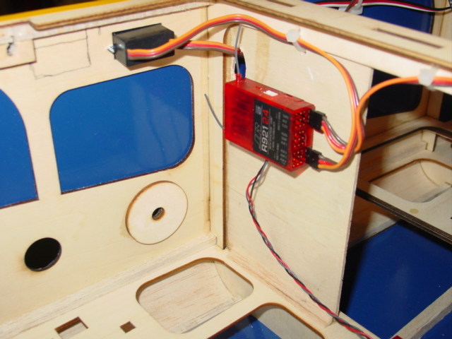

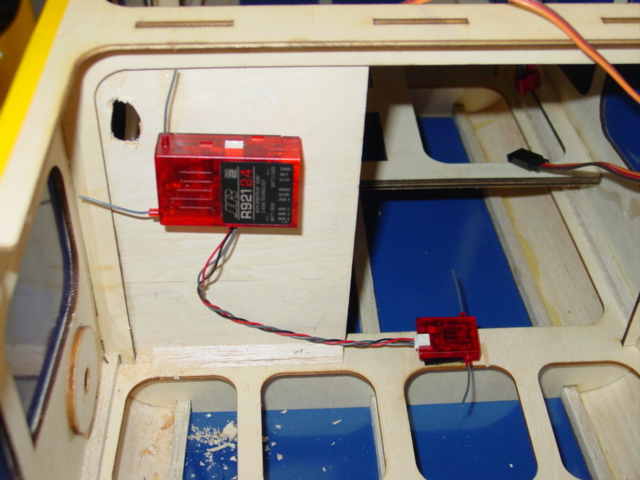

After building so many planes I have learned to invest a little time in planning where to put everything. I know from experience that this plane will come out nose heavy, so I installed a little platform behind the canopy to mount the two A123 battery packs. I cut the corners off the leave a little window to route the wires.

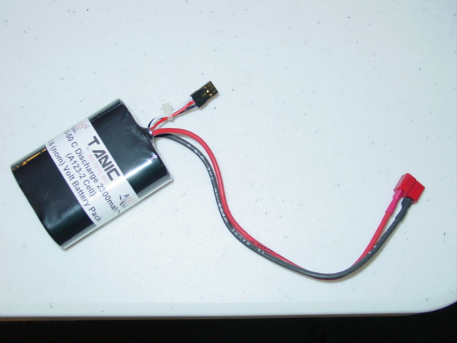

I will be using 2 packs, one for just the receiver and the other will power the receiver and also the ignition. I have tested this in 2 planes and it works fine with my JR 2.4 ghz. radios.
I modified the battery packs and replaced the Cellpro charge jack with a standard JR receiver plug, and then added a long extension to carry power forward to the ignition. ON teh other pack I just left a servo connector there tro use when charging.
I made a little adapter for the Cellpro to charge through the charge jack on the ignition or through a standard servo extension. This is a little complicated to explain but is simple in practice.
I also installed a lite ply bulkhead to mount the receiver. This puts the receiver antennas up high which is where JR says to put them, with the satellite mounted in the bottom. Both switches will reach the receiver and the batteries without any wires hanging in the middle, very neat.
I mount the receiver on Velcro, this is plenty secure and as long as you don't tie it down with anything else it provides cushioning for the receiver to isoloate it from severe vibration.
Joined: May 2002
Posts: 6,189
Received 2 Likes
2 Posts
From: Flower Mound (near Dallas),
TX
Using two connections into the receiver like this is good for at least 12 amps in a burst, so a power box is definitely not necessary. Some of my testing has shown that some power boxes' internal circuitry actually limit the current to the servos.

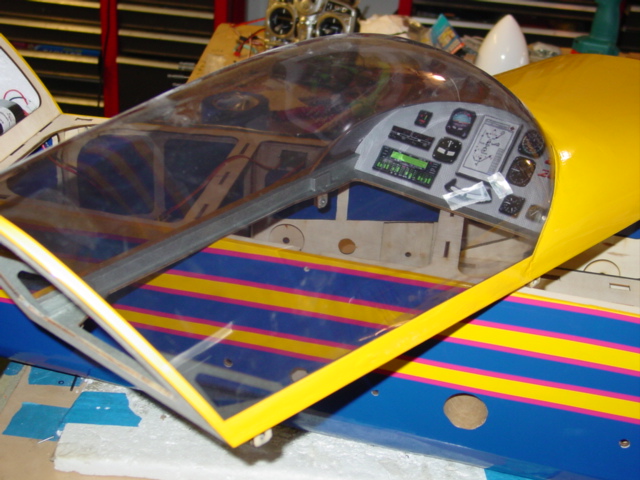

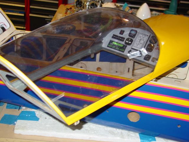

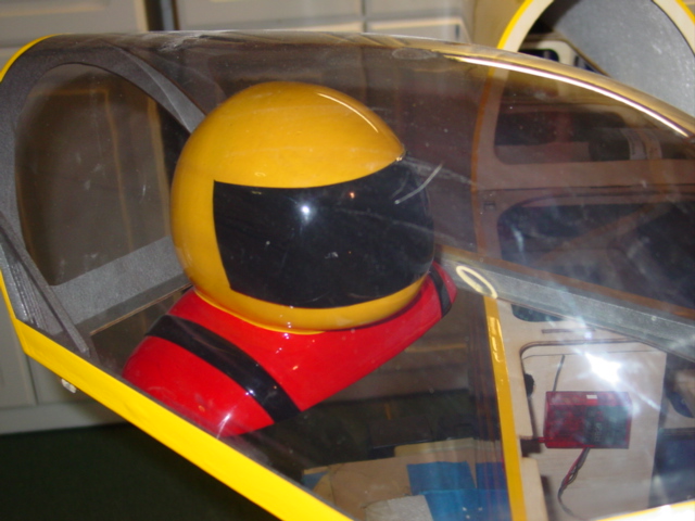

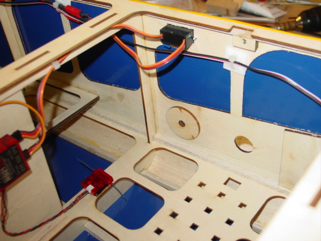

Doing the hatch involves exactly NOTHING. It's already done, except for installing a pilot if you so desire.
The 40% helmet head pilot we sell sits inside the hatch rails, a few dabs of silicone glue to hold it in place and it looks like this.
The panel is pre-installed. IMAC here we come.

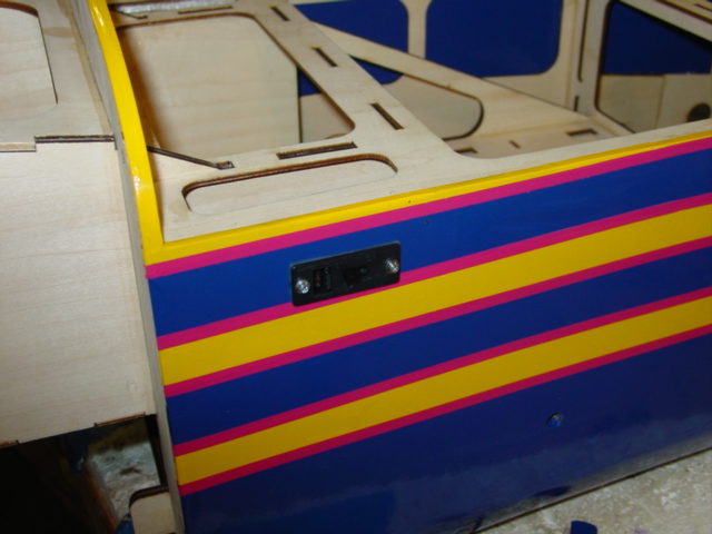

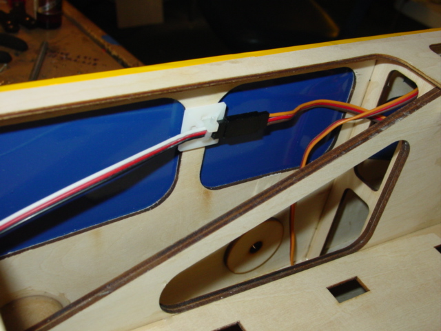

Hooking up the ignition involved simply installing a switch in the pre-cut hole and hooking up to the power extension that I ran up the left side of the fuse.
I use these little plastic gizmos called cable stands, you can get them at any electronics store. Buy a bag of them, they are self adhesive and stick to wood very well. Then just use a zip-tie to hold cables in place and out of the way.
I use a choke servo instead of a kill switch, this is a great way to kill the engine in case the throttle linkage fails.
BTW with these switches I just use the litel hex head servo screws that I use for everything, I throw away the little mounting screws and backing plate that come with the switch.

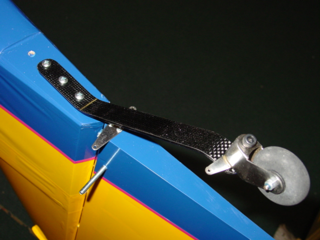

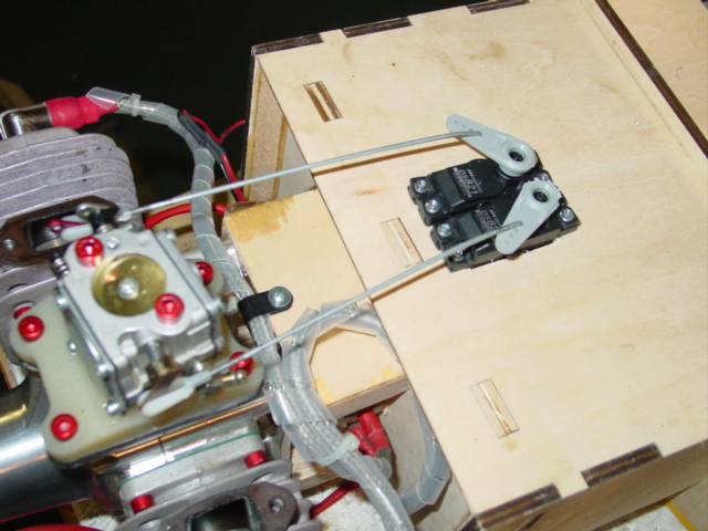

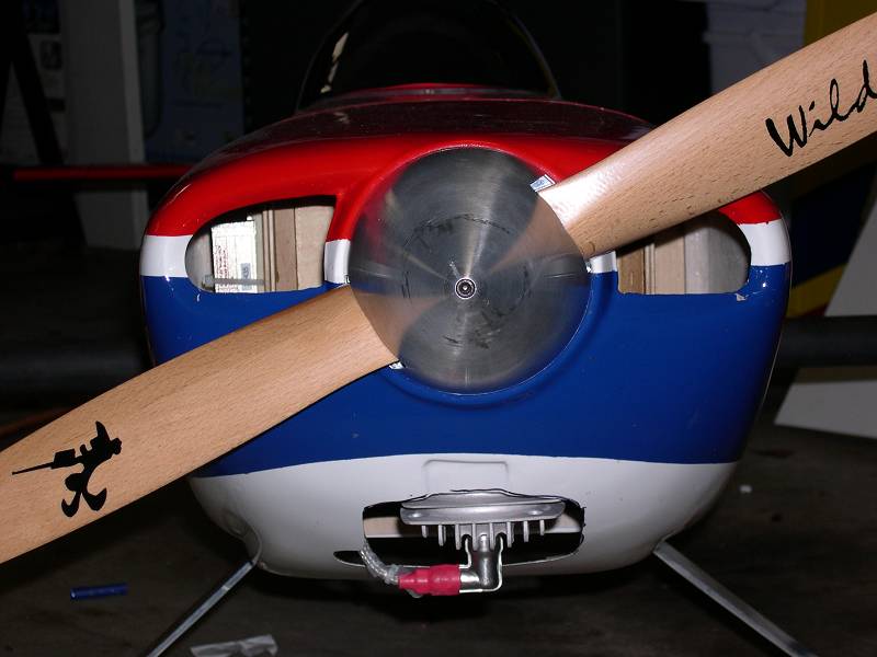

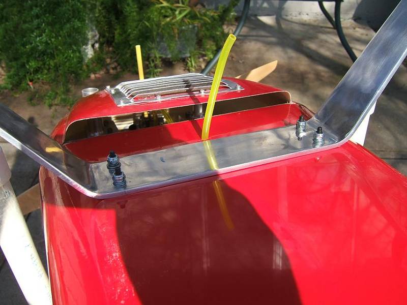

This step completes the engine installation. I used servos on throttole and choke, had to make a new little lever for the DA-100 choke shaft as usual. I used JR DS821 servos because I had them left from my X9303 radio.
Since it's easier to install the landing gear without the cans in place this is a good time for that. I redrilled the holes with a 3/16" drill because they were a little small.
I installed the carbon-fiber tailwheel upgrade just for fun. I am planning to see how it handles as a castering tailwheel, not attached to the rudder. I did this on a 73" Edge and it worked quite well, if it works here that just simplifies the installation.

Tom and/or Pat. I am really interestd in this plane and watching the build thread with great interest. My thouhgts are towards a DA85 with the canaster exaust, mostly because I would love to try an 85 and the cost and weight savings are so great. I am however having some real problems picturing the heat exhaust for the engine (on either the 100 or 85). I have always been led to believe by "the experts" that the engine exhaust area should be greater than 2-3 times larger than the cowl intake area. I know how the air enters the cowl and from reading other posts understand it should exit out the canister tunnel. But how does it get out after you install the canisters and block the rest of the tunnel with the mount. With your setup as pictured above will it still be necessary to cut an exaust opening in the cowl or will enough air get to the back openings to provide adequate cooling. Sorry if this is a stupid quesiton.
Pretty easily actually.
Tom had the cowl designed so it drops down below the bottom of the fuselage a little bit. It remains open at that point. It's design will create a nice low pressue zone that will assist drawing the heat from both the engine compartment and the header dump openings. The picture gives the general idea about how the cowl fits and remains open.
I added the louvered vent on mine, I'm using mufflers and wanted more exit area and won't have the benefit of the large cannister exit openings.
Thanks Pat. Didn't know the scope was there. That is a pretty cool feature. I also like your louvered vent. Functional and adds some class!!!!!!

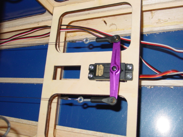

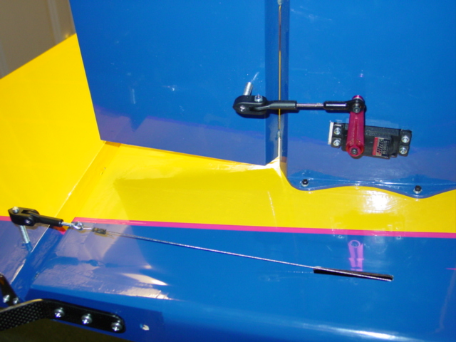

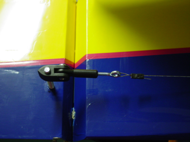

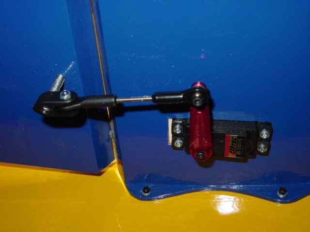

OK I am basically done. I put on the elevators/stabs, installed the ruder servo and the pull-pull. I did a test balance first and the CG is at the fro0nt edge of the wing tube, so I elected not to put a servo in back.
The pushrods on elevator are only 1 1/2 inches long and less than an inch is exposed so I decided that the fiberglass tube sleeve was unnecessary.
With the control horns out from the rudder center 1 1/2" the cables just clear the edge of the elevators. It's close but it clears.
Tomorrow I will do the clean up, tie down all the servo extensions and make everything neat, I should have finished photos tomorrow and hope to do the maiden on Thursday.
Altogether I think I spent about 6-7 hours on it. By far the most time consuming part is installing the engine. Even though mounting it is easy, doing the canisters, ignition mount, throttle and choke servo linkages, etc. took me probably half the time I spent on the plane. An 85 single is easier, a lot less to do.
