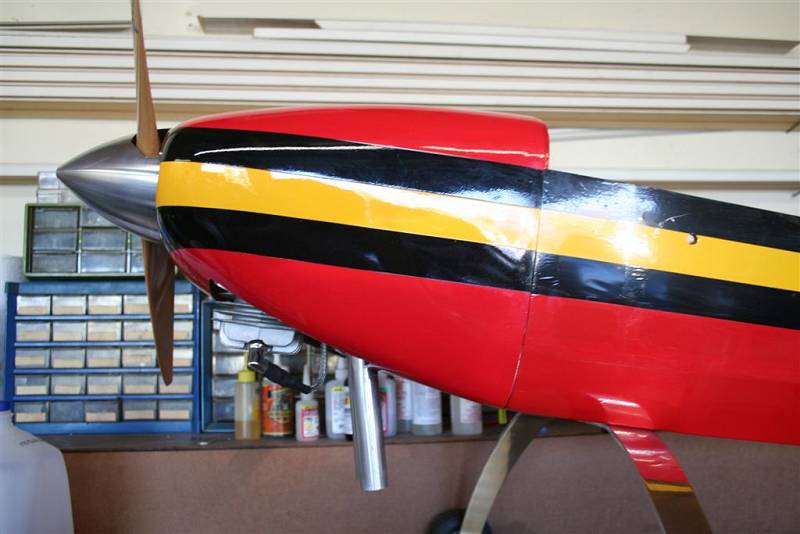

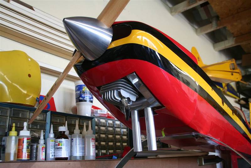

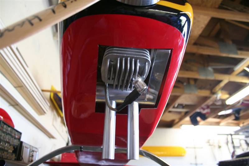

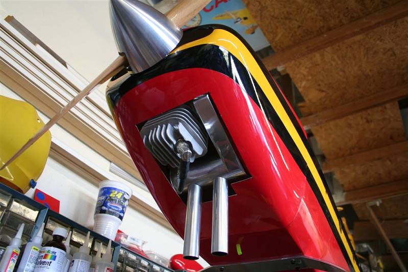

2. Please review the attached photos, does it appear that I have sufficient clearance/air exit around the engine? Or is it too tight?

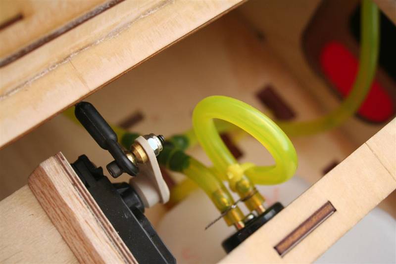

3. I am using ball links for the throttle. This seems to transfer a lot of vibration to the throttle servo. At full RPM I can see the rod vibrate substantially, and if I touch it, I can feel a lot of vibration being transfered. Should I be using something less rigid? Should I be using ny-rod and standard clevises with a little more “slop” to release some of this energy? I balanced the prop and hub both. (see hardware photo of the throttle servo)

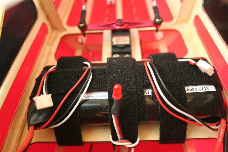

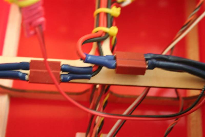

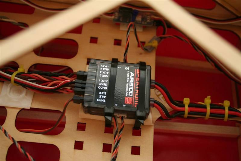

4. Should the wiring be tightly secured or left somewhat loose when “zip-tied”? (see photo of my receiver)

The answer to question 2 is NO, it is too tight. the general rule is you want three times the exit area as the the intake area. ie; if you have a 1" square opening in the front, you want no less than a 1.5" square opening for the air to exit- 1" sq. = 1sq. inch- 1.5" sq. = 3 sq inch. etc etc.
For #3, I have a similar installation for the throttle servo, and have had no issue in 60 or 70 flights with that servo/linkage.
I would leave some slack in everything- You have to take in to account the G-forces that this plane can see- I would imagine it could be upwards of 10 or 15 G's
Just think, your 6oz battery could possibly weigh 3 to 4 pounds in a wall or snap roll. you know things will flex and move around a bit.

On question #2. If there is no extra cutout exists other than the one on the cowl, then probably yes, you need to open it up more. It should be at least the same size as the current cut-out.
On #3. you can install an sleeve tube over the nylon rod and anchor the sleeve tube somewhere inside the engine box of front of fuse with a piece of 1/8 plywood. The rod should slide freely inside the sleeve tube.

The ball link connections at the throttle servo are a good thing. Changing to a regular clevis would not change the amount of vibration, but it would permit a loose fitting clevis pin to enlarge the hole in the servo arm, reducing throttle response and accuracy over time. Gassers have strong combustion impulses, so vibration is a given. Glow engines have more but it's on a higher frequency and therefore not as visible. Just as damaging over time though.

I secure any wires or group of wires that are "flight critical", which probably means all of them. "G" forces place increased loads on anything, including wire connectors, so increased load factors occur on connector pins and wires just as they do on anything else. It's always a tragedy when a wire pulls out of a receiver or elsewhere for an "unknown" reason. Things flopping around inside a fuselage place a lot of strain on themselves so securing them so they don't fly around is a good thing. They don't have to be rigidly mounted along their entire length but a cinch here and their to limit motion is good enough.

My wire securing method matches Pat's words pretty closely. Secure everything but not so tight that the wire ties and/or wood cuts into the wires. Securing something too tight can actually transfer vibrations better than if you left it a little looser (ie velcro squeezing down an ignition module's foam padding against the motor box). Moderation is good. I never leave anything over a few inches without being secured. G forces will tug on the 2 ounce extension and make it a pound during a snap roll. And always go over the plane now and then to look for cut wire insulation and fuel lines. This is one of those "ask me how I know" experiences.

Is it just the picture or is your muffler almost touching the cowling on the right side bottom?

Thanks again to all. The photo of the muffler may not show the best detail. Their is about 3/8" of an inch clearance or thereabouts.

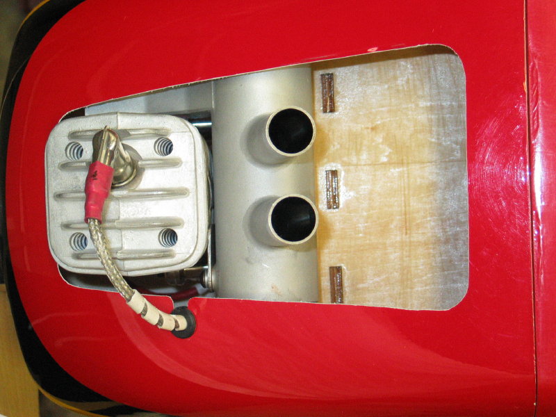

With the understanding that you prolly don't want to do so, it would be good if you opened up the bottom of the cowl behind the muffler a little. That muffler gets pretty hot and the extra area would vent some of it.
Those Deans connectors become pretty heavy during hard maneuvering. Though they are hard to disconnect, securing the wires a short distance behind them would be a good thing. Leave enough slack to enable "working" the connectors.
You might want to cut off some of that exhaust stack. It won'r effect engine performance either way. The first thing that happens in a nose over is the stack hits the ground and tears out of the muffler. A shorter stack is easier to work with when removing/installing the cowl and is no longer the second thing to hit the ground. The first is the prop....

That looks like a good clean cuttout. Thanks for the photo!
