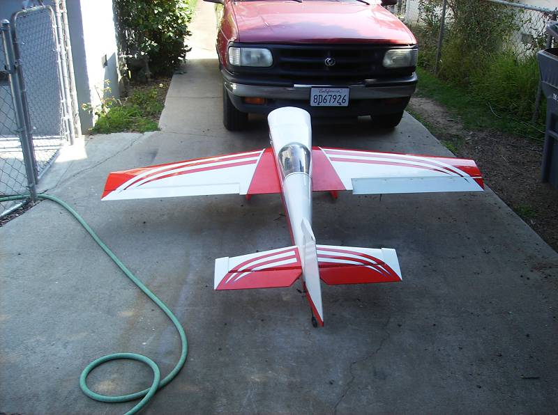

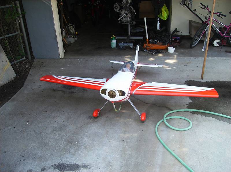

I just picked up a 33% Wildhare giles 202. This plane came with a brand new brison 4.2 I believe. It has all the control rods and everything connected to it still. The guy I got it from flew it with a 50cc thor motor. My question is I am no aerobatic flyer, I like cruising and a couple loops and aileron rolls. I was thinking about using 2 hitec 645mg's at each control surface. Will this be enough. Basically I want a fun flyer on a budget. If this will not work please give me advice as to what will work.

Wild Hare has never made a 33% G-202. Their first plane was a 35% G-202. The only other one they've made is the latest version at 41%. The 35% original would have never flown with a 50cc engine because it weighed in at around 25 or 26 pounds with a 100cc engine. The best you could hope for would be around 23 pounds with a 50cc engine on a 35% Giles.

OK, pictures ae working now. It looks like a 35% Wild Hare, 93" span. I have one too. Your servos are not up to the task and a 75cc engine will be about the smallest that will fly it with any strength. There are quite a few 80's on the used market at the moment.
