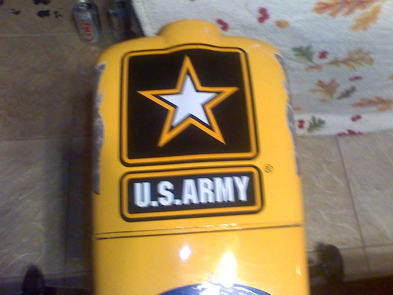

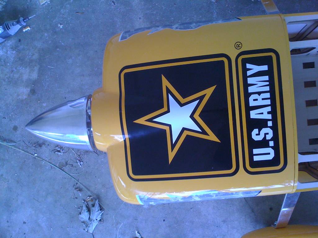

First of all Props to Tom and everybody at Wild Hare RC, this is a great plane. The shipping was fast, 3 days and I had it in my hands.
Second, I know I am not supposed to put it together before Iget the engine mounted but Ijust couldn't resist. Here are a few pics of it before I start trying to build it.

<p align="center"><font size="2" color="#ff6600">Nice looking plane...Where do you acquire the <font color="#ff0000">ARMY</font> decals/stickers ?     .</font></p>

Eric over at B and Graphix did those for me. They look great don't they?

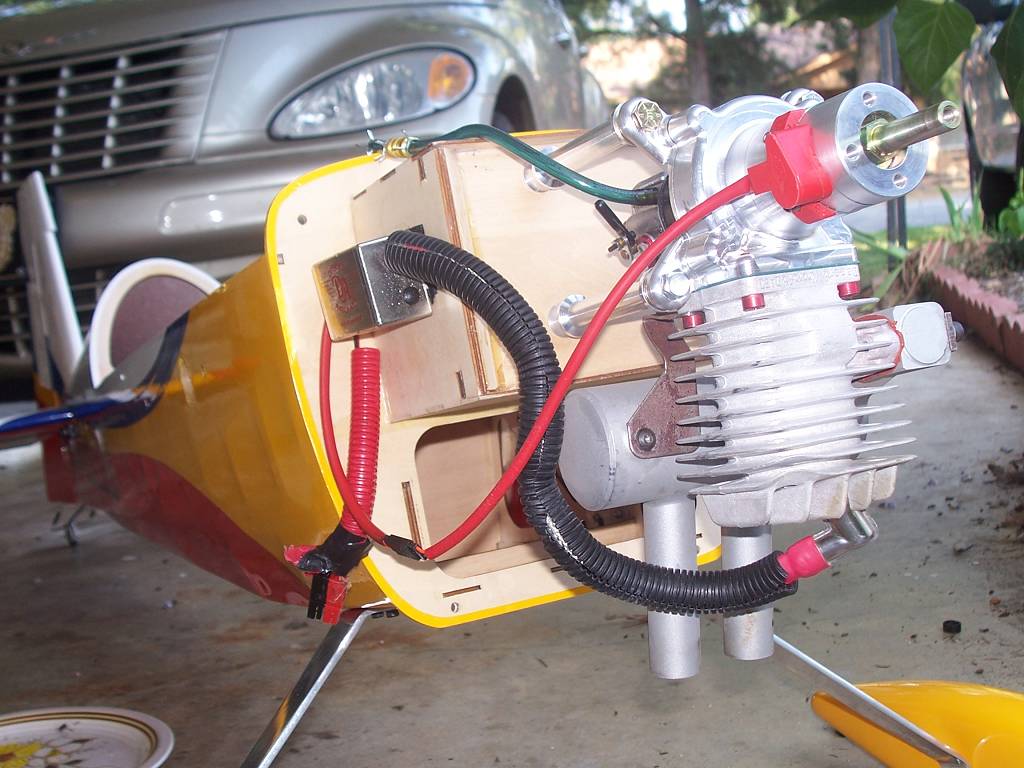

Ok, here is the update. Do not ever put your hands into an APC prop on a Saito 180, it will remove your fingers. I now have a new nickname "chopper". Ok now to the situation at hand.
I have just hung the DA 50 on the front of my Edge 540, as illustrated by the pictures below. I got my stand off from TBM and they worked perfectly. Now I come to the part where I have to cut the cowl to fit the motor, and this is where I become fearful of my building skills. the back plate of the spinner is 11 1/4 inches from the filrewall, and the center of the muffler canister is 5 1/2 inches from the firewall. How would be the best way to guage the exact place to cut the cowl?

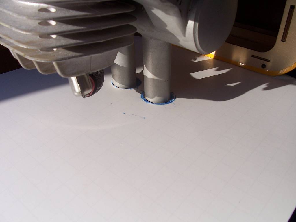

Tape pieces of poster board (available at art and stationary stores) on the fuselage without the cowl, extending past where the engine is located. Make your cut outs in the poster board. Make the cut outs tight. Without removing the poster board, remove your engine and mufflers then install the cowl with the cut out poster board outside the cowl. Mark the cowl through the holes previously made in the poster board. Adjust the tight hole size for better clearance after the primary cut and fit is done.

Tired Old man, thanks for the reply. I have done what I think you were trying to tell me. Please look at the following pictures and tell me if I am thinking the way you told me to.

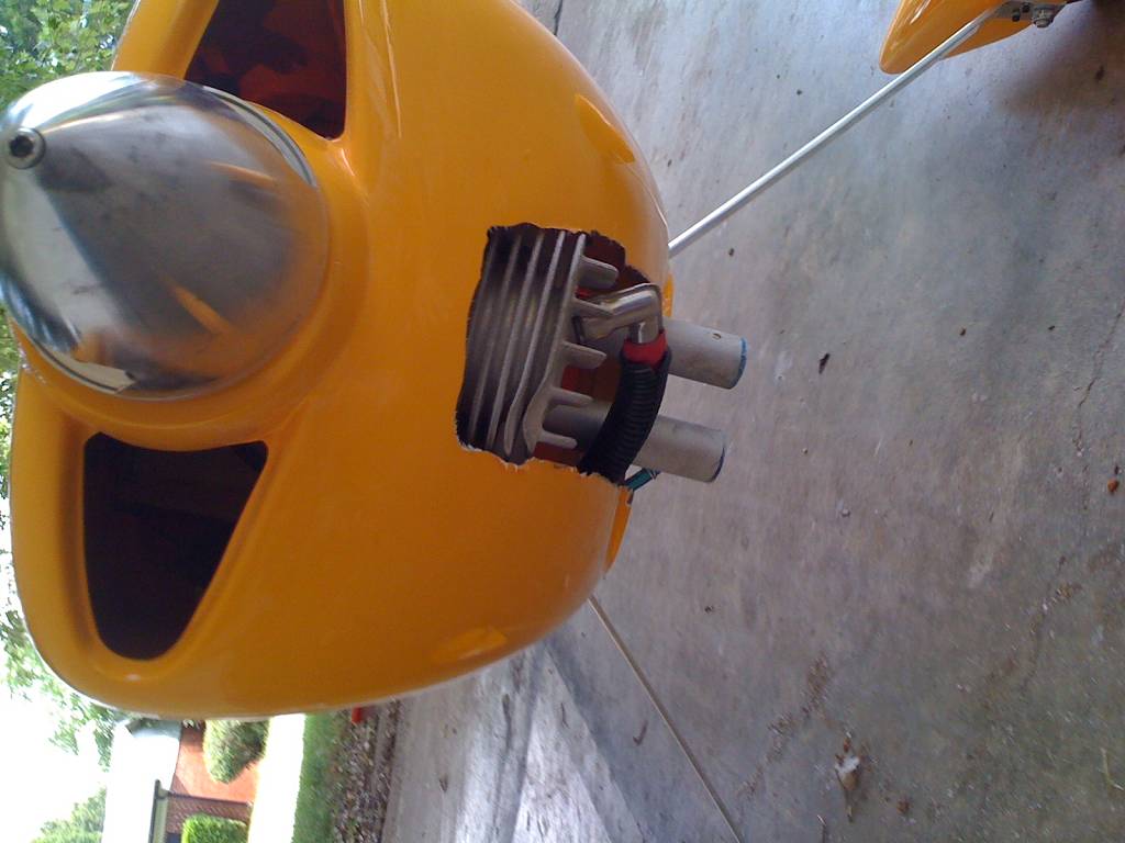

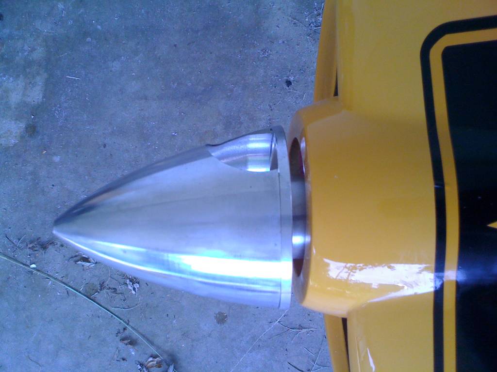

Well, I broke down and got the dremmel tool out today, and with great apprehension started cutting the cowl. Below are the pictures of the outcome. It looks like there is a slight offset between the back plate and the cowl, is this normal or at least withing tolerances?

You have the right concept with the poster board.
The offset is normal due to the right thrust built into the firewall.

Default RE: New Edge 540 T
Flyboy, you need more right thrust and your standoffs are too long, the spinner should be tighter to the cowl. And smooth out the edges of the cut out for the engine allow more room for the engine to shake a bit
