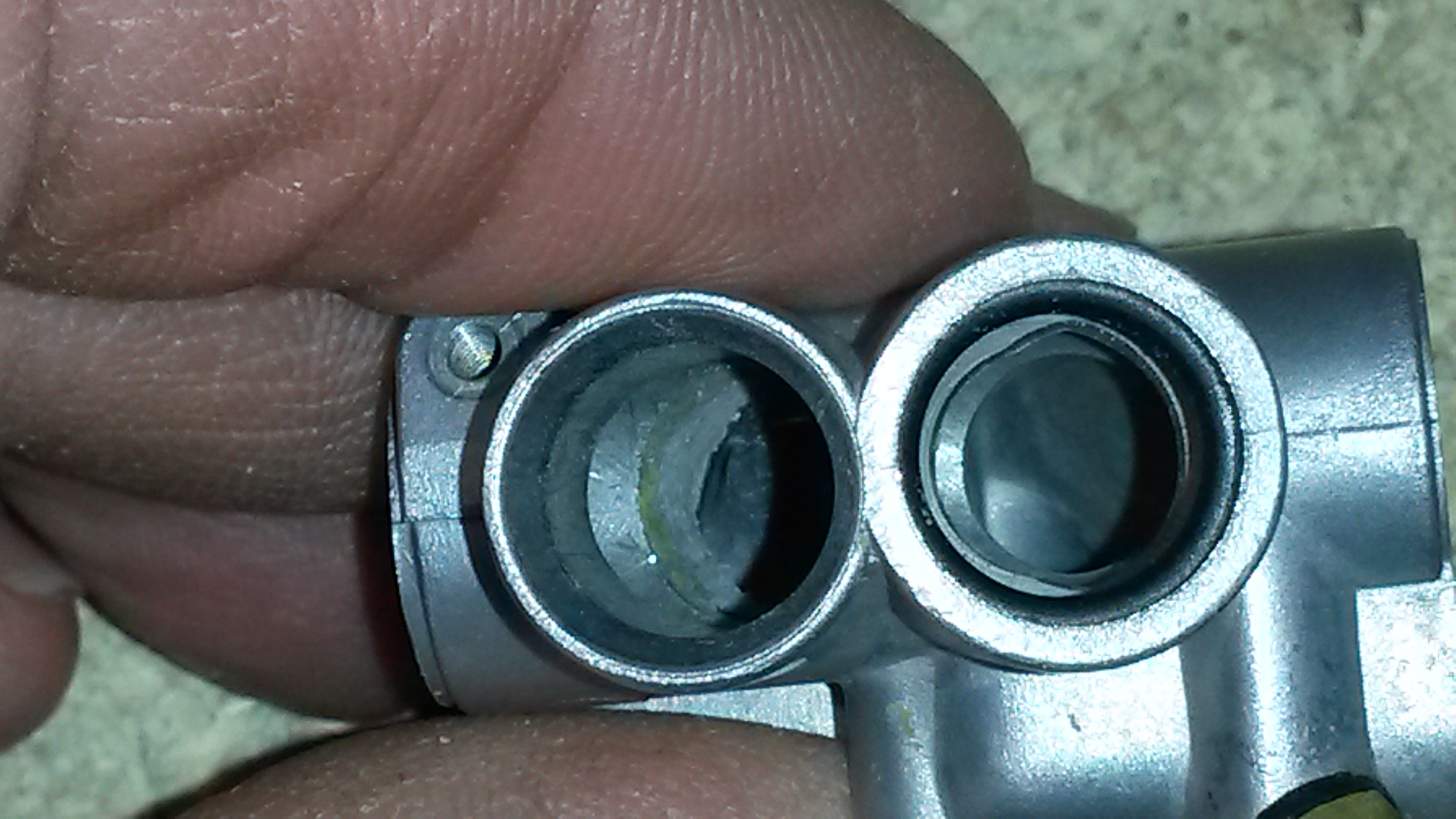

I think I may have found my squeak. See this thread for the full story. http://www.rcgroups.com/forums/showthread.php?t=1706494 Post 27 has photos of the pin hole. The hole I discovered returned after the JB weld "disappeared". I'll explore a couple of options before I spring for a new carb body.

I feel my first repair failed for two reasons. First I used the JB quick, which IMO, is not nearly as good a product as the long set formula. The second and I think the biggest reason is the repair was to small to effectively "grab" onto the carb body. I've been looking and dreaming a bit. I remembered a web site talking about high velocity porting on motorcycle heads. While I'm not going to do a port job I was inspired to try something. First a little modeling clay to test the theory and if that works then some more JB Weld of the long set variety. I'll post more when I get there. I feel at this point I've nothing to loose and if nothing else I'll have learned something when I'm done.

Well, here we go ready or not.........![Confused](https://www.rcuniverse.com/forum/images/smilies/confused.gif)
I put a dab of modeling clay into the carb body in the proposed location. You will notice how the clay will make a smother transition into the disc intake of the back plate. This has to be a very turbulent area. IF... I'm lucky, I'll gain a bit of performance in the process. My major reason for this is to make a larger chunk of epoxy. It will have more surface area to grab on to and if it does come loose it shouldn't go through the engine. I actually enlarged the hole through the backplate tolet a bit more epoxy through. Again more surface area. There was also a small hole in to the hole the bolt passes through. I opened it up a bit for another place for the epoxy to grab. I'll make a masking tape template to match the disc valve opening before laying in the epoxy. I'm hoping and am confidenr this will be one big mass when I'm done.

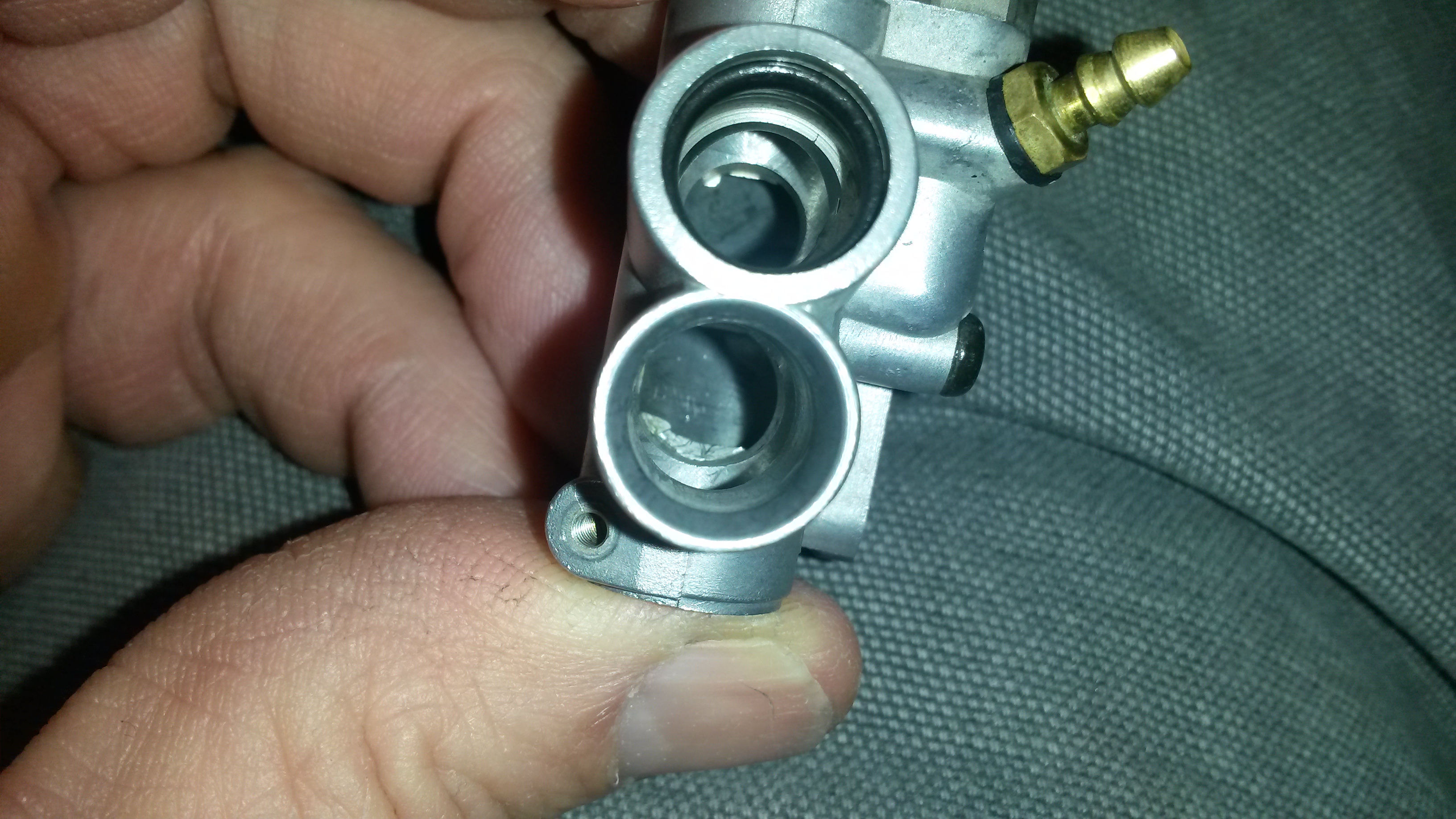

I think I have a viable repair. I was able to add one larger clump of JB Weld to the affected area. I think this will last as the long cure JB is a MUCH tougher product than the Quick JB. At least it sanded and filed much harder. Also with the larger clump there is much more surface area to glom on to. In addition I did a much better job of surface prep giving the carb body a good roughing up![Wink](https://www.rcuniverse.com/forum/images/smilies/wink.gif)
A bit of clay in the throat of the carb kept unwanted JB from finding it's way to places it wasn't supposed to and a dam made out of masking tape kept the JB where it was supposed to be. I mixed and applied the JB about 11PM last night and was up a 6AM to check on the progress. My work shop is rather cool so the JB was just a tad rubbery. It was easy to work in this stage so I roughed it out ans let it set for a couple more hours. I worked it a bit more to a bit finer finish and then the mess went in the oven at 170F for 3 hours for a "post cure". The oven was turned off and was left to cool naturally. The fun began as the JB had turned into a tough to work product. I had a curved file that worked pretty good for most of the process but creating the radius on the JB was an interesting process. I CAed some emery cloth to the inside of my curved file as it is a safe inside edge and that worked OK but the emery clogged pretty quick. I wound up running a strip of emery down through the throat of the carb and out around the bend and shoe shined it. The process was then tided up with the file in the places the shoe shine method didn't work. In the photo where the carb body and the back plate are side by side, you can see where the JB was added. A photo was taken of them in proper relationship but you couldn't see in the photo the match was near perfect. Hopefully this will not detract from the performance (I'm 95% sure it won't) and may even add a bit as there will no longer be as much turbulence in the airflow. Time will tell. Some of the photos aren't so good, I apologize for that but it's a bit hard to photograph such a tiny space.

Forgot to ask... I removed the rotary valve to work on the back plate and to check for damage by the previous hunk of JB that disappeared. I had a devil of a time getting the pin out of the back plate, yes I removed the set screw. I had to heat the back plate and drive the pin out. I massaged the pin for a light press fit. OK to the question, how tight should the clearance of the valve to the back plat be? I assume it should not drag but, how close is to close. Is there a spec?

Very interesting repair and awesome workmanship. We used to call the curved file you have a "riffler", but I don't know why. Please, though, let me loan you my Dremel the next time you do this; it should make the shaping, cleaning, and polishing a lot easier.

Thanks Richard! I have a Dremel. There is just not really enough room to work comfortably in that small space! I only have about 1 1/2 hours in the repair. To do it a second time would be less now that I know the tricks. LOL
