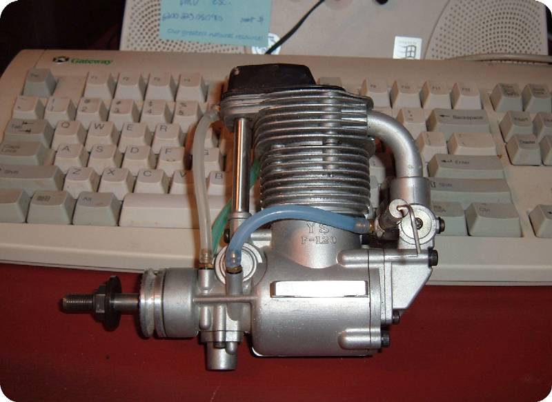

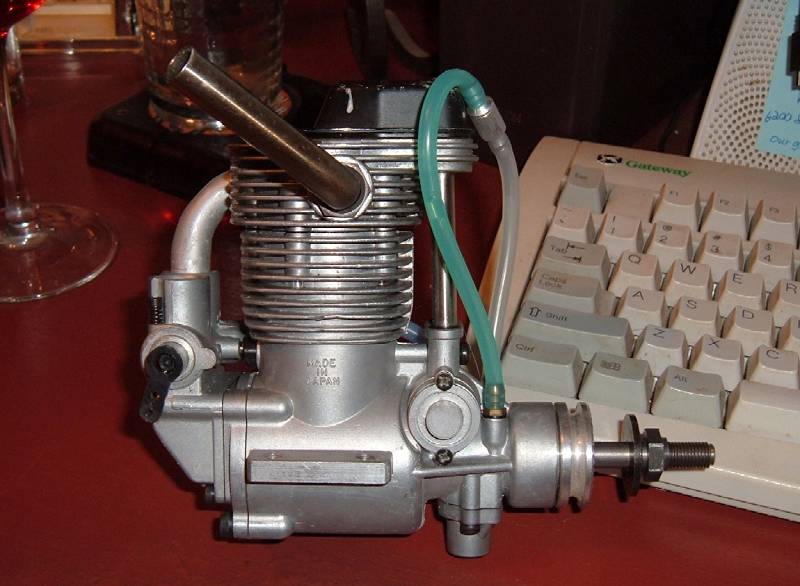

I have been tryin to ID this YS-120 for my brother any thoughts?
ID:	316425   Click image for larger version
Old 08-28-2005 | 07:08 PM
Posts: 5,385
From: Gardnerville, NV
Default RE: How to distinguish version of YS 120?
Either an NC or an SF. Need a shot of the rear to tell.
