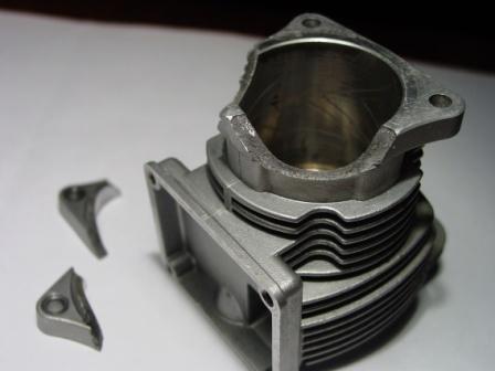

I solve my problems too, not nice but true, the cylinder has a crack and this was the reason why all my tuning was effectless.
Thanks for support..........

I have bought the 110 on ebay, I guess there was a fine crack as I get the engine, however I fly it
only one time without a crash.
But it´s nice to know the reason why..............
