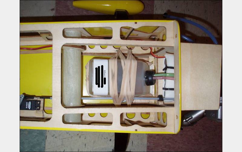

Hi Dave
still trying to run in and tune my 110.
Couple of questions....
I notice air bubbles in the dark blue line from reg to carb. This is at idle and up to about 1/3 - 1/2 full throttle. No bubbles observed in the line out from the tank or anywhere else. HELP!
Is it necessary to pack the tank in foam? I have mine hard mounted (see attached), and someone who saw it said "not good". Pls advise.
As usual, thanks a lot.
Blessings!
Albert

The bubbles are not a problem as long as there is no problems with the idle or transition. If you haven't used the setup instructions at www.ysperformance.com you should go there and try it. It is the easiest way.
Padding the tank is necessary if you are not using a Tettra type bubbless.
