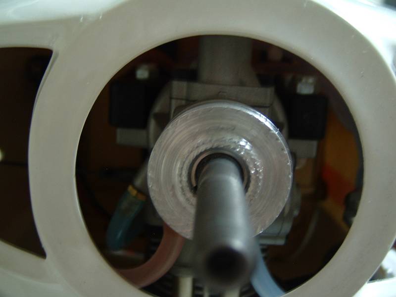

Looking for an explaination of what may have happened. I have a brand new YS FZ110. This is my first ever 4 stroke. Yesterday I took it to the field to break it in. I am turning a 14 - 8 APC prop. A 3 inch spinner with an aluminum back plate and plastic cone. Everything was tight with lock nut in place. High speed needle was set at 1 1/2 turns out to start the motor and then opened another 1/4 turn to richen up further once the motor started. I am using Magnum Fuels fuel that is 20% Nitro.
I don't have a safe way to bench mount this motor to do the break in, so I mounted to the plane and went to the field. This allowed me to use their plane stands and also have some more experienced people around in case I had questions. Everything started and ran REALLY well. I can't believe how strong this engine is just in the break in stage. Anyways, the instructions say to run it for 20 minutes. I was at 19 minutes and I was talking to one of the more experienced guys at the field when the motor ran out of fuel. You could hear the motor lean out quickly. I chopped the throttle to kill the engine. When I did this you heard a kind of pop. Everything seemed ok, I refueled and went to start up again. Using my starter something seemed to "grind" upon trying to start.
Upon investigation it seems that the knurled drive washer on the 110 and the knurled backplate of the spinner have spun. Both are worn down pretty good. Everything was tight upon start up including the lock nut. When we dissassembled everything the lock nuts were still locked tight. It seems that the drive washer may have not been seated fully onto the drive washer retainer and during the breakin, everything seated and caused just enough room for everything to slip. The guy I was with said he thought the engine backfired when I chopped the throttle. This is when the slip happened.
Question is, is there something I did wrong here? Will YS warranty the drive washer or am I going to have to suck it up and buy a new part and a new spinner?

Running the engine out of fuel is running it Lean!
You should never run any engine out of fuel. It can result in damage, as the mixture will go lean. On 4 strokes because they have so much torque they can spit the prop and spinner. In your case you are very lucky. Instead of the prop coming off and flying at you or someone else, the double jam nut protected you. It did not however protect the engines thrust washer.
The engine backfired and the prop slipped. This is common of the damage caused by a lean run. Hopefully there is not any more damage internally to the engine.
A 20 min run time is usually recommended before you try to fly the engine. 20mins of run time doesn't mean that it will run for 20mins on a single tank of fuel/ This would always depend on how large of tank you have.

Looking at the picture I think that the prop was probably slipping the whole time and the double-nut kept it from coming off. YS prop nuts have to be seriously tight to keep this from happening, much tighter than any other engine I have used.
A trick that I picked up from Dave a while back is to cut a disk from fine emory paper and put it between the drive washer and the spinner backplate with the rough side toward the backplate. This helps a whole lot- but you still have to tighen the x;!k!! out of the nut. Troy do you have a better trick than this?

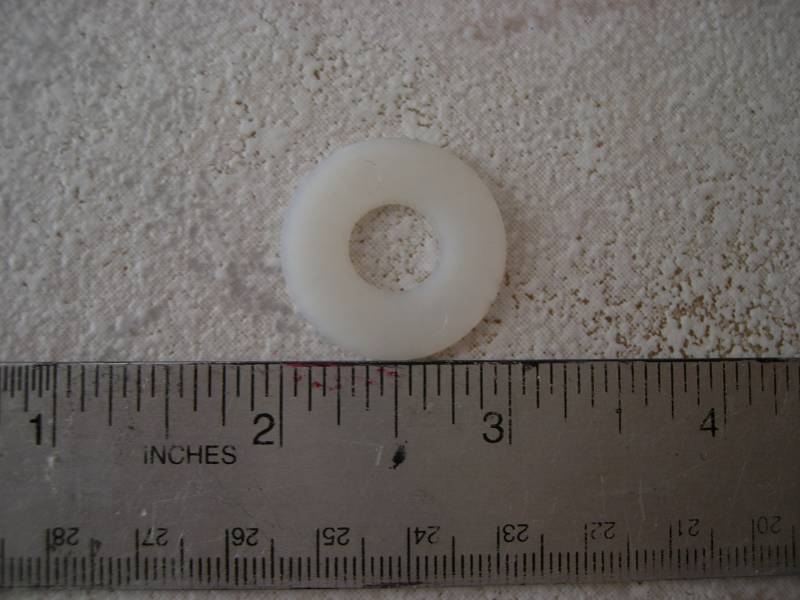

When having a knurled metal back plate I like to use a nylon washer (found at OSH) in between the back plate and the thrust washer. I tighten the nuts as you do. I also check the nuts for tightness every few flights. Since I started doing this my thrust washers have really held up.

Called Richard and he echoed what all of you have said. He is sending me a new drive washer. This is my first YS engine and I must say, I am very impressed with the power of the engine and I am also very impressed with the customer support offered by YS and Richard in particular. Thank you all, I have a few good lessons from this experience!

One more thing you might try that I learned after a couple of new drive washers and spinner backplates...
The emory paper trick didn't work at all for me, some great smoke from the drive washer/backplate area when I started the 110 and another ruined backplate and drive washer but that was it. What I do is start the engine, run it for a couple of minutes without getting too much RPM, then shut it down and tighten the prop nuts again. I do this three times with new stuff gradually increasing the RPM each run to full throttle on the last one, and then check after each of the first three flights. I'll generally get a little more tightening each time I do check them and I keep doing it until the thing is no longer slightly loose when I check it. Then I just check it every so often once it's tight.
It's just kind of a problem when you've got an aluminum drive washer riding on an aluminum spinner backplate and the pre-cut grooves in the backplate and the drive washer don't match each other, swinging a 16x6 APC prop in the mid 9,000 RPM range, but the power output of these little engines is just amazing. As you do these run-ins the grooves will actually get a little filled with aluminum on the drive washer and a slight wear pattern in the spinner backplate, this is what cause the looseness. Do whatever you can to avoid a backfire, but if it does happen, make sure you check the prop bolts immediately. It's a bit of a hassle and the drive washer won't look new anymore, but I've not had prop slipping problems since I started using this method.

I use the following procedure to tighten the prop nut and the lock nut, with a good wrench (about 6 inch long).
1. tighten the prop nut first, with left hand holding the prop blade and right the wrench, until the wrench can not move further
2. repeat the above step for the lock nut
Never had a problem.

I'm not familiar with the abbreviation "OSH". What type of nylon washer are you using? Is it a thin washer with a diameter the size of the props thrust washer?
A rough 60-100 grit Emory cloth type sand paper will work. I have also heard of some folks using a thin piece of Leather. I have never done the Leather thing.
The prop will only slip if you run it lean and it backfires.

OSH stands for Orchard Supply Hardware. They have a good selection of nylon washers usually. I believe they are usually sold in 4 packs, but I don't have the part number or any other information at this time. The outside diameter is close in size to that of the thrust washer, the inside is somewhat larger, I just tack glue the nylon washer to the thrust washer with a couple drops of medium CA to keep it centered. Once the backplate, prop, and prop washer/nuts are installed it will hold just fine. I have attached a picture as well. I hope this helps.

Thanks for the reply. We have no OSH's here in Georgia, but I'm sure Lowes, or Home Depot will have them. I like this idea if it works better than the emery paper and will give it a try.

Not everyone has them, but most hardware stores that have bins with different size screws, washers, etc are usually your best bet. These washers also work well with nylon wing bolts to spread the load so maybe micro fasteners would have them as well (or anyone who sells that type of item can order them for you). On a side note I've used them on both knurled and smooth back plates and they hold up well......even in high RPM applications.
Good luck,
