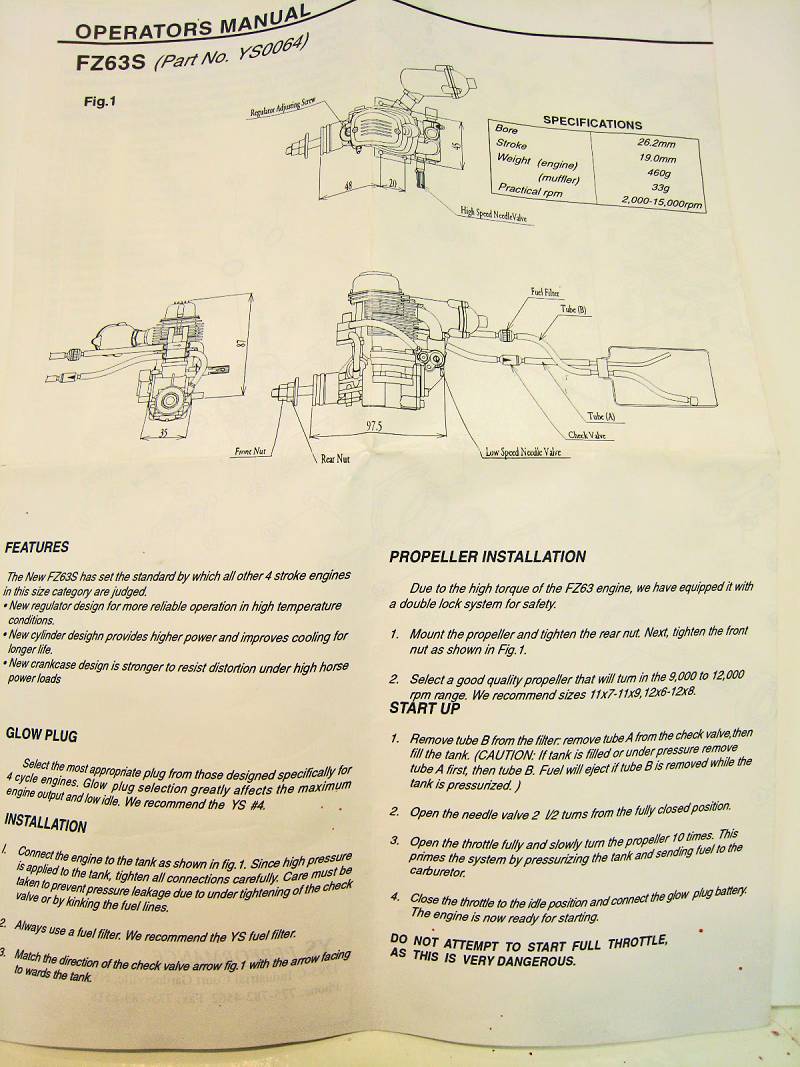

Thanks for the information. Any little bit is nice. But I was also thinking along the lines (Sorry I didn't mention it) about the overall dimensions of either the YS-63 or the YS-53 (if they are different) Like I mentioned above I am planning on getting these for a project and am curious about the room I'll have to work with. Overall height, width, length, possibly center of crank in comparison to bottom of crank case etc.
Edit: I know some of these dimensions are on the above post. But a main measurement I need is the center of crank to bottom of case.....and also wondering if in fact the 53's are the same measurements all around?

The 53 and 63 are basically the same engine. The motor was bored out to give the 63. Now the new 63S with the regulator no longer part of the case of the engine is a slightly different motor but its built on the same chassis as the original 53. 53's are no longer produced and have not been produced since about 1997-1998
Weights are the same or within a few grams.
This engine will compete in the power department with OS 70's and Saito 72's It will for the most part pull like a really strong 46-50 2 stroke engine. Props sizes will be slightly larger than the 46 2 stroke. 12-7, 13-6 is a good prop for the 63.
for specifics got to
www.yspartsandservice.com
and go to the owners manuals. Weights, bore, stroke numbers and such are on the owners manual page #1
Also
www.centralhobbies.com has information on the various engines on their site as well.

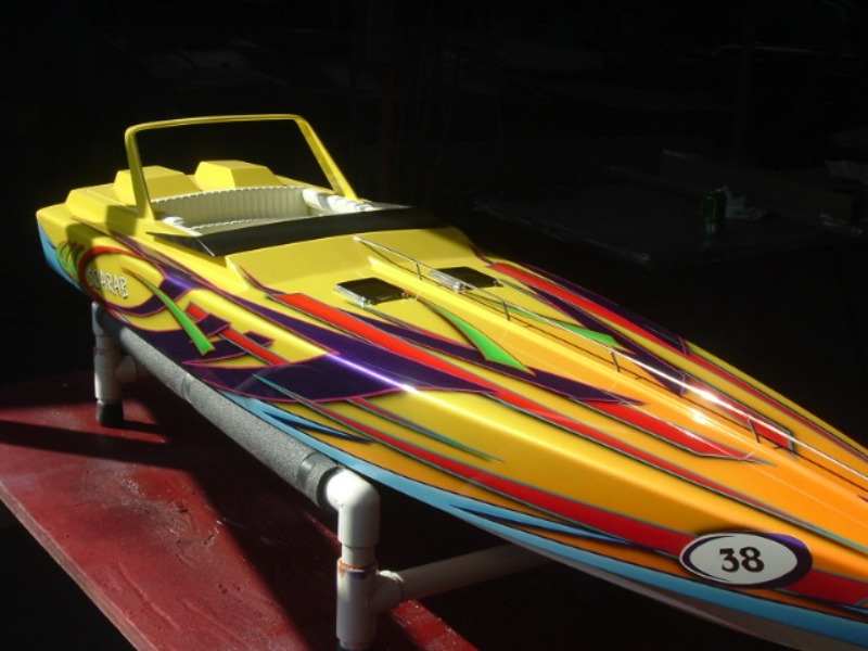

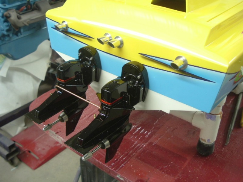

I understand the problem / concern about cooling the engines (it is my biggest worry) but I have done a lot of searching, reading, e-mailing, etc. and have ran into many people that have taken non water cooled nitro engines and made "cooling coils" out of copper tubing. Where they take small copper tubing and tightly wrap it from the cylinder base all the way up to the head, the cool water is either forced (suction from driving the boat across the water) or pumped (with an electric water pump) thru the tubing and "spit" back into the lake after it has cycled around the engine. This method has worked very well in each situation I have come along in my research. Obviously none have used this exact engine (or I wouldn't be here asking all these questions) So lets say IF I have the cooling situation under control??? I'm just trying to plan for any other "major" hurdles.
I also know that I have to make a custom belt start flywheel (obviously since I won't be running an airplane prop) I have a lathe and machinging skills (so I would pretty much copy / compare a similar sized marine flywheel and would adapt it to fit the YS)
Attached are a couple "in progress" shots of my boat (just so you don't think this is all a pipe dream)
Cool Paint work.

Thank you for the quick replies (very nice to have help!)
Thanks for the compliment on the paint (I own a custom hod rod / paint shop) so that's how I make a living, it is also what get's me into these situations.......CUSTOM.....I am never content or satisfied with anything normal or easy. I always have to be thinking outside the box, or a different (not necessarily better) just different way of doing things.
