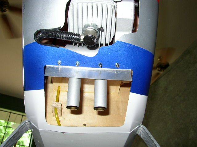

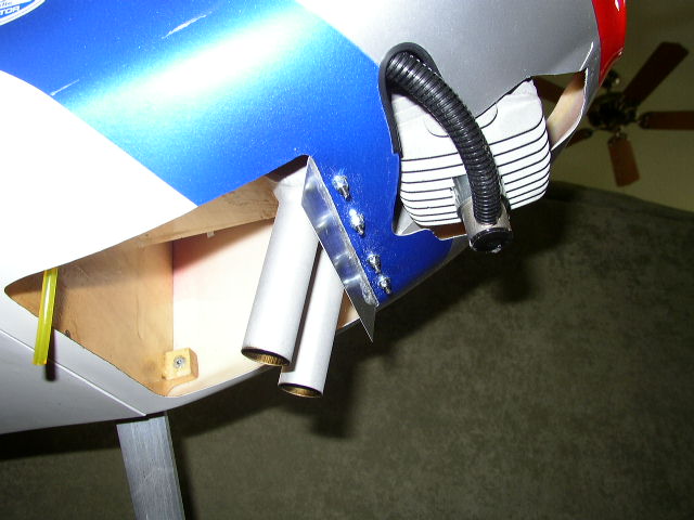

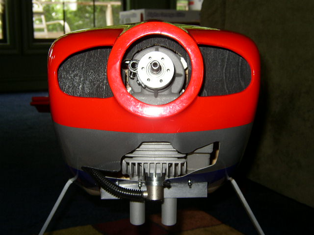

Here are some pics of my setup. Wondering what I can do to cool the motor a little more. I'm still getting temps around 220-225 after I taxi back and shut down (measured with Raytek gun and the "spit" method). I am burning 93 octane with 32:1 H1R oil. 2.5 gallons on the motor. Walbro carb, needles at L7/8 and H1.5. Getting around 6200 RPM with a Bambula 26x8 prop. Sounds rich in flight.
I would like to know what else I can do to lower temps. Retard the timing more? It's set at 6mm.
Thanks.

I went out again today. It was close to 90 degrees. The high needle is still at the starting point (1.5 turns out) and timing is set at 6mm (measured from the side web). I'm getting 6,120 RPM with a Bambula 26x8 prop.
The temp between the top 2 fins, front of motor, immediately after shutdown is 230F. When I point the temp gun inside the cowl at the bottom fins it was close to 250F.
I don't get it... what am i doing wrong here? Why can't I get this thing to cool down a little? Others say that they are around 210 for temps.

you just gotta take that full baffling out of the front of your cowl. You have got huge exit hole/ area but no flow through the cowl. It looks as though no cooling at all for the crank case and exhaust. The top of your cylinder is in the air flow but nothing else.
Just how it looks to me.
