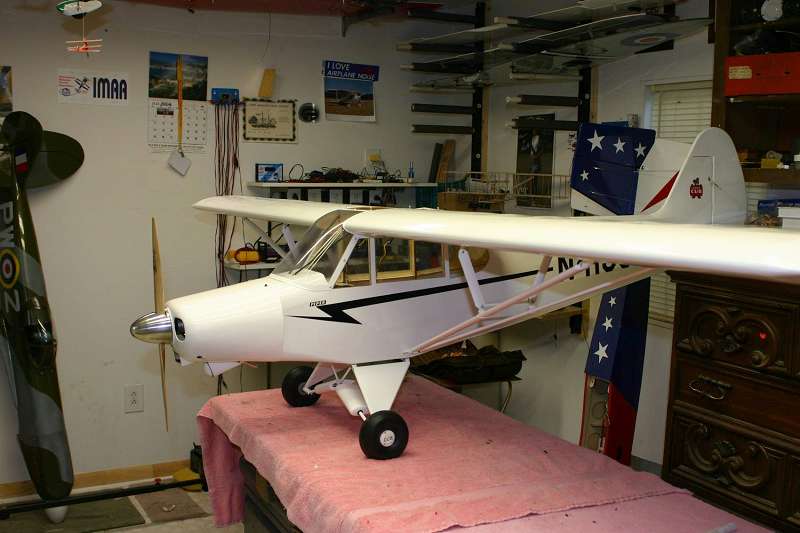

Just some comments:
Cheap hardware? Maybe the nuts and bolts, but there's Sullivan control horns and DuBro pull-pull stuff in the box. Everything that was in the box fit just fine.
I don't usually change anything on review models, but in order for me to attend and participate at IMAA events with the DP Super Cub, the 2-56 aileron and flap rods need to be changed to 4-40. Not necessarily for strength, just for the cockamamy IMAA rules.
The DuBro Cub wheels ay be foam filled, but the tread is rubber. The very light wheels in the kit, however, are solid foam.
The book says "...12.5 pounds and up...". I must have one of the "and up" versions. I weighed the airframe minus servos, engine, battery, etc. Just what comes in the box. It weighs 11.5 pounds. Show me a set of servos, and engine, a battery and a fuel tank that weighs 1 one pound.
I used an OS 160 twin (44 ounces with dowel stand-offs), an on-board glow lighter and battery (14 ounces) and a 5 cell nimh battery (5 ounces) Everything else is what comes in the box. Total weight of my plane is 16.5 pounds dry.
BUT, on the opposite side of the coin, the wing loading is 23 ounces per square foot. That's trainer-like.
Flying to be done when my pilot figure and instrument panel arrive.

More comments and answers:
THIN CA works fine on the joint between the stab and the fuselage. Don't go overboard because it may leak all the way through and come out the other side (No I didn't)
Find a drill bit (it's a standard size) that is just a bit bigger than the axke. Drill out one side of the hub, then the other one, not all at one time. It fits the axle fine.
The telescoping tubing may be painted shut. It takes a little oil to ge tthem moving.
Don't put the ailerons or flaps all the way against the trailing edge of the wing. Place them so you have the recommended travel. There will be a hinge gap, but this plane is slow and this gap won't matter anyway.

The dowel standoffs I used are just 1" hardwood dowels cut to the correct length, and drilled through with a clearance hole for #10 bolts that hold the engine to the firewall.
I added fender washers between the OS engine mount and the dowels to prevent crushing. The joint between the dowels and the firewall are OK.
BTW, the "correct length" depends on your particular plane. You have to measure the distance from the firewall to the front of the cowl, add 1/8", subtract the length of your engine and figure in the thickness of the fender washers.
The result will be the length of the dowels, more or less.
Here's some photos
Here's some photos
