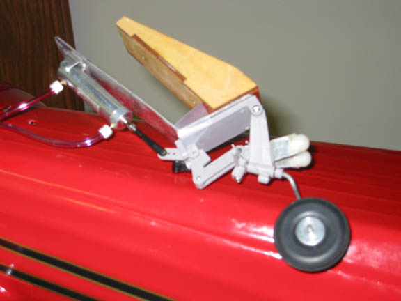

We used the ROB121 Robart Tail wheel Retract and the ROB165 Air Cylinder. An aluminum bracket was fabricated for mounting the cylinder to the tail wheel assembly and it slides into the existing tail wheel compartment. The only "simple" modification to the aircraft was removing the factory installed plastic tubing for the tail wheel rod that comes from the servo (the tubing, rod and servo are no longer needed). The pneumatic tail wheel assembly is a tight fit but works great and eliminates the need for a tail wheel servo and extra channel on radio transmitter. Let me know if interested in some pics of the pneumatic tail wheel project.
I'd be very interested in seeing some pics of your tail wheel installation. Please post pics and other needed details. Thanks!

Here are the pics of a pneumatic tail wheel retract. The brace holding the rudder and elevator push rod tubes had to be knotched out to allow the pneumatic line attach points to pass forward. Since the brace was compromised it was then strengthened with 1/8 Sig plywood as can be seen in the pic. Also there are two other points to consider. Notice that the tail wheel door hinges are not epoxied in but 2-56 screw and nuts were used. They were hinged in this manner to allow them to be taken off for ease of maintenance in the tail wheel hole. Also, the original method to open the doors on extending caused exceedingly too much friction and the tail wheel would not come down. Notice the pic where two round plastic buttons were used eliminating friction through the complete gear swing. The button can be purchased at Lowes.
Hope this has been helpful.

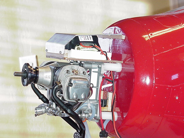

O.K. well thanks for the lurk:
So after getting the OS twin dialed in using a 17X8 Zinger, I actually had not even ballanced this plane yet. So placing everything as far forward as possible , receiver and glow battery right up against the firewall (drum roll please!) picked it up 5 1/2 from the leading edge (bottom wing) and that bloody tail dropped so fast it just about made a dent in the concrete. Weight 19 lbs. So not wanting to add weight to this plane, heres a pic of what I am doing.
Opinions please::: is the heat from the engine be a problem to the reciever battery ????

Our Staggerwing uses the OS 160FX engine and the battery enclosure is mounted 8 inches forward of the datum (the wings leading edge) and directly opposite the engine in order to get the aircraft CG on the forward side of the CG range. Digital scales and a spreadsheet program were used to determine aircraft CG (similar to weighing full scale aircraft) and the process works out great for determining how much weight needs to go where on any new build.
For our particular Staggerwing, a 4CP-3600CR rx pack was required (purchased from Maxx Products) that provided the proper balance weight in combination with the battery enclosure purchased from Newark Electronic Components. Extra long bolts were ran thru a J-TEC engine mount in order to fasten the battery enclosure. Additional openings were added to the port side of the mock engine and the bottom of the cowling was opened up even more to increase air circulation over the engine and battery.
Three ounces of lead were added to the battery enclosure after the last flight to move the CG closer to the forward limit and tweak flight characteristics. We hope to fly again this week to determine if more air circulation is necessary to keep the engine and battery properly cooled.
Michael
Michael

O.K. gang here's an answer to my own question: I recieved an E-Mail from Steve at Hangtime hobbies/NoBS Batteries: who I have build all my batteries (highly reccomended)
http://www.hangtimes.com/
""""Hi Denis
Yep... high temps affect any battery system. When the pack is hot, impedance is impacted, voltage is depressed, ability to accept a charge reduced, useable capacity is reduced, etc. Also worthy of consideration, vibration can pop welds, break down internal insulators and lead to catastrophic failure. Quickly.
Regarding the installation shown.. for an ignition pack, that may be a tentative 'workable' location with adequate airflow from cowl ducting, temps may be manageable, you should keep the pack below 120 degrees if possible, however 'cook off' temps after the engine is shut down are likely to put that pack into severe thermal stress. Something to consider on hot days; the heat from that engine is basically gonna cook that pack on the aluminum baking sheet you have it on. I see nothing in that pic that indicates any defense against vibration.. that's not good.
Outstanding metal work, though!
That is NOT a suitable location for an Rx/Servo pack... period. Ignition pack, maybe.. with some precautions as indicated above. But the Rx pack up there.... never. Too close to the ignition field, too hot, too much vibration. As an Ignition pack.. ignition failure; you are a glider. Rx pack failure.. you are a pile of sticks. Rule of thumb.. don't mount a battery pack where you would not mount a receiver.
Hope this helps..
Steve"""""
After reading that, my receiver pack goes back behind the firewall. Now I have to go find all my lead lead weights
Denis

As shown in previous episodes, my RX and OBG batts are mounted up on top of my engine - just like that. The big diff is that yours is a twin with the Cyls much closer to the packs than my single Saito 1.80......
no probs with mine - although I do have a block of lead under my plate in order to balance things out - it also keeps the direct temps down, too.
Good luck with ol' Porky! We've ALL been there, but those that haven't think theirs will be SO much lighter!!!
