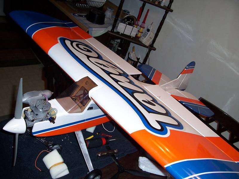

So someone had posted about putting an LA65 in here. I'm in the same boat, I've got a TT GP61 I was thinking about putting in her. If it's as tail heavy as a Twist, it shouldn't be a problem.

Weight wise, not much differance. Hanger 9 wants you to put in the NX .52. It is larger, but should fit just fine. I run a OS .46, and have to put the battery pack all the way in the front to have the CG in the mid range. I think it will be fine.

I wasn't as much worried about the weight as I was the mounting space. The 65LA is prety wide setting beside a 46 size engine.
Maybe somebody can chime in with the inside and outside dimensions of the engine mounts to see if mine will fit.

Length won't be any problem. The 65LA width is 2.437
Heck, that'll give me .063 to play with between cheeks. Thats about 1/32nd inch on each side. LOL

To mount the OS 55, one thing that has to be carved or modified some is a little dip on the top of the fusealge for the new OS 55 needle valve to mount in in the Tango. I used Sulivan yellow cable with a ball link and the throttle runs great through the factory installed guide tube. I'm ready to fly - 5 lbs 6 oz with all JR DS811 servos (had them sitting around), Spectrum full range 6 channel RX, 5 cell 2000 Nimh, and OS 55AX.
I ran the OS through the recommended break in. The 55AX starts easy, runs good, and like other postings, only 1 screwdriver blade width of low side needle leaner needed.

Just finished my Tango, installed OS Fs72. All up weight without fuel is 5lb 9 oz. I ballanced mine at 4.5 to 4.75 back from the leading edge of the wing. I will be flying it tomorrow providing the range check is good, i will give my flight report then.
