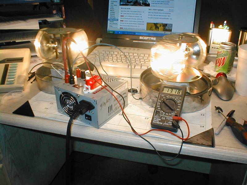

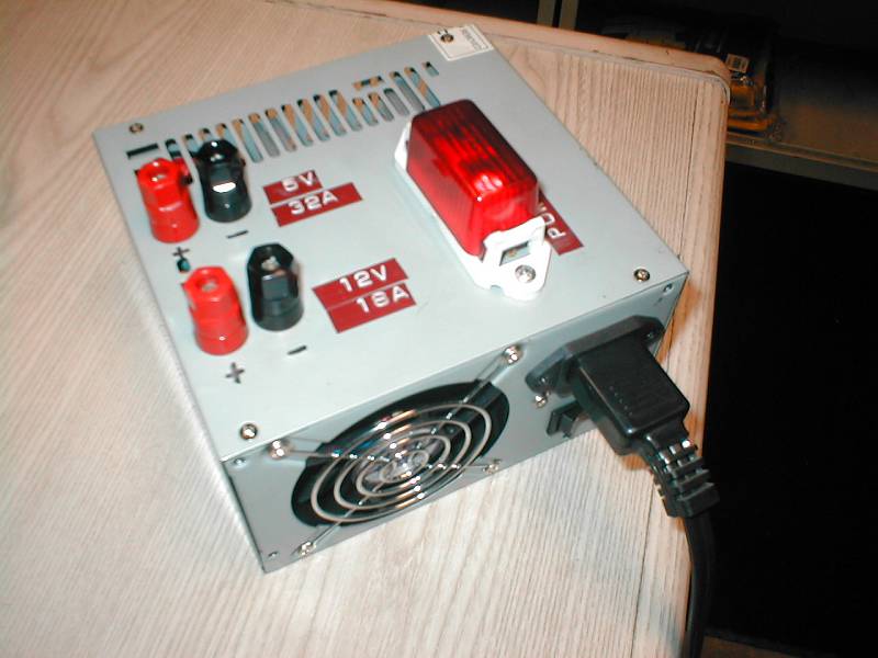

I converted an Antec SL300S for field use. I only used the 12V and 5V outs since my use will be my charger and for bench testing my receiver and servos.
I did find one glitch. I hooked up the 3.3 sense to the 3.3v out and the 5v sense to the 5v. In this configuration I had voltage but no current. I removed the 5v sense and it latched on perfectly. I also found that if you hook the 3.3v sense to the 5v out the 12v out will put out about 14.6v. However I just removed the 5v sense wire and left it undone. I placed a 12V marker light as a power on indicator on the 5v terminals.
I now have 13.8v - 13.9 at the terminals. The rating for this PS is 15A at 12V. However I have been running it under an 18A load and it performed perfectly with a 13.11V output.
I loaded it up with two beacon rotating lights (6.2A each) in parallel. As you can see in the picture the voltage never fell below 13.18V and it ran for over 3 hours and the fan voltage never went above 6.17. The fan is controlled by the PS circuit and will speed the fan up if the heat sinks start warming up, however it never got warm or sped up.
The lights will peak at 15A when first turned on and settle in about 13.4-13.6A. My field charger (Triton) uses a max of 13A. That should be quite good. I did load it up to over 20A for about 15 minutes with no problems and no overheating. Seems like a good project.
I also converted a newer style AT that works well also. However it was only rated at 8A at 12V but it will put out 15A with no problem.
Pictures are inclosed. The only thing I spent money on were the terminals and the $1.00 marker light. The PS was a pull out of my computer when I upgraded to a larger supply.
Thanks for looking.

Ok got it running, had to get the posts isolated from the case. Charging a lipo now at 5amps and its showing 12.02v on the meter. Good?

All back together, just waiting to see if I need another resistor but the one I have now is bolted under the top of the case, you can see the 2 screws where its mounted at. It is pretty much cold to the touch, plus the fan is right there blowing on it and in the rear of the PS is another fan sucking air out. I had some thermal grease from my pc upgrade so used some of that as well [8D]
Thanks for the help so far [sm=thumbup.gif]

Just picked up another resistor so will hook that up and see what volts I get then. One last thing, how do you guys measuer what amps your getting from the PS?
