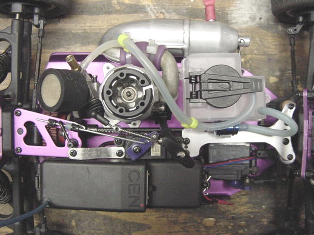

if the chassis is braced it shouldnt bend in the first place lol
ORIGINAL: cenracer1
Unless the chassis is braced, it can bend in the back rather easily..It can be straightened out by bending carefully in the opposite direction a little at a time until back in position.... The new era roll cage will help eliminate this as well as the jt chassis...

The attached picture shows how I stiffened the chassis a bit. I added a aluminmum brace between the trans mount and the throttle servo. The other mods shown are a TRX2.5 engine, LD3 pipe, and Ofna 125 CC tank. This is my first picture post so I am not sure if it will actually post without seeing it in the preview.
