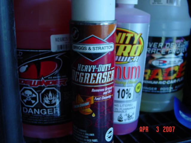

To remove the grease, try carburetor cleaner from Walmart or a auto parts store like Autozone. There are different kinds, so make sure you check them and get one that doesn't attack plastic. Carb cleaner is great, since it's cheap (much cheaper than nitro spray you get at the LHS) and it works better too.

For cleaning out diffs, I personally like to use mineral spirits. You can get this at any home depot or hardware store. The reason I like using mineral spirits over carb cleaner is the exact reason that Blitz had mentioned earlier, some carb cleaners are so strong that they may eat the plastics. The routine I have for the diffs is like this, I clean out one diff at a time, this way I don't have to worry about resetting the gear mesh between my ring and pinion gears. I generally just take the diff case off and pull out the six gears. Then I just put the gears into a little container of mineral spirits and get a toothbrush and start scrubbing away the old grease or oil.
