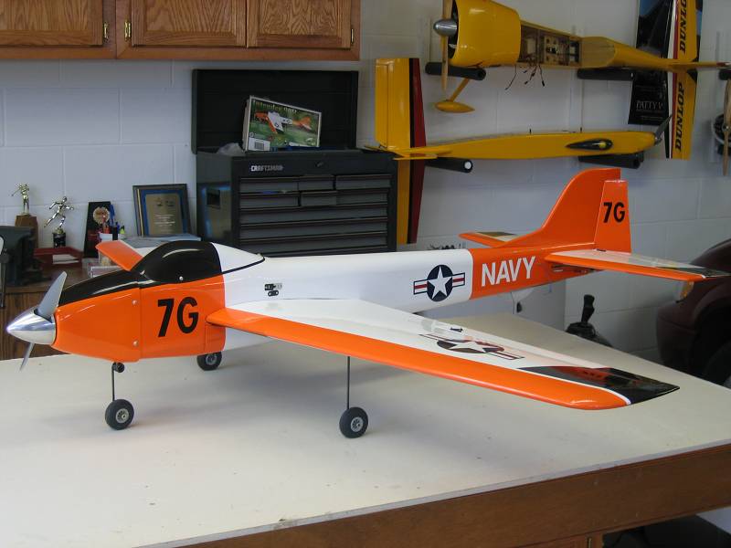

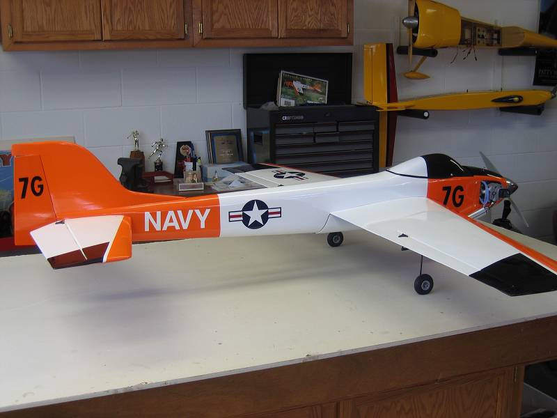

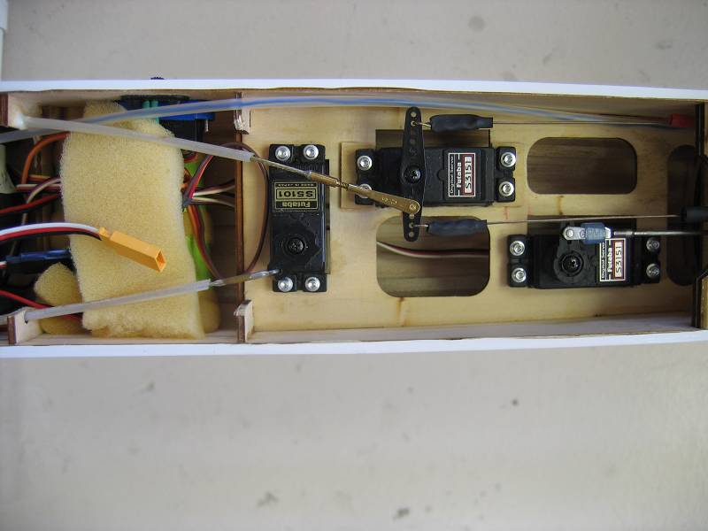

I have just completed my Intruder 90R. Very please with the assembly of the Intruder.
I am using an OS 91 4-stroke without pump & an APC 13x8 prop. The total weight of the aircraft is 6 pounds 14 oz. ready to fly. I elected to put the servos in the normal position and used pull/pull rudder. I will test fly with the CG back from the leading edge at root, 165mm. I have added no weight to the tail to get the CG to that position.
I used my own hardware, Sullivan, Dubro & Dave Brown Products glass pushrod for elevator with a Y at the tail.
Instead of using the decal sheet with the model, I elected to purchase vinyl cut grapics. I used Kirbys Kustom Vinly Graphics in Lebanon, Ohio and very please with their work.
