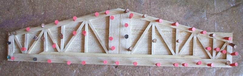

Till now I have been building wings using rib tabs. For this one, I have decided to make a wing jig. I have seen many variations, I have decided for this one:
The only problem was to find absolutely flat pieces of hardwood. Threads are made directly to the wood using a bolt and then screwing threaded rods.
I did not attach it to any base. Instead I put it on a flat table and check with Robart incidence meter that there is no unwanted wash out included. In this way I can make a wing in a living room and break those stupid stereotypes - that we spend all our time in the workshop or flying.

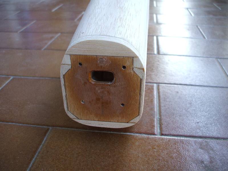

Wing doublers and triange stock are glued to the fuselage sides. I have inluded angeled cut to the sides (behind former 3) for belly piece.
I have changed a little bit shape of former 1, because I am planning to use MVVS .15 with rear exhaust and it will help me to fit it better.

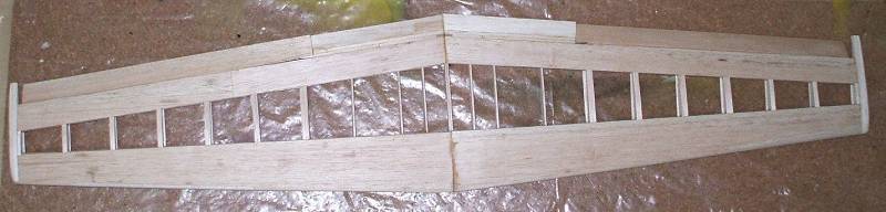

Elevator:
The plan calls to do it from balsa sticks 1/4 x ... . As I have mentioned before, in hot summer plants around our flying field become very hard as they dry. The very first landing on them would perforate the covering.
So I decided to use balsa sticks 5x5 mm (aprox. 3/18") and sheet it with 0,8 mm balsa (aprox. 1/32"). It is more work but no weight increase. If we had grass on our flying field I would done it as it is on the plan.

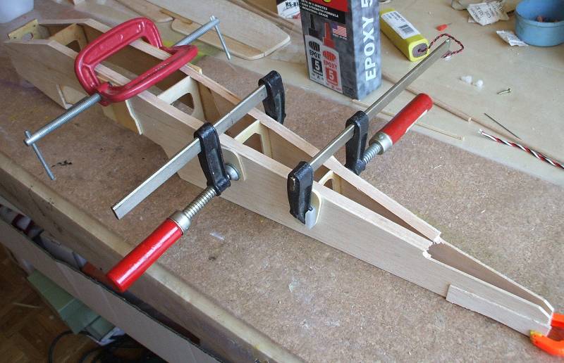

Fuselage:
I have finished holes (in F2) with the wing on it´s place to make them fit exactly dowels.
Formers 4 and 5 are glued on their place.

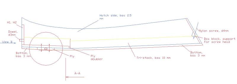

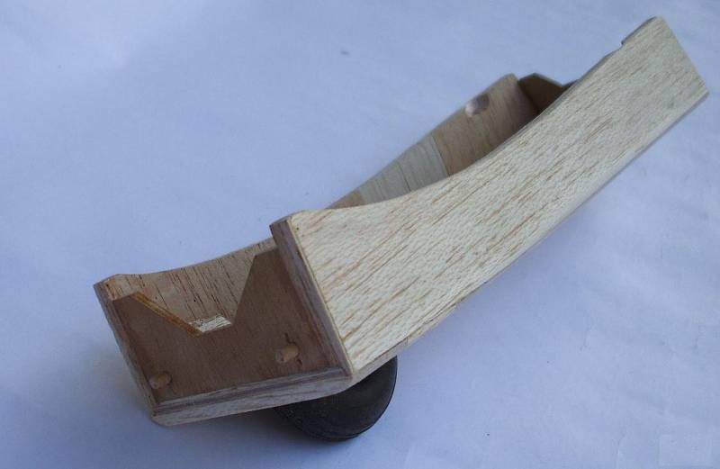

Hi,
Lot of work, lot of sanding, but not so much to show: I have finished the front part.
I have included removable hatch because it will make instalation of battery and fuel tank much easier. It is hold by one dowel in front and two screws in back. It is still missing a muffler cavity but I will make it later.

I have changed a little bit the design of the hatch.

I have finished the hatch. It is hold on it´s place by two dowels in front and one nylon M4 screw in back. Now, looking at it, I think I could put two screw instead of one. Not a big weight difference, but I will not change it anymore.
