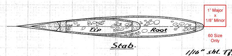

I have a 300dpi tif of this plan and was trying to figure out the thickness of the wings, stab, and fin. Couldn't figure it out until downloaded your 60 sized plan and realized that the plan was drawn on 1" graph paper. Totally missed that until now.
The thickness of the root stab is about 1" thick. I included a pic, and outlined a 1" square in red. Oh yea, this is only for the original 60 sized plan. The 10 sized plan has 5/8" squares.
Bryan

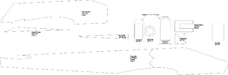

Good work on scaling the Tiporare plans...
Flew one back in the day, so decided this would be a good one to add to our short kit collection.
Attached is a JPG showing the parts I plan on including in the short kit. This could change, but these parts are the plan. Small part count, but this is a job for a good planer and sander...
Foam Wing and Stab will also be available separately or as a combo.
If there is interest, I will also do the smaller sizes. Just ask...
I will have pricing up on the EAC site within a couple of days.
The Curare and Atlas short kits are about ready, also...
