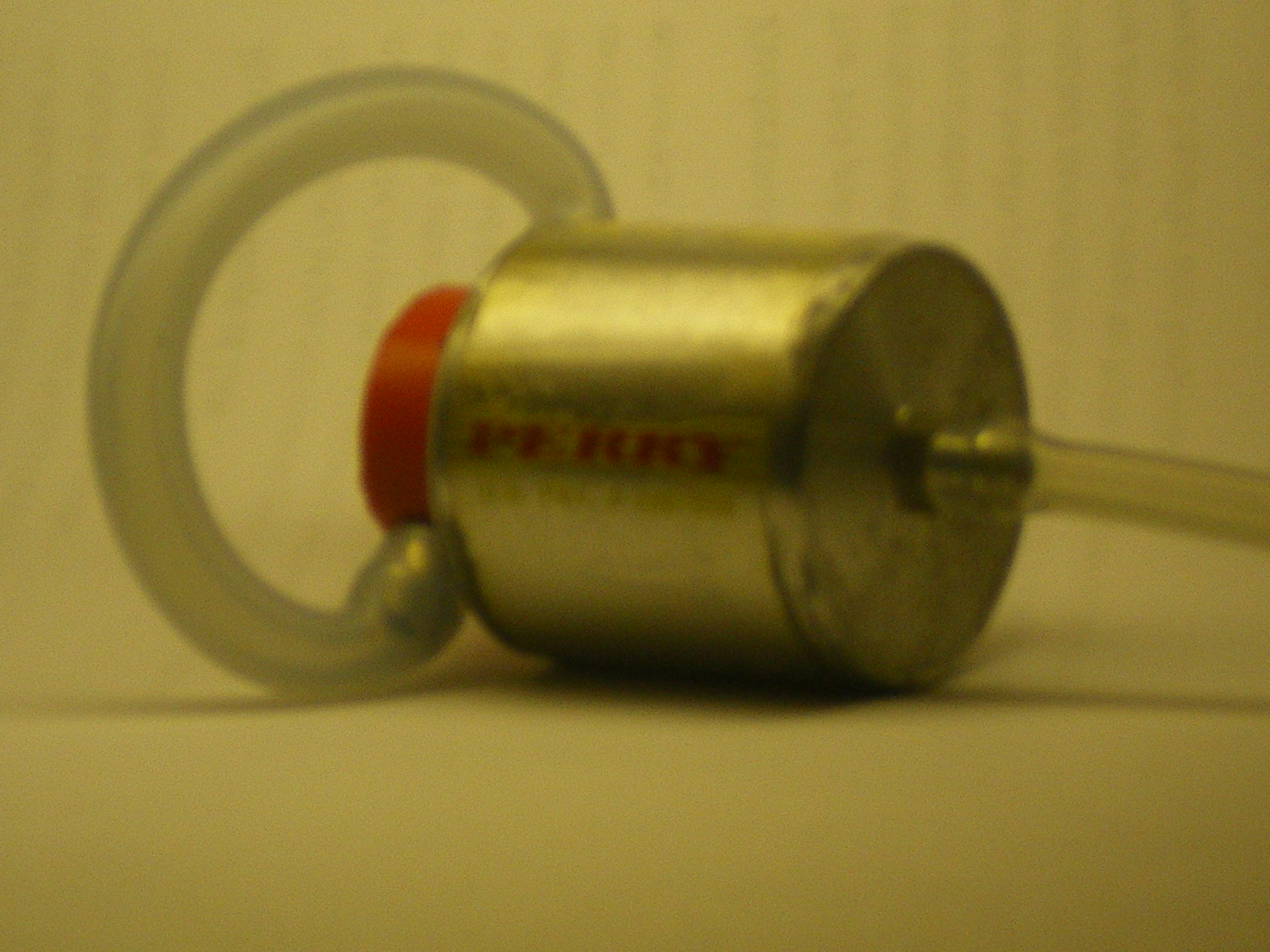

P30, V20? Guys I thank all of you for your help, but now I'm not sure what I have. One question that does not seem to get answered is how does this pump operate? How does it connect to the engine? The plane that is going to be used with this pump or a different one are to be used for patten flying and not hovering. Thanks to all.
My Feedback: (180)
RE: Perry Pumps and regulators
Lazer,
The single line in you photo that isn't attached to anything is the "pulse" line. It is connected to the back-plate of a two stroke. The pressure and vaccum of the two stroke piston moving up and down actuate the pump diaphram. The other two lines (connected to each other in the photo) are "In" and "Out" fuel connections. There should be an arrow indicating flow. Mounting is up to the installer. The pumps come with a strap to mount to the engine mount, fire wall etc.
Because the four stroke doesn't have the pressure/vacuum/pressure/vacuum cycle like a two stroke has, the pump you have wont work (well). Perry makes the "shaker" version which uses engine vibration to actuate the pump.

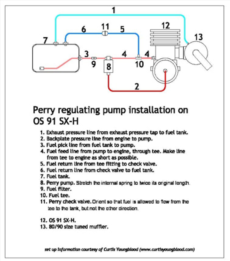

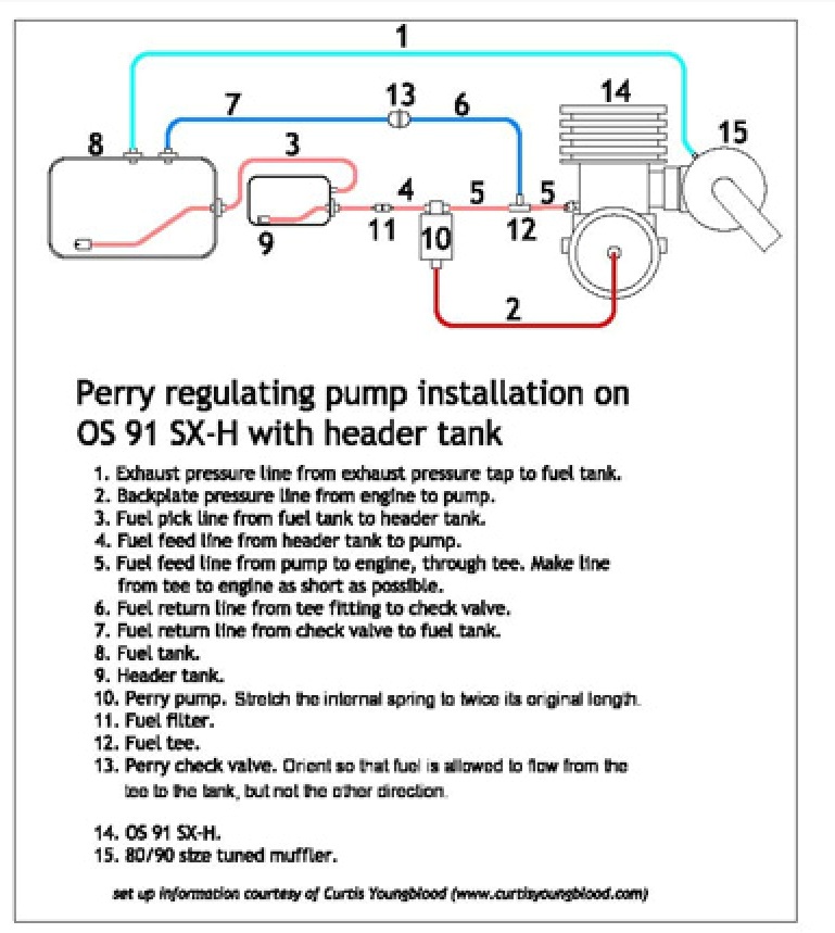

I did find some interesting pictures on Internet, with and without a header tank
This is for a two stroke!
1 Lay out principle
1A Flow scheme
2 Lay out principle with header tank
2A Flow scheme of lay-out with header tsnk
Cees
Edit: Don't use tank pressure!
1 Lay out principle
1A Flow scheme
Cees

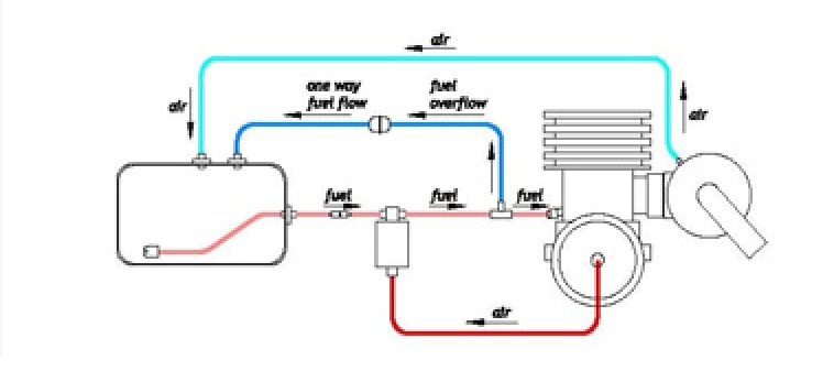

KLXMASTER14/Robert.
I understand your post and I did find these pictures but do not use them myself.
I do use a constant tank pressure and a second pressure controller near the carb (like Cline) and that's oké for me.
When I see the pictures I would change the system as I show on the scheme of this post. So without tank pressure of the exhaust
The double vent line to the unpressurized tank probably gives a barometric pressure near the checkvalve outlet, one of the two lines has to be filled with air, the other is for retour of fuel. It does not matter which for what
The checkvalve does have a nearly constant pressure on the inlet side and that's also the fuel pressure on the carb inlet side, and that seems to be alright.
It has to be a checkvalve with little spring force to close the valve. The surface of the valve (A) and force of the spring (F) does make the constant fuel pressure (P).
The checkvalve mounted near the carburator!
It still is a study picture, so not prooved by me.
Cees
Edit : added some text details after second post (A) (F) (P).

In my scheme the checkvalve is used for constant pressure, not to prevent the carb sucks fuel from the ventline!
The flow of the pump always has to be more than the engine needs, the checkvalve reduces the pressure a little above barometric pressure.
The principle is the as the threshold voltage of a diode!.
Cees

Gents,
Maybe my scheme of post 13 is a solution for bleed air, single needle valve carburators! (This is Classic Pattern Flying)
These carburators normally do not work with fuel (pump) pressure.
When I have time I will give it a try on my Orion with ENYA 60 4C engine!
Cees
Edit, Jeff I did not read your post when posting this one, you are also right, w'll see!
