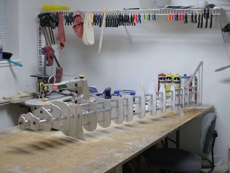

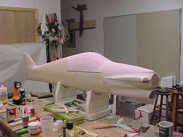

This isn't anything all that spectacular, but it is my first composite project of any size. Up to now my largest project was a rocket powered flying wing which was a one piece composite wing/lifting body about 3' in span. But mainly I have only made canopies, cowls, landing gear, stuff like that. So I'm not totally green, but I still consider myself a novice on this stuff. So I'm looking for any tips, suggestions, etc. anyone might have as I progress.
This is a 2M pattern fuse of my own design. It is loosely based on a blend between a PL Prod Excellence, PL Prod Smaragd, and Oxai Pinnacle. Designed in Autodesk AutoCAD 2004. Fuse without canopy and chin cowl is shown.
I printed out formers at certain stations on a large format laser printer. I then spray tacked these to 1/4" aircraft ply. These were cut out to shape. Holes drilled in the formers to accept 1/2" conduit. Formers were then assembled on the conduit, squared and aligned, and bonded to the conduit with CA. Nose ring was bonded at a 2.5 degree right thrust offset.
I decided on the conduit as opposed to other tubes because it is only $1.79 for a 10 foot stick. It isn't exactly the straightest stuff on earth, but I managed to find a few good sticks at Home Depot (I think the help thought I was nuts as I was checking dozens of tubes to find the really straight ones.) To help ensure I didn't get a twist, I made guides that I bolted to my building table to force all five tubes parallel to each other when bonding the formers.
Formers are cut 1/4" undersize. I plan on sheeting this skeleton with 1/4" balsa, then glass, prime and sand, hence my plug.
Others that have made plugs this way, look OK so far? Thanks in advance. -John

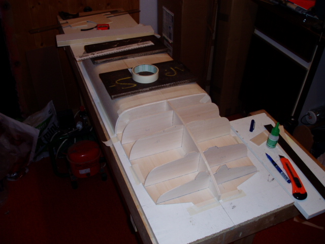

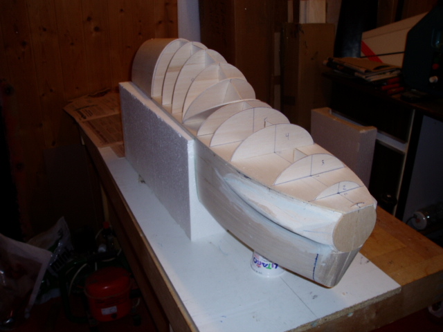

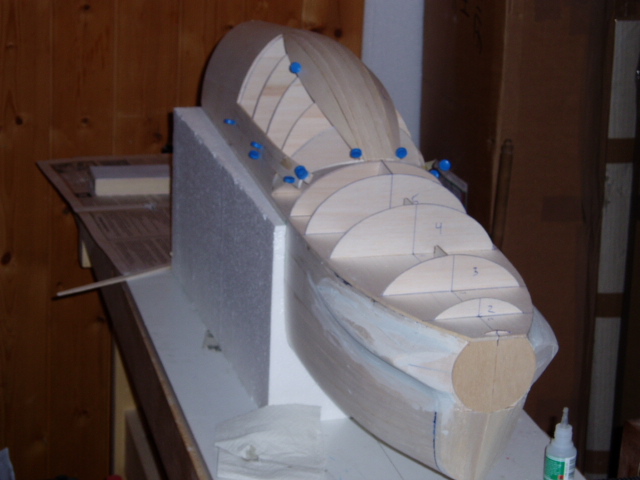

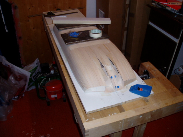

Old 03-14-2006, 08:57 AM
Magne
Join Date: Mar 2004
Location: Moss, NORWAY
Posts: 498
Default RE: First Large Plug

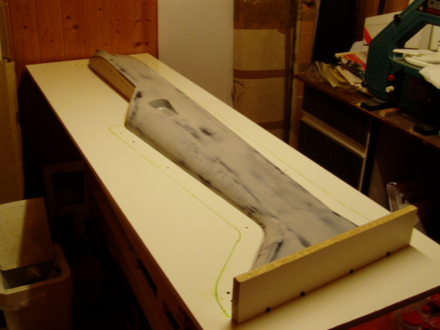

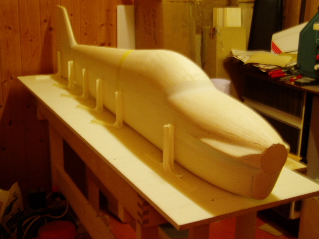

Hello John.
Yes, making a fuselage plug the way you describe it is quite feasible.

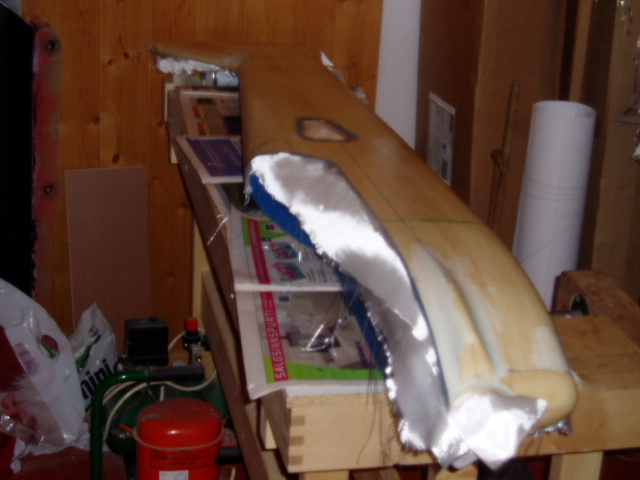

I only made the front part of my plug with planked formers, the rear part was made with sections of hot wire cut foam blocks sheeted with balsa. (In principle the same method as you use to make foam wings. Most of my plug was made in two halves, i.e. left and right hand side, and glued together before glassing. The whole plug was glassed with one layer 6 oz cloth and one layer of 2 oz cloth, applied to one side at the time, overlapping at the top and bottom.
I have enclosed a few pictures of my process.
Regards,
Magne

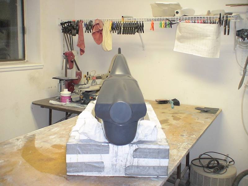

Old 03-25-2006, 02:53 AM
JohnW
JohnW's Avatar
Join Date: Mar 2002
Location: Lincoln, NE
Posts: 1,815

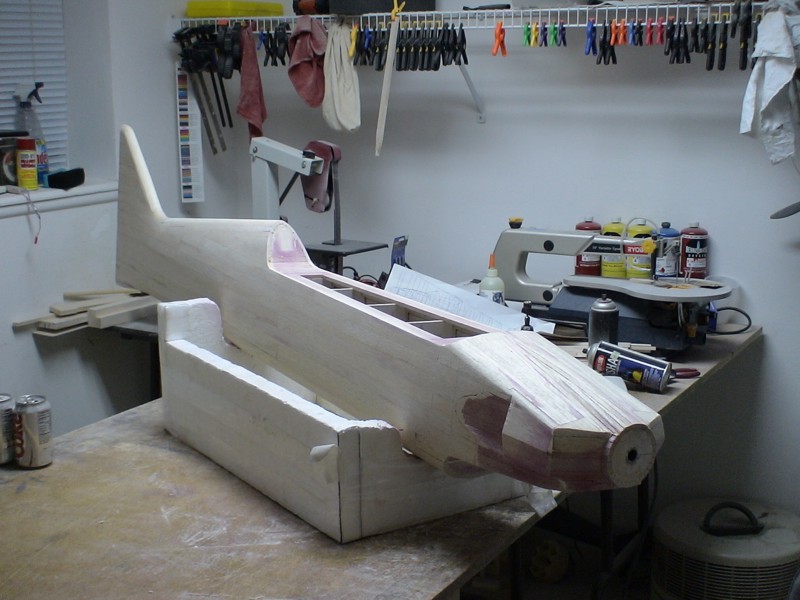

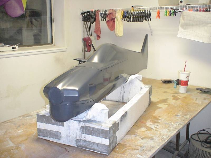

I must be doing something wrong when I'm working on foam without sheeting. I have made plugs without sheeting, i.e. just glassed foam, but I seem to fight them. My main problem is that they seem to deform too easily. I was hoping the balsa sheeting method I'm using now, while possibly more time consuming, would ultimately work better for me. I do want to try the former/foam/tube method on my next plug. Maybe all I need is a bit more experience to get the hang of plug making from foam.
Anyway, here is a pic of my progress to date. The fuse, less canopy and chin cowl, is sheeted. I splattered some spray paint on the whole thing as a sanding depth guide. First sanding is mostly done, less some areas around the nose. If this doesn't work out, I can always use this plug as a bongo. When you give it a thunk, it rings with a really nice tone.
Cheers

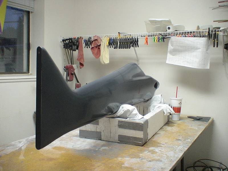

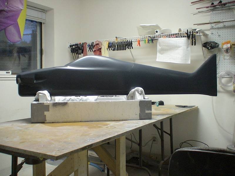

Made some more progress in the last several weeks.
In the last photo, I had the entire frame sheeted. I've done a lot since then. I trued the plug with t-bar sanders loaded with 80 grit and a lot of bondo. I kept sanding until guide coats indicated no more low spots, etc. I used about 2/3 gallon of bondo and 15 sheets of sandpaper in that process.
I then glassed the plug with 8oz plain weave glass. Epoxy was post cured at 150F for 4 hours. Weave was filled with Evercoat Easy sand (polyester filler) and wet sanded with 120 grit until my guide coats indicated everything was true.
There were a lot of fiddly bits in the above process, everything from symmetrical verification to getting hard 90 degree corners where required. Lots of apply more filler, sand and repeat about a zillion times.
I primed 4 coats with PPG Omni 282 high build urethane primer. This was wet sanded with 180 grit on t-bars until the guide coat was gone.
For the final finish, I shot 6 coats of PPG Deltron 3057 over reduced for better laydown, and 10 coats on outside corners. Then I wet sanded starting at 320, then 400, 600, 1000 and 1500 grit. Then buffed with polishing compound.
Still have a few minor issues to attend too before I can wax, such as rudder exit guides and I want to mark reference dimples for wing tubes, adjustors, etc., but basically the plug is 99% done.
