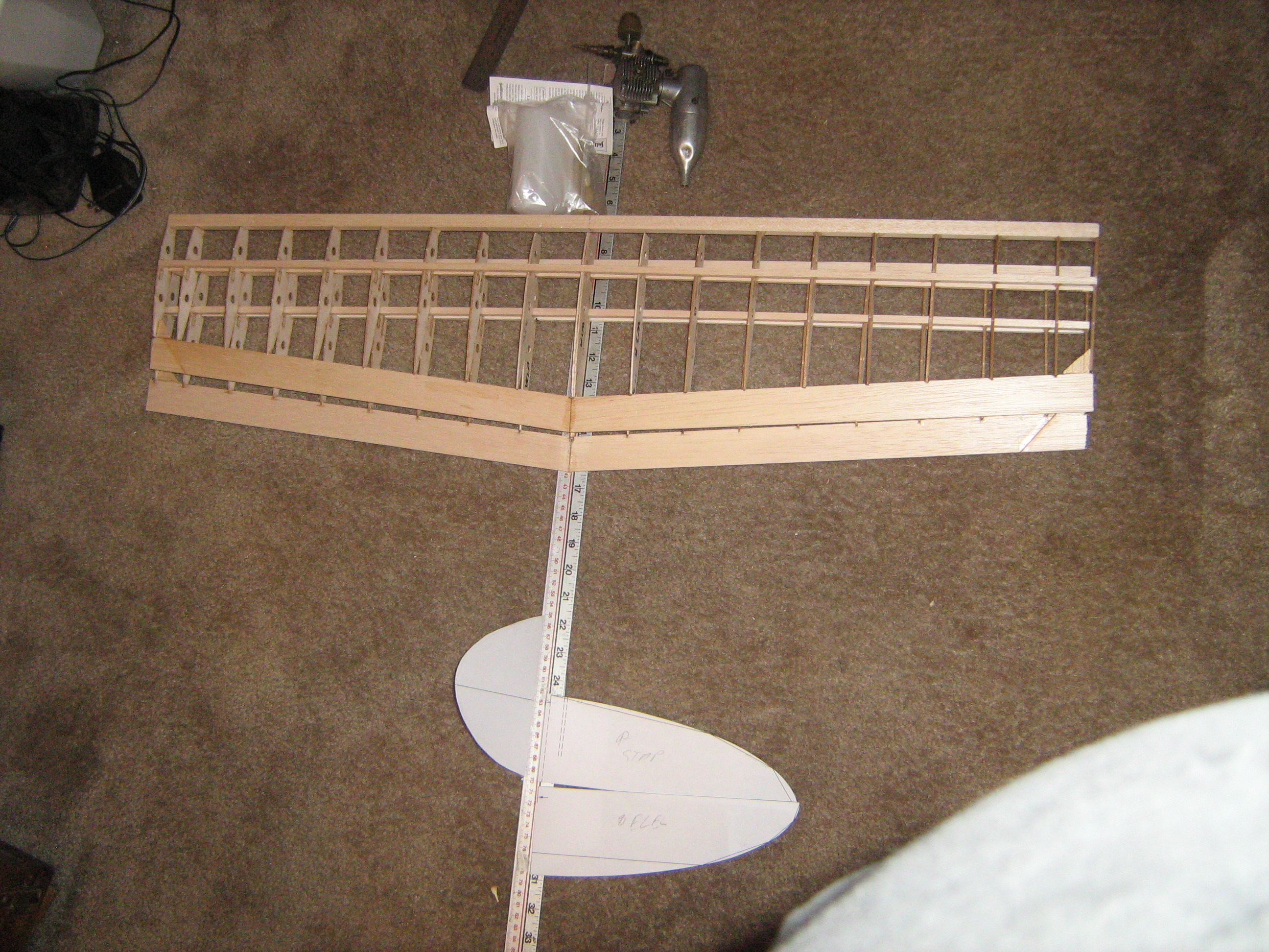

Starting to lay out parts placement, so I can draw up my fuse. Just going to be a rough drawing.
I started by printing out the tail feathers. I have downloaded a PDF of a RM 19. it has 230 square" of wing. So I needed a little more than double the stab area. I had calculated that if I printed it out (the stab) at 1.45% I would end up with about 84 Square" or about 22% of wing area. So that is what I did and I actually ended up with 90 square" close enough. I will cut the tail feathers from 1/8" sheet balsa. So the stab is 6.25 wide at the root and 18.5" long. The vertical is printed to the same scale.
I naturally want this thing to balance with very little to no lead added. I will be able to shift the engine some while the fuse is still roughed in. I do not have enough parts finished to hang them and see where the cg ends up at and the shift. So going with my best guess and past experience. The cg could be off by this method. We will see.
The engine is a Super Tiger .34 rc @ 12.8 ounces with muffler. Same weight as a OS .35AX, 2 more than a .25. I will likely use a 11x5 prop.
So here is the placement measurements.
I am referencing everything from the back of the prop.
Prop to bottom wing L.E. =8.5"
Wing stagger will have the top wing L.E. 1.5" forward of the Bottom wing L.E.
Prop to Stab L.E. will be 25" and T.E. of bottom wing to stab is 8.5"
Prop to T.E. of elevator or fuse end is 31"
Ready to cut tail feathers now.

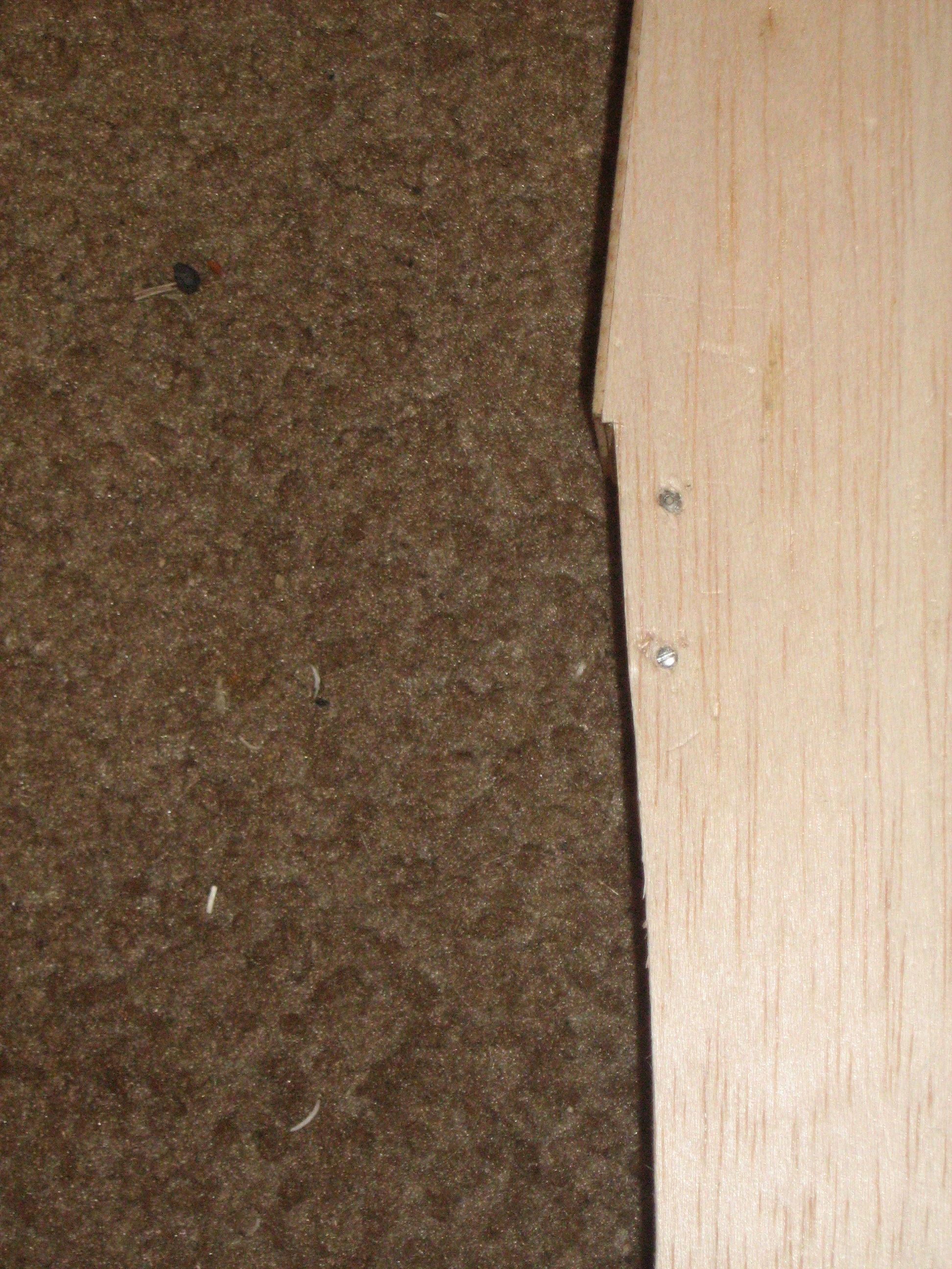

They say confession is good for the soul, they also say measure twice cut once.
So I have a confession. I did not measure twice when I laid out the elevator. Not sure how I goofed up like this. The template was printed out for one side. I then traced it onto the wood flipped the template and did it again. The stab is correct, but I sure screwed up tracing out the elevator.
So the elevator is scrap. It might find it way into a bulkhead or something.
And I was so proud of myself for only using one sheet of wood for all the tail feathers, stab, elevator, vertical stab, and rudder.
Oh well I will cut another.

It was suggested that I glue the scrap piece back onto the short elevator side.
So after I got home from work I went into the workroom to rummage the garbage can AND AND AND the garbage can IS MISSING!!! So "hey Hon where is the garbage from the work room?" She had switched out the can for a bigger one and not put the new one back. (Is she trying to tell me something?) So anyway I found the scrap piece. The cut was fairly clean but proud of the line (cut slightly bigger), and the elevator has since been sanded to final shape, But the scrap piece is still close enough I can make it work.

Some of the ribs trailing edge end were a bad fit. Some were under size, some a near prefect fit. Numerous ribs were considerably thinner than the trailing edge stock. Not all though. And I forgot that the inner 3 ribs had to be sheeted with 1/16" center section sheeting. I needed the trailing edge, leading edge and spars to be 1/16" proud of the ribs.
First I addressed the ribs that were to low. They were only low at the rear. I basicly cap stripped them with 1/16" by 1/4" wide strips. This made then a little taller than the T.E. Next I trimmed the cap down to the width of the ribs, 1/16". Followed by some careful work with a sanding bar to make them flush. It worked pretty good I think.
For the center section I made a marking block or gauge. Just two pieces of 1/16" scrap sheet. It basically is a cross with the one piece glued on top of the other. Lay it on the ribs and start marking. Then a bit of careful whittling and sanding made the 3 center ribs ready for center sheeting.
Now that I have a band saw I wont run into these problems again. I will just make to templates and stack cut the all at once. It was just to hard to make template ribs with a coping saw.
But problems solved.
I I have only dome one wing, the one that is going to be the bottom wing. And only one side at that. This is time consuming. The top wing has on additional problem. The trailing edge stock is not perfectly square with the wing. It is at a bit of an angle. I made it first, and tried to align it with a gauge. Thought I had it. But on careful siteing down the length I found it to be misaligned. The bottom wing I eyeballed into true. Got it right. I will have to cut the T.E loose on the top wing and realign it. Then I get to spend a few hours fixing rib fit on it also. I am only doing the center sheeting to the top of the bottom wing and then to the bottom of the top wing for a while. I have mounts to install in the centers. For 6/32 wing bolts on the bottom wing. And cabane strut attachments on the top wing.
I am trying to get to the point were I can attach the bottom wing to the fuse, so I can judge the struts length and angles. Still a heck of a lot of decisions to make.
I only work for short stretches of time, and then my back will start to scream and I retreat to the lazy boy.
They pictures are not the best. I had trouble getting close enough and still reasonably focused. Not a real good camera.
Ken

I fixed the misaligned T.E. on the top wing. It was alot easier and faster than I thought it would be. It was a little more than just tacked on to the ribs so I was able to get enough C.A. off the joints to fix it with out much effort. I think I had spotted the problem as soon as I removed the wing from the building board, and so just left it alone; didn't add more glue to the joints.
It only took about 30 minutes.
After that then I fixed the ribs to T.E. sizing just like the bottom wing, and installed the vertical shear webbing and bottom center sheeting on the wing.
So both wings are now at the same point.
