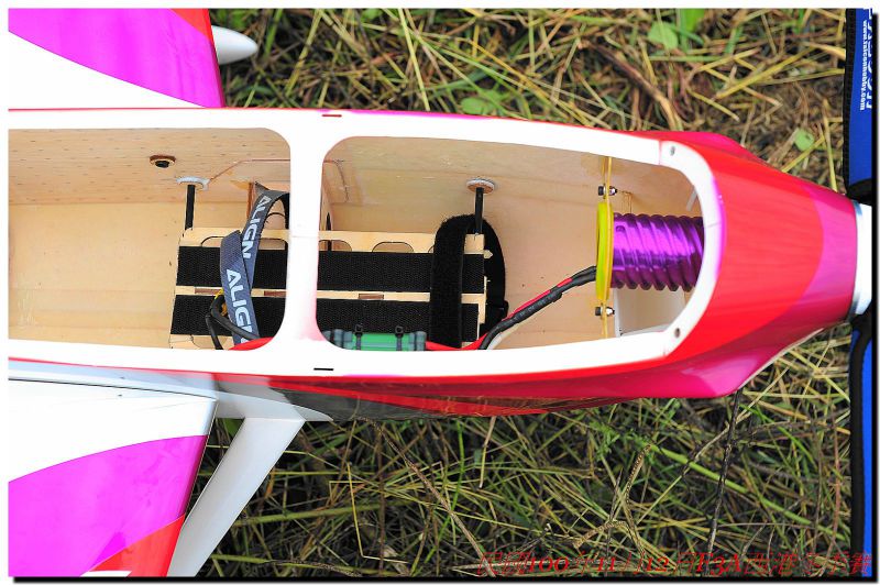

Chris:
Borrow some Nuance pics from RCTW.net in Taiwan for you. Pics were taken by Joseph Zhou during Taiwan Winter F3A contest last weekend. The last two pics are Z.C.Lin and his Toxiris.
Luke

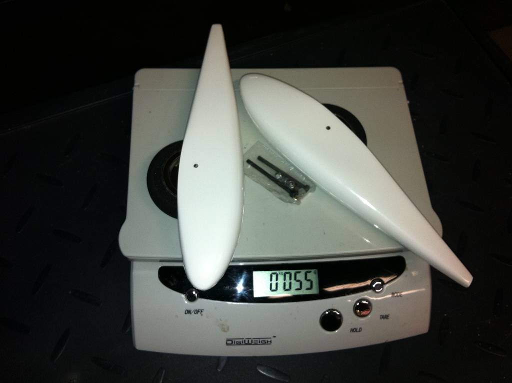

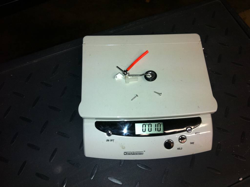

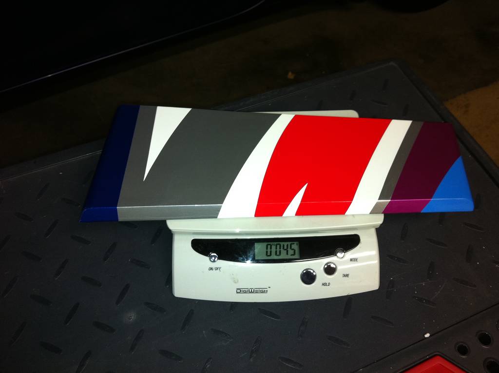

Here are the weights of my Nuance and a few pics I shot while weighing things. I'm almost ready to get started, just waiting for the brown truck to bring me some misc. items I need.
Rudder 45g
wheel pants, wheels & axles 50g
tailwheel 10g
Left and Right landing gear and mounts 135
Horns and Linkages pack 60g
R Wing 330
L Wing 330

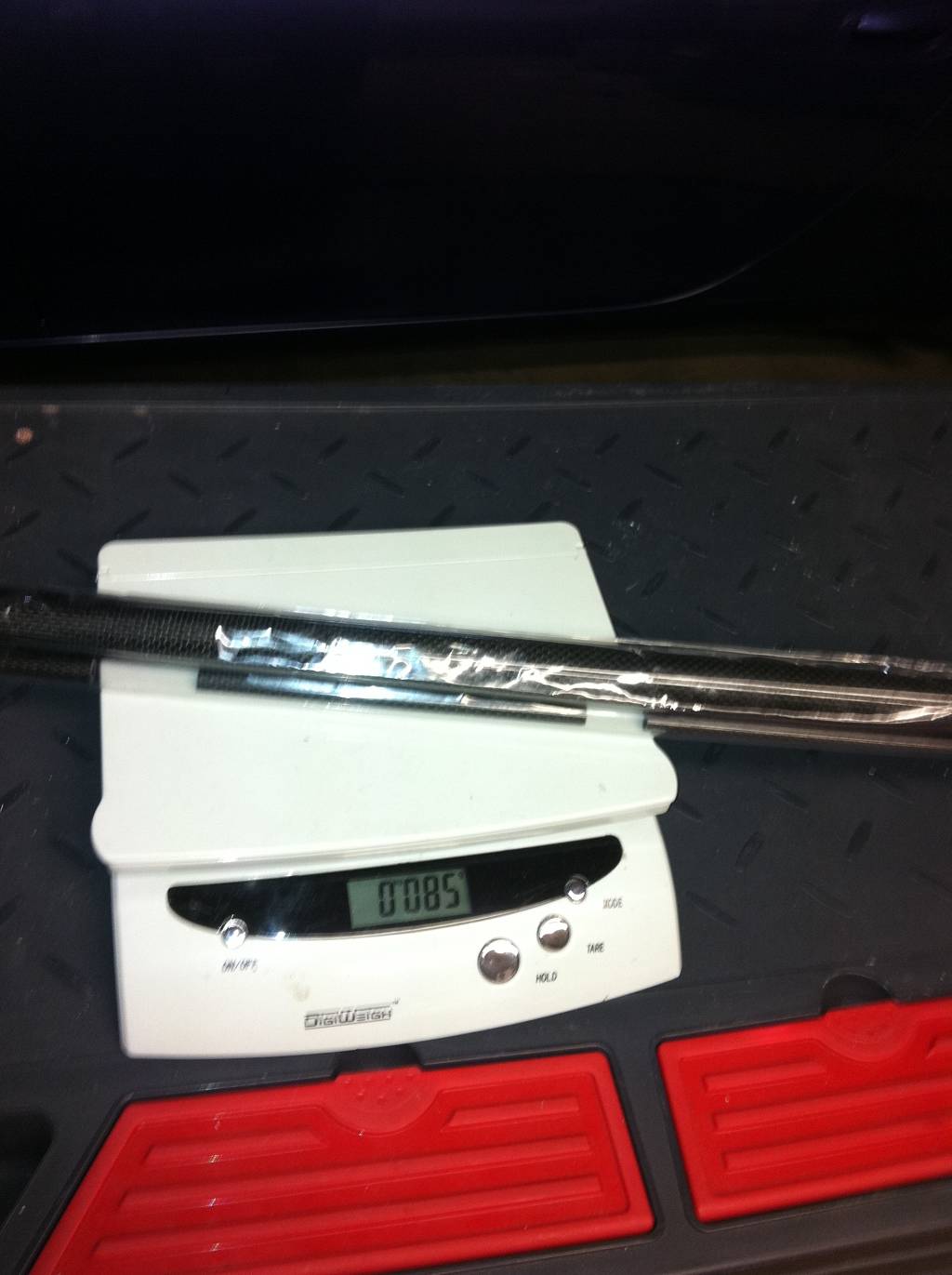

Wing tube, stab tube, anti rotation pins 85g (wing tube 65g)
L Stab 70
R Stab 70
Fuse + canopy hatch 1080
That totals 2265. Not bad.

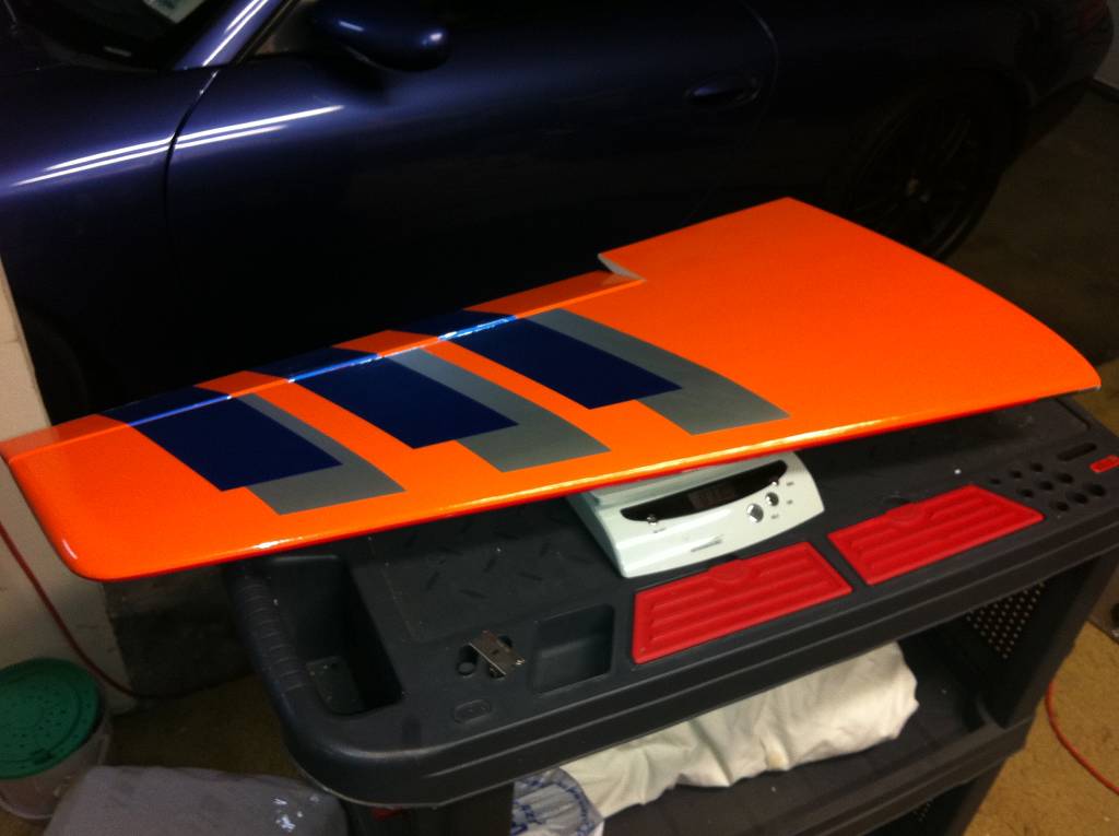

Wing and some internal pics. Nice workmanship. Nice and straight as well. No warp at all on the ailerons.

wing tube looks very pretty, which is probably why it weighs a bit more than it should

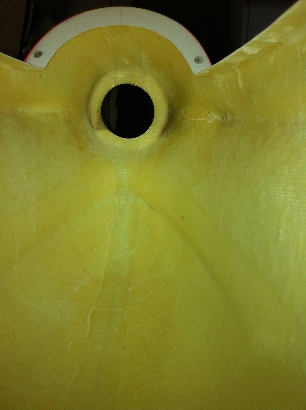

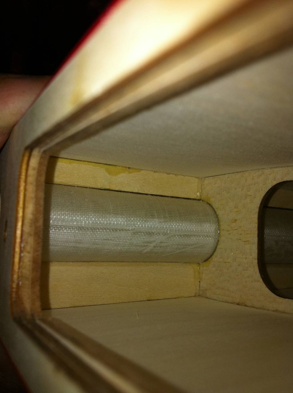

The fuselage is very stiff and light. The key is the balsa side panels used. Notice the lightening holes which have been milled into the balsa sides. This allows thicker balsa to be used and it is also light.

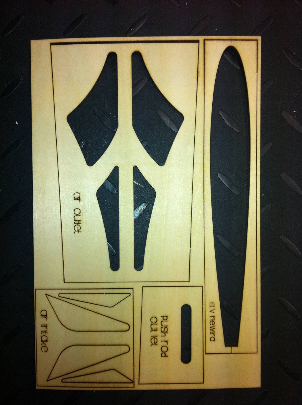

I also included a picture of the templates they included. Its nice to have the air inlet and exhaust templates for sure.

Shannah; I like the Porche in the garage
