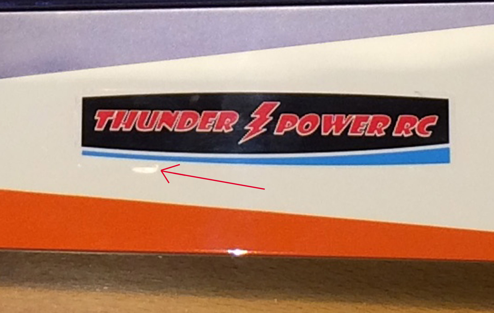

Hi,
It is probably still some "silk and dope" people that read this thread and I'm wondering about this problem:
On my Galactika I have some dents in the wings (that has been created during assembly and during transportation).
For example I have one deep dent in left aileron I would very much try to get rid of. The dent is about 10 x 5 mm and maybe 1,5 mm deep, see photo below. The skin/paint is still OK on the dent (no crack in paint surface).
I expect more dents in future because the wing/stab/rudder surfaces are rather fragile with the tissue covered balsa under the paint and clear coats.
Is there any "trick" to reverse the dent to get the surface at dent flat again?
I have heard that wet cloth and an iron may work to get the balsa under the dent skin to "swell" up agian.
Can this problem be solved?
thanks,
/Bo

For the balsa to swell, the balsa needs to get wet not just the painted surface.

Hi,
So the question is then how to get moisture/water to penetrate through the skin on the wing?
Place a small wet piece of cloth over the dent and then tape over so no evaporation, and let it be so overnight and hope the moisture will travel trough the skin? The wing has no epoxy on it so it is probably not tight.
Or maybe puncture the skin gently with a thin needle so moisture can penetrate easier down to the balsa (and then wet piece of cloth over night as previously described)?
/Bo

I think the paint would be water proof. It would need a hole for the water to get in.

You can fill the nicks oe dents with clear cote, sand from 600 tp 3000 grit then buff.
Tha's what I do.

Why don't you just put a sticker on it.....

With that particular dent I posted a photo on in post #34 above It happened when I put the ThunderPower sticker on there.
There was an airbubble and I was trying to press that out gently at the edge with a soft Topz cutton swab.
The Surface on Galactika wings and stabs are rather soft, it is very easy to get dents.
And I was thinking for future also as I get more dents - I do not want to have a more and more decal covered plane as times goes
I can not remember I have had any plane before that has such fragile surface as my Galactika wing, stab, rudder.
I have build planes before (free flight, control-line and RC) that was covered with Japaneese tissue (probably Galacticka is also covered with similar material under the paint) and it has not been as fragile as my Galactika (what I can remember).
Of course I will be very careful when I handle my Galactika to try to avoid dents but there will always be "hangar rash" and on this plane easier then I'm used to. Oracover/Ultracote plastic film covered wings etc is more durable and smaller dents is usually just to take the iron and tighten the film over the dent and it is in most cases then invisible.
/Bo

Drop filling is the best method to repair them. As mentioned, you can use clear coat to fill in the dent and then level and buff it back. The big thing in instrument repair is to use CA that is formulated for this purpose that stays clear even with kicker. Here is a link to an excellent product and videos showing how it's done.
http://gearupproducts.com/fillnfinish.html
