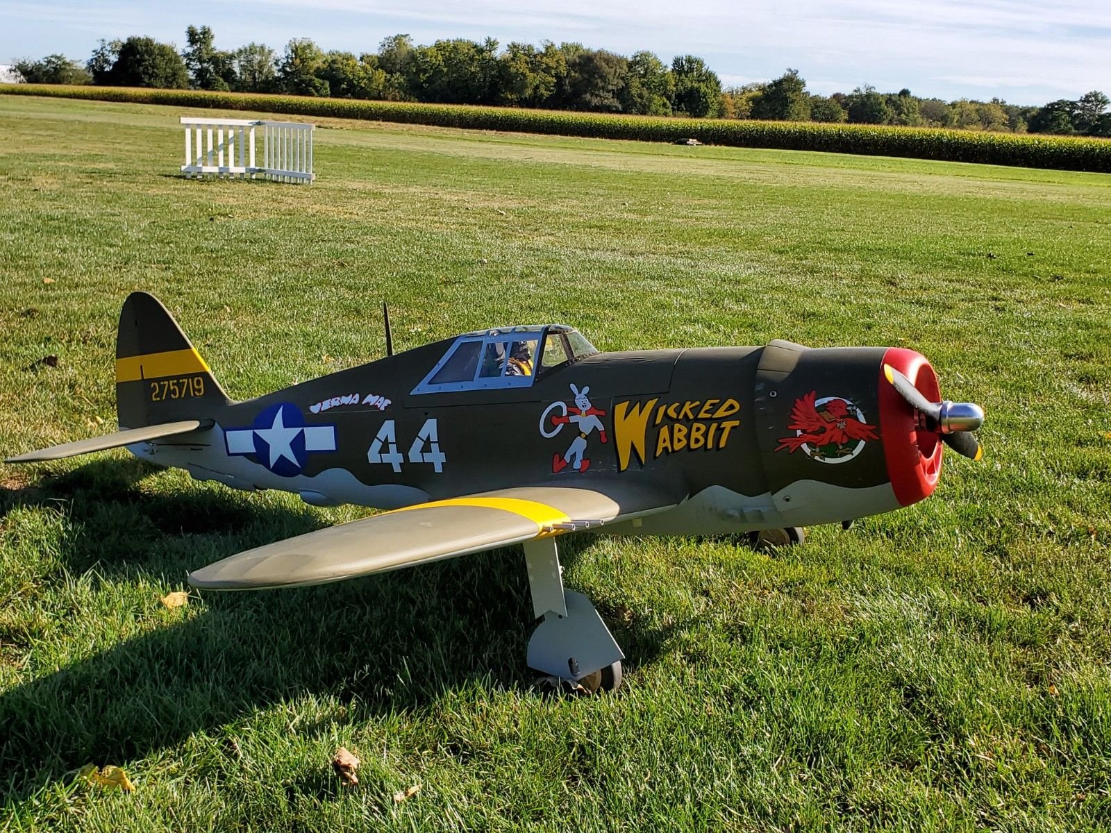

Maidened the Seagull P-47 today, Flys great, So I ran 1 gallon of 15-1 redline on the stand then 2 tanks of 20-1 on the stand, Started it up for the maiden, let it warm up, I was getting 5850- 5900 with a 22X10 zoar ww2 prop, when I landed it was at 6000- 6010 Does that sound good for now until it rally breaks in? I have the MMM timming ring set at 30 degrees and the Meier Exhaust ring.

Congrats on the successful maiden! Good looking P 47 which I wasn't aware that Seagull offered, I'll have to check that out. I'd say 6000 rpm on a 22 X 10 sounds about right and I doubt you'd have to use all that to fly that P47 in a realistic manner.

Nalby the RPM and prop are in the zone. I have the 23x10 Xoar WW2 prop and last check was 6100 RPM and the prop tips are going supersonic on the high speed flybys.

Thanks Guys, So far I really like this motor , performs well and sounds fantastic, can't wait to get out to the field again
